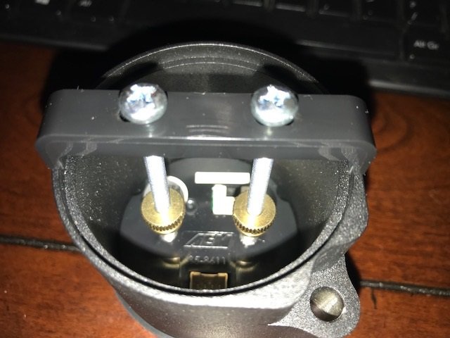

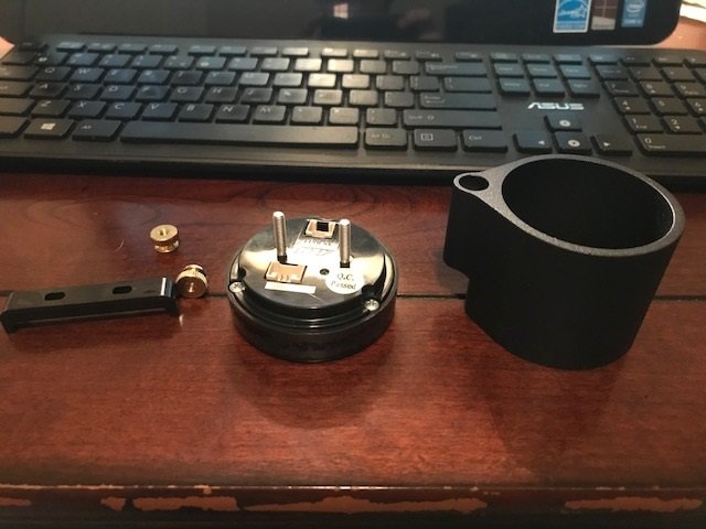

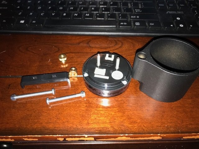

    With the new AEM gauges, they are much thinner than previous version. This poses a problem for many gauge pods. My fix was finding a longer screw, same size (M4 x .70) and linking them with the original, long nut.
    Still gives you a clean look without modifying the original hardware.

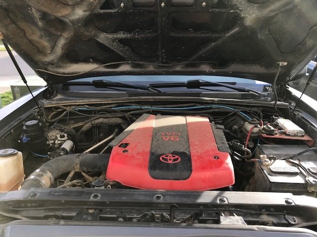

    cleaned the engine bay for whats to come. . .
