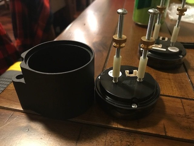

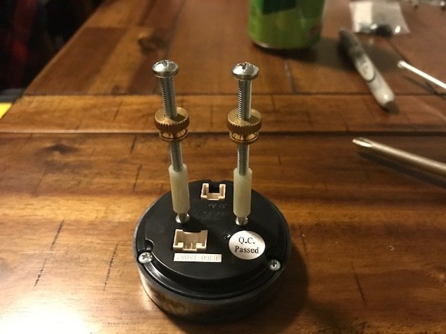

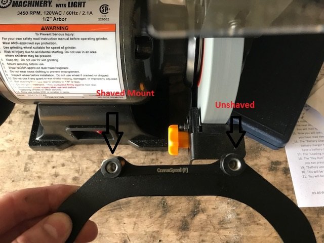

    modified the gauge mounting set up to fit the flexpod. The new AEM gauges are really clean and nice looking...but too thin to fit in the cravenspeed flexpod. So I had to make some minor adjustments.
    Gotta wire them up tomorrow and hopefully all will be well.

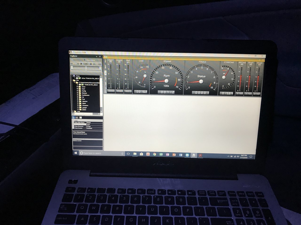

    Never thought I’d see the day where I’m having to tune the truck with a laptop. Working with someone way more intelligent than me when it comes to tuning and programming to get this S/C and UCON all dialed in.

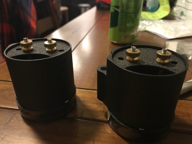

    Tried setting the boost gauge up with teflon tape this time which AEM recommended. Still reading 0.0 so I think I have a bad sensor. I included the AFR as proof that the wiring and everything works. Hoping to get a new pressure sensor part from them and call it good. we'll see.

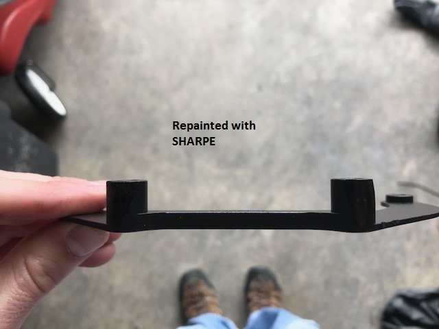

    Modified the craven speed gauge mount to fit these x-series gauges

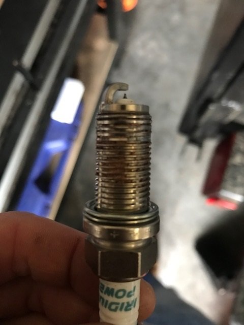

    And here is the bad spark plug that I got in the box from magnuson which caused me a delay in getting another one for everything to work. Gotta contact them about it still...

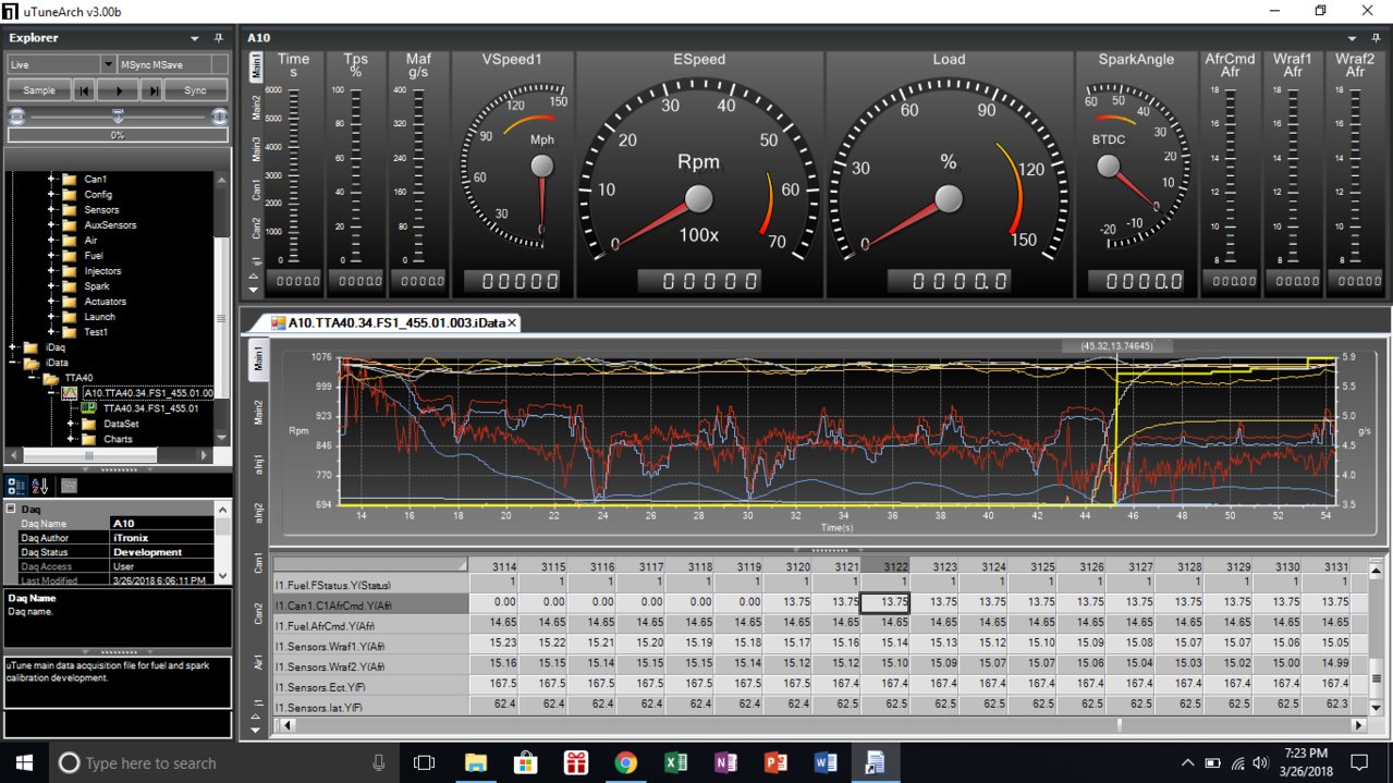

    Current dilemma: The spike highlighted is exactly when the "Pending P0158 code" kicked on the UltraGauge. I sent this file, a normal drive file and an acceleration file to the tuner to see if we can start diving into this pending code that keeps populating. This happened while driving at interstate speeds (65-75 mph) and for a little bit afterwards. Now that I have driven around town and stayed below 55 mph, I have not had the code come back today...
