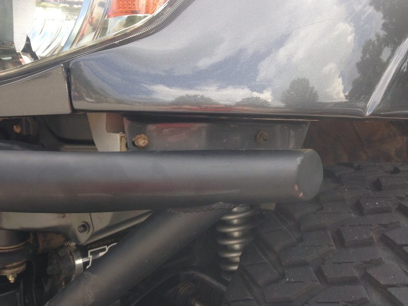

    To show the lift, before hand the glass fender gingerly touched the bumper. now it does not.

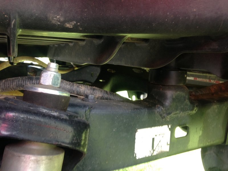

    prepping for the cab mount relocation
    mock up
