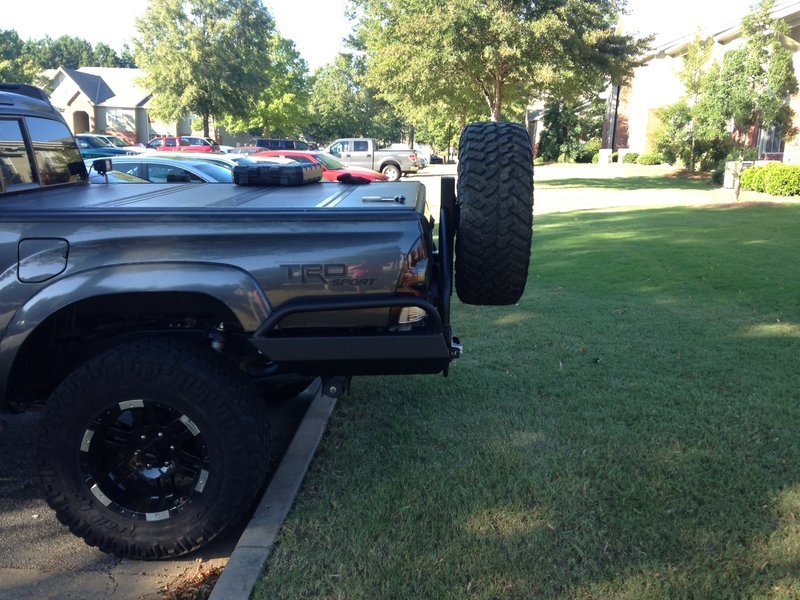

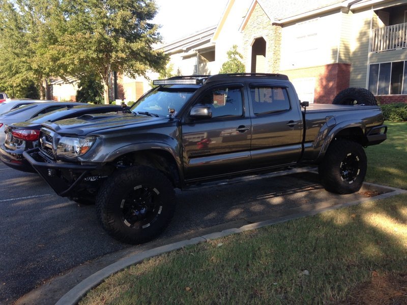

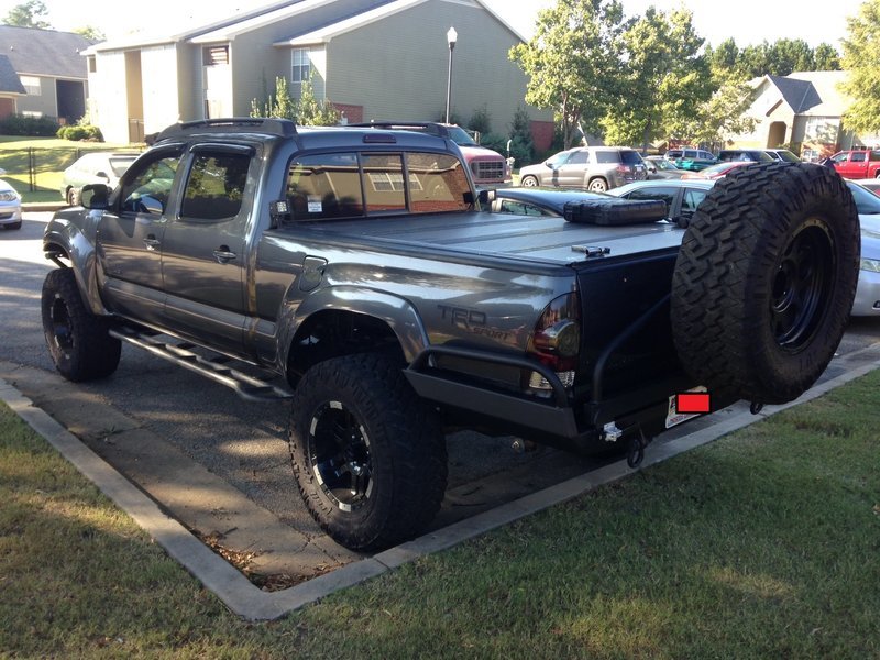

    updated pics just with the tire carrier installed and set.

    Very nice truck, Jeremy! Very nice!

    Thanks Chris! This has been taking up my time the past 4 days haha I was trying very hard to make a deadline for a guy who was buying my old bumper as he was passing through town. It all worked out thankfully!

    Dude, looks amazing! I'm a little jelly...

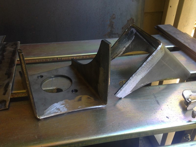

    workin on finishin a CB mount for the rear

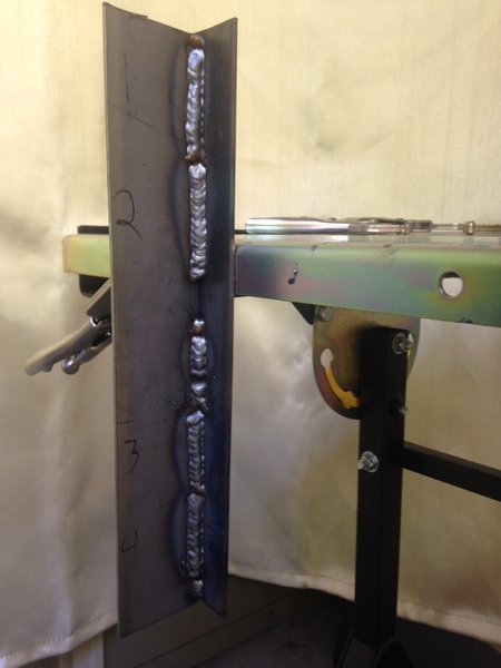

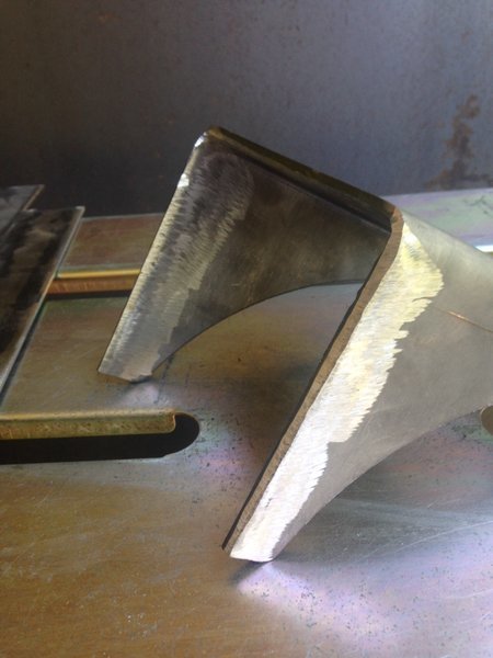

    and plannin on doing the cab mount relocation this weekend. cleaned up the edges and beveled them to make for a better joint (thanks @Robertocritser for the idea)

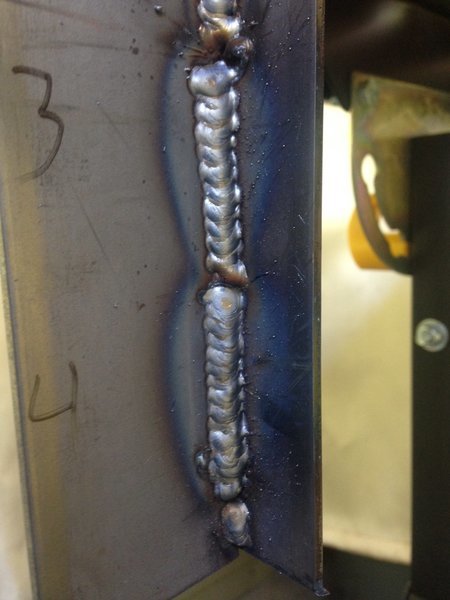

    and practicin the vertical welds for the job

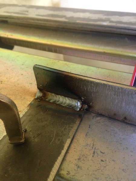

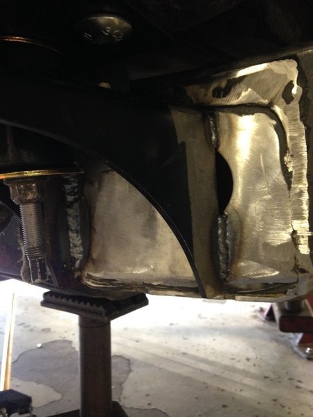

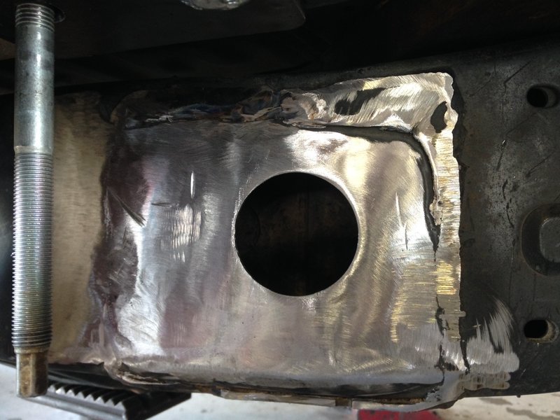

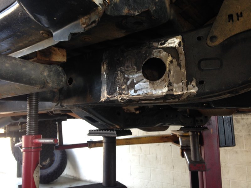

    Got the passenger side done today. ended up starting an hour and a half late and this took way more time than I thought (but I also was doing it solo and had a lot of inside cab/outside cab back and forth going on. I know it will be WAY worth it once complete, but this is one project I cannot wait to be over.
    Ground down
    flap disc'd and ready for welding
    welded. I was able to weld the inside and outside of the vertical sides and the inside of the top. I have no doubt its not going anywhere

    Why do you have to go from inside to underneath so much? Is it just to get things lined up? Would a second set of hands help?
  16. Oct 15, 2016 at 7:11 AM
    #176
    11TRDTX
    11TRDTX bruh
    Mar 15, 2012
    #74980
    7,827
    Memphis, TN
    2011 TRD TX 4x4 MGM DCSB
    Lift, 285's, mud, and scratches
    :gossip: every so often, depending on what you're doing, working on a car or truck might be a pain in the ass
    :D
    Skootter14[OP] likes this.
  17. Oct 15, 2016 at 7:12 AM
    #177
    Skootter14
    Skootter14 [OP] Upon my signal, unleash Hell
    Jan 1, 2011
    #48576
    4,655
    Jeremy
    '11 TRD Sport 4D LB 4x4 Metallic Grey
    "a lot of stupid stuff" -Wife
    thats exactly it. trying to eye the pilot hole and going into the cab to drill the 1 1/2" hole then back underneath to make the 1/2" bolt hole then back inside and spanning your arms under the door so you can hold the bolt with 1 hand and nut with the other and get the threads started, doing that for both bolts is just a pain. theres quite a bit of checking and rechecking for alignment. I dont even think my bolt is perfectly straight (the pic is a little crooked so it makes it worse haha) but since I installed the new body bushings that actually give more than the stock, im not worried about it.
