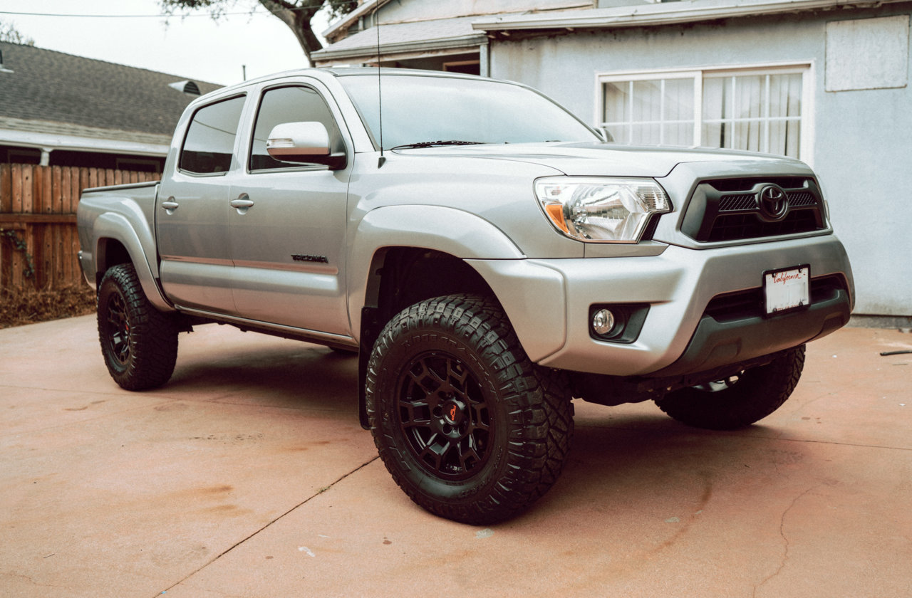

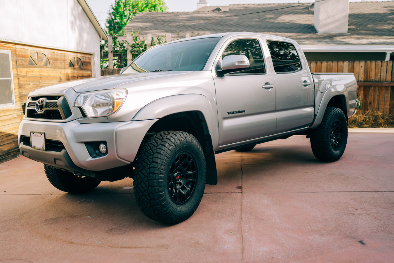

    I was considering buying a new Tacoma but when I saw the current insane prices I decided against it. (71K for a TRD pro at local dealer. Pass the crack pipe) I spent a lot of time researching all this stuff so I figured I'd save some other poor soul a shit load of time. Disclaimer this is for a 2014 Pre-runner SR5. Everything worked flawlessly for me. Indicators in side mirrors pre-wired and were plug and play. So I can tell you if you have a 2014-15 prerunner sr5 side mirrors turn signal work with no wiring required. You simply unbolt old mirrors and plug in new mirrors and snap the color matched covers on.
    There was alot of scare posts about 285s rubbing and CMC needed etc and not to do it. Well I can tell you with the wheels I chose and tires I have zero rubbing if you have a 2014 prerunner sr5 you will not either. The only thing I had to do was take off the little tiny flaps in the very front. I had Bilstein 5100s @ 2.5" installed. Used stock coils and UCAs. no issues with alignment and was within spec. The ride is the same or better than what it was before more much to do about nothing from various posts I've read on here. If you want to do this for a different color just take the part number names which was the hard part to find and match paint id

    Tires and Wheels
    Nitto Ridge Grapplers 285/17/70
    AGP TRD Pro 2021 (new Style) replica wheels. These are 8" so better than the 7" OEM ones for 285s https://agpwheels.com/products/agp-off-road-wheel-17x8-matte-black
    $ 600 for wheels via offerup.

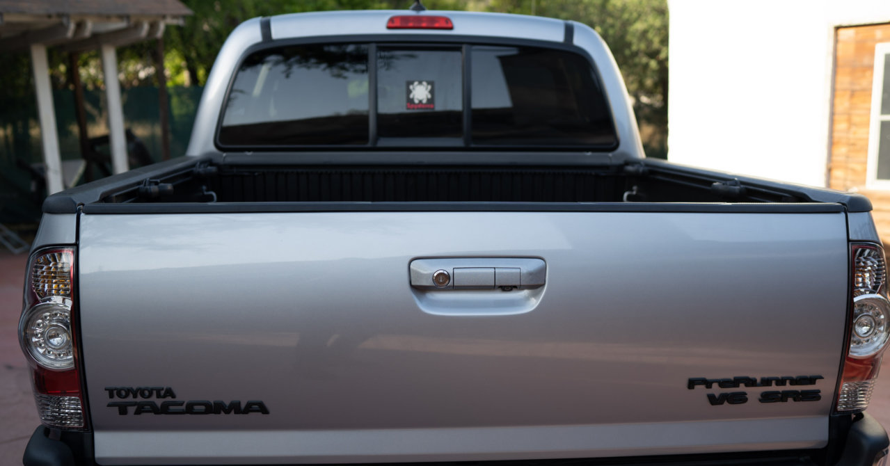

    Pop N Lock color matched tailgate handle
    https://www.amazon.com/gp/product/B00S2FOQ5U/ref=ppx_yo_dt_b_asin_title_o06_s00?ie=UTF8

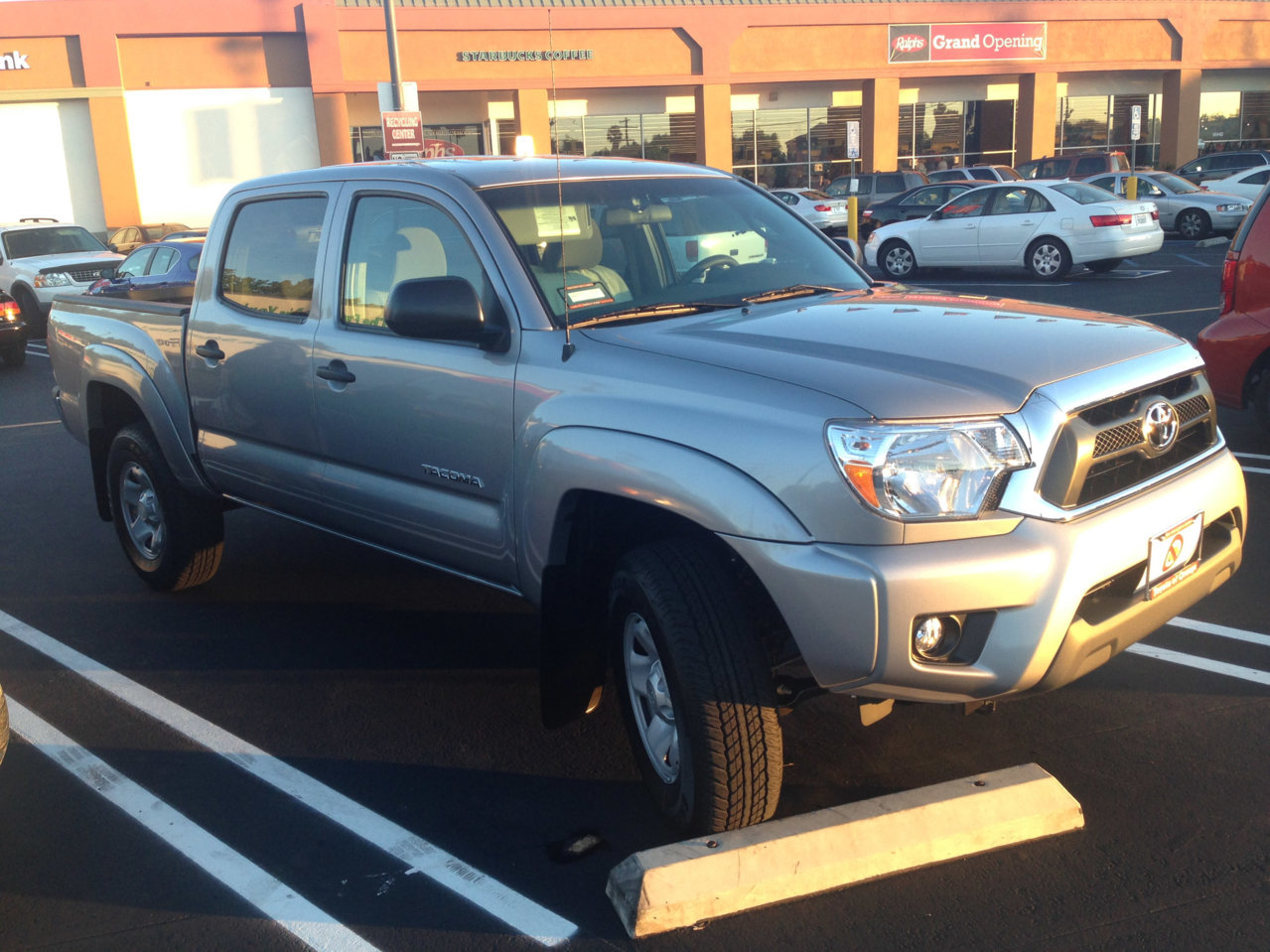

    Before:

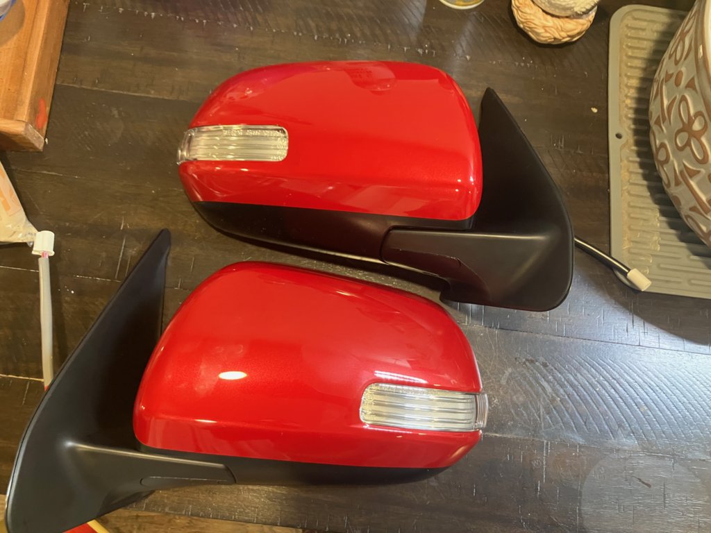

    Where did you find the mirror covers? All I can find is covers without paint (P/N 87915-04900 & 87945-04900). Thanks
  14. Nov 25, 2024 at 4:19 PM
    Taco Husker
    Taco Husker Member
    Feb 8, 2021
    #355498
    10
    West Chester Ohio
    2014 TRD Sport DCSB Barcelona Red
    I couldn’t find pre-painted color matched mirror covers. I had oem unpainted ones painted Barcelona red by a body shop.
  15. Jan 17, 2025 at 7:08 AM
    kimosabe15
    kimosabe15 Well-Known Member
    Jul 16, 2021
    #371432
    70
    2015 DCSB SR5
    87945-28060-D1 and 87915-28060-D1 are the Barcelona Red (3R3) covers for the for 87940-04211 and 87910-04192 mirrors
