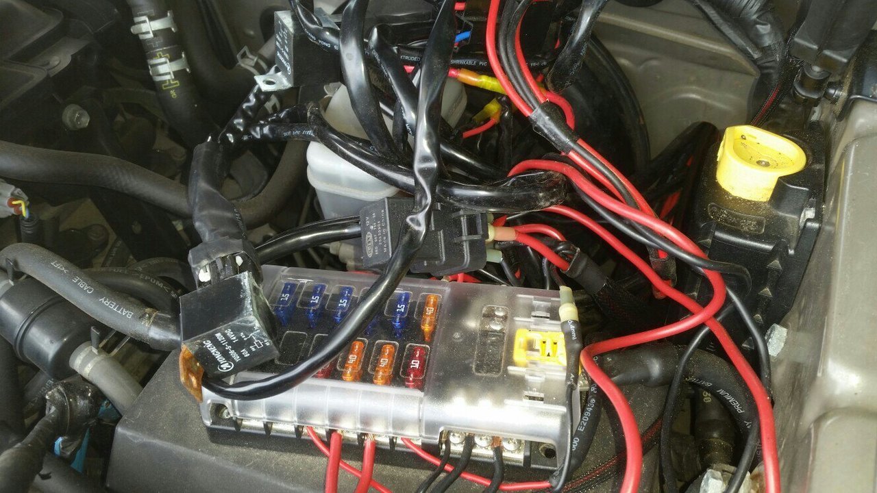

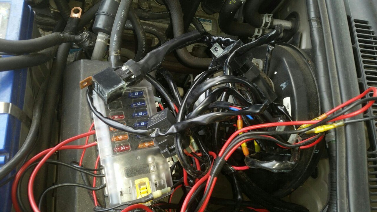

    More done

    I've got no fucking idea what you are doing here lol

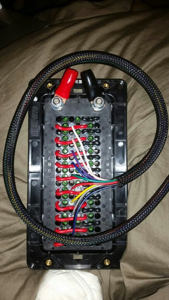

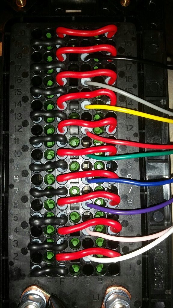

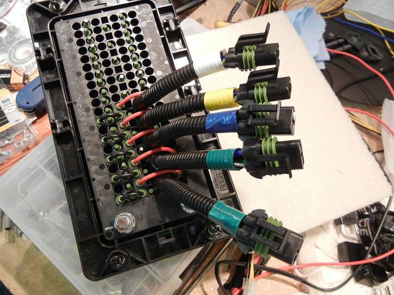

    So basically I am reducing all of this mess into 1 box. Similar to an SPOD or an oem fuse box. Ever have a bread board project? Kind of like that. You put the components in where you want them and then Wire from the rear.

    I see too many people having huge relay arrays in the trucks. This solves that issue. And prevents corrosion

    I like the idea of wiring plugs on everything beforehand... May have to do that.

    yep. He did an awesome job. I want to get a bulkhead connector or multipin. That way I can disconnect and have the whole thing in cab

    Instead of the split loom, doing braided too
