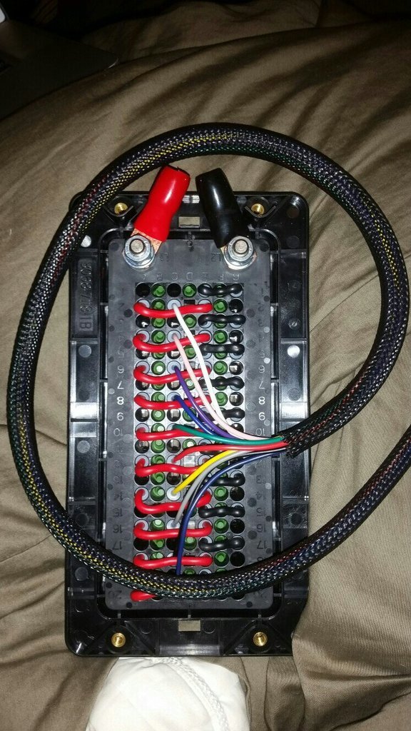

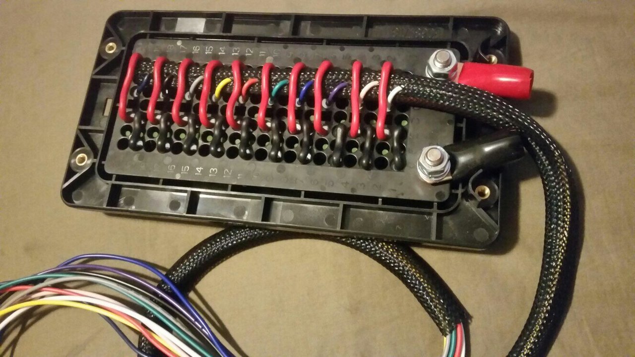

    I went from this on the wiring,
    To this so far

    Thanks. Finishing the mapping of my switches and future components. Planned that is.
    So far I'm here.
    40" bar - relay - 20 amp fuse - spst switch
    20" bar - relay - 10 amp fuse - spst switch
    6" bar x2 - relay - 5 amp fuse - spdt switch
    OBA Compressor 1 - relay - 25 amp fuse\
    -------------------------------------------------------------------> spst switch
    OBA Compressor 2 - relay - 25 amp fuse/
    CB - 5 amp fuse - spst switch
    Hood light - 5 amp fuse - prop switched
    Topper lights - 30 amp fuse - prop switch
    Power Inverter - 5 amp fuse - spst switch
    Rock lights - 10 amp fuse - spst switch
    Camera's - 10 amp fuse - spst switch
    Winch controller in cab - 5 amp fuse - spst switch
    OBW pump - relay - 25 amp fuse
    ? OBW pump recirculation ? - relay - 25 amp fuse?
    28" bar - relay - 15 amp fuse
  10. Jun 28, 2014 at 11:24 PM
    #290
    skygear
    skygear [OP]                    
    Nov 6, 2011
    #66558
    8,414
    Wiring all the constant power together, ground together, and Switch illumination together. For the switches.
    One harness containing all the individual switched leads(18 gauge), power(14 gauge), and ground (14 gauge)

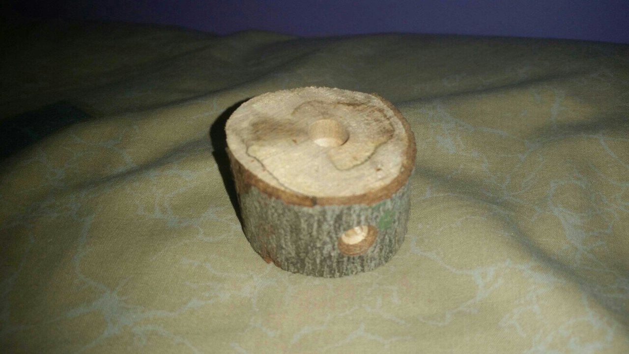

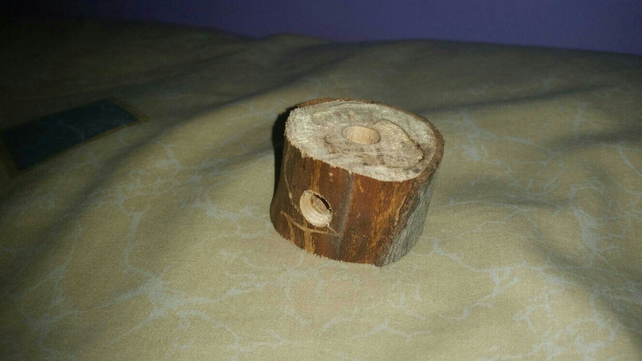

    Striping wire with a sharpie can be a huge pain in the ass. I met a tech who said there was a tool for it. I thought about it and took a block of wood, drilled it to pass the wire through, and a half inch intersecting hole to hold the sharpie centered. Do This! It will make a real pro looking stripe and keep your fingers clean.

    Already made my block :spy: - made it the other day when I made one for cutting the fenders. Jig saws are awesome. Made short work of the project.
    I have a bunch of the short sharpies. That way I can lock them in the hole and shoot the block down the line without it falling out. Am able to let the line dry before handling it that way.

    abysa8u6_7cfbf61394898929008b95cde71198b752517110.jpgu4e9ubu4_dc49c87e05771d74c5c848315126a0fc2f65ead3.jpg
    Dual mode. Can do 2 markers/ stripes at the same time if I want
