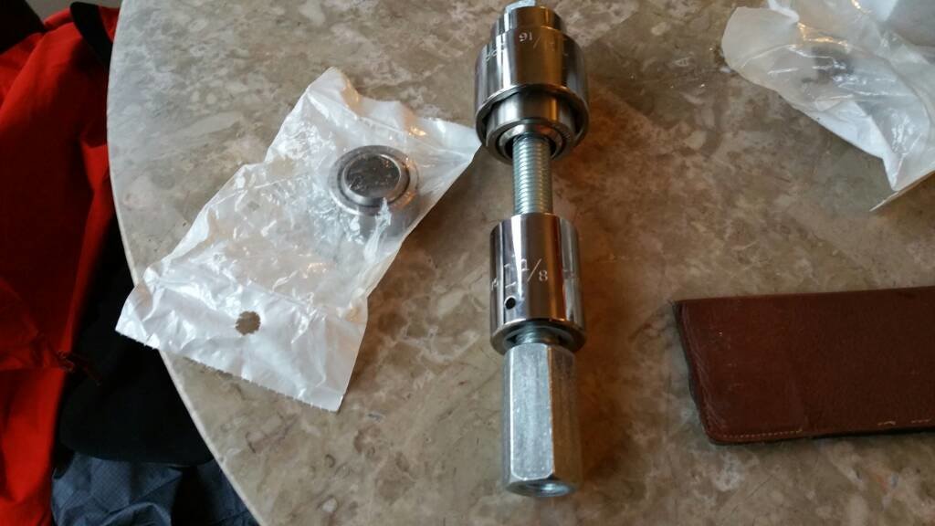

    Helps with focus on these hyperspots

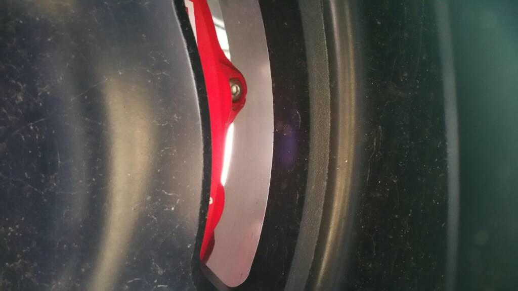

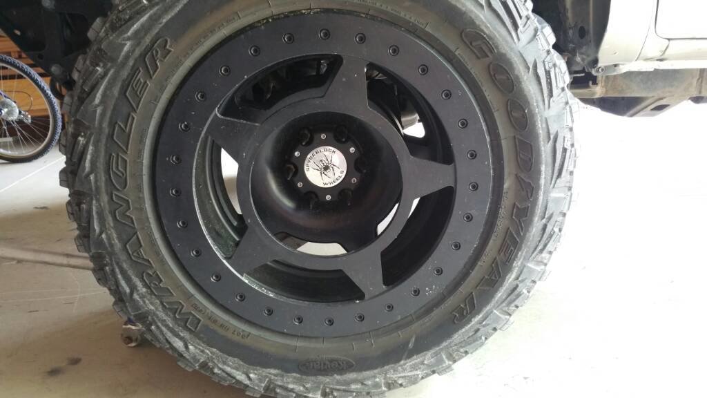

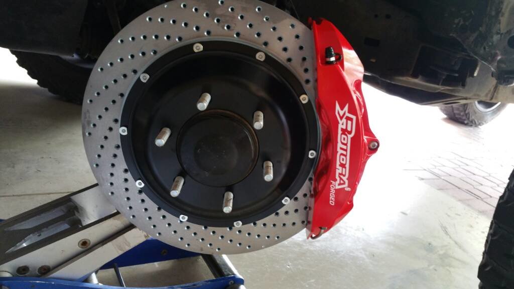

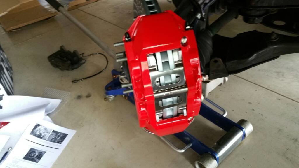

    Yeah, they are on and running great. My pedal is back up and touchy. 380x35mm w/ 6 pistons is no joke. Still going to press them for a 405 kit ;)
    If it was 405, the caliper would be right in the openings of the wheel and fully legible.
    Yes, indeed. I have work to do before any playing.

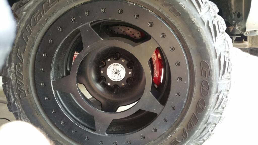

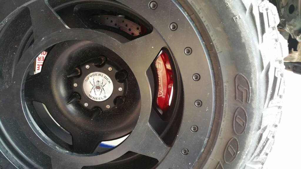

    Wow...those look beefy and really nice!
  9. Apr 10, 2015 at 9:41 AM
    #589
    skygear
    skygear [OP]                    
    Nov 6, 2011
    #66558
    8,414

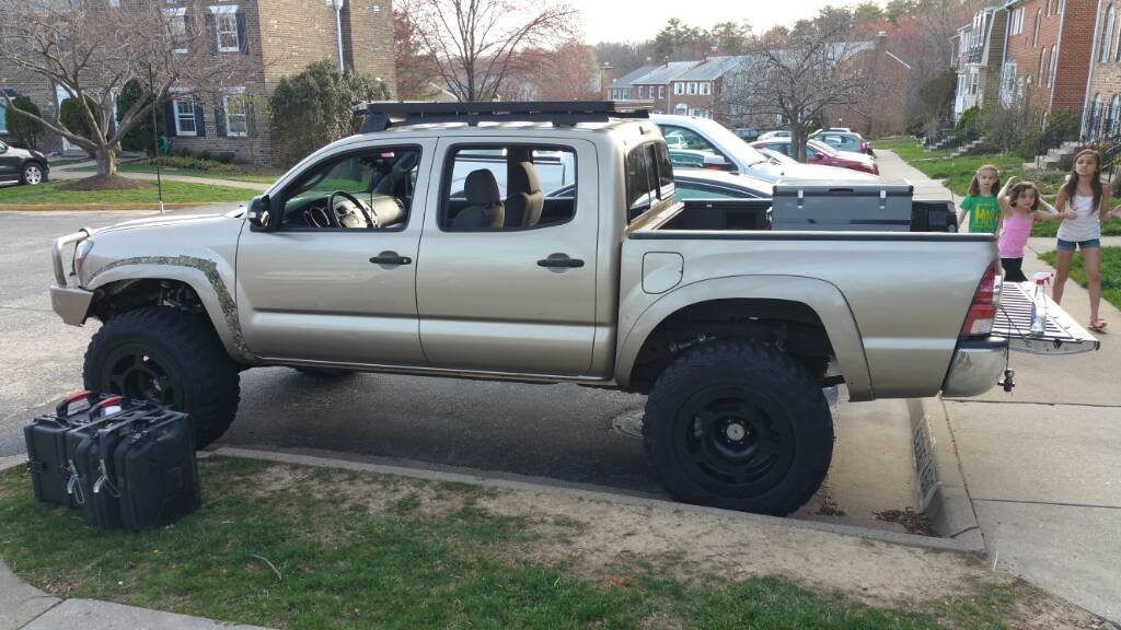

    Just for you ;)

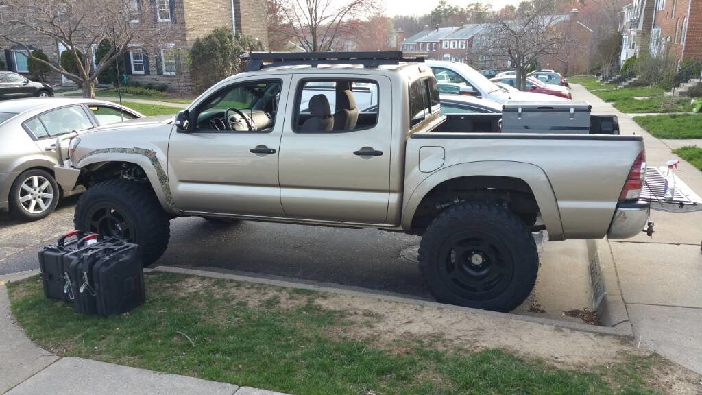

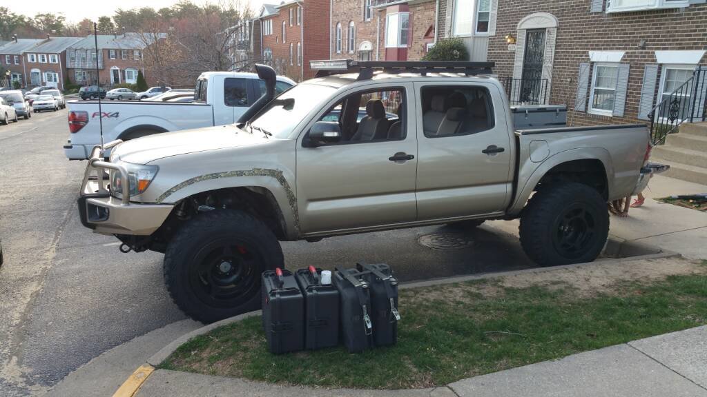

    Did it to re seal the shell. I was able to take it on and off myself in the past using the 'turtle' method. Get in the middle, brace the shell with your back and lift and walk with your legs. The addition of the rack and lights makes it a 3 adult job now.

    Kids said it looked weird. Asked when we were putting the top back on. So It was off for an hour...

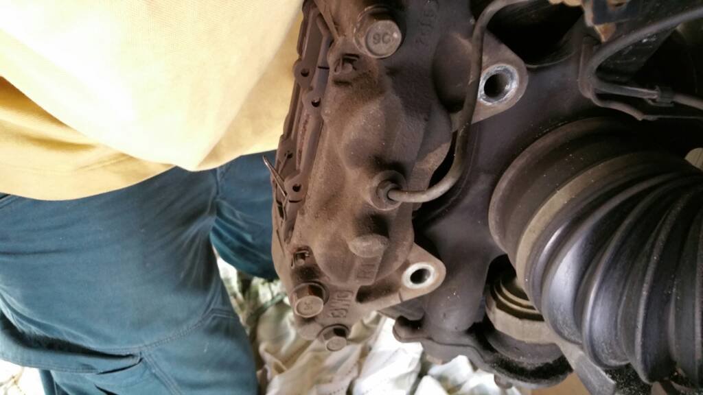

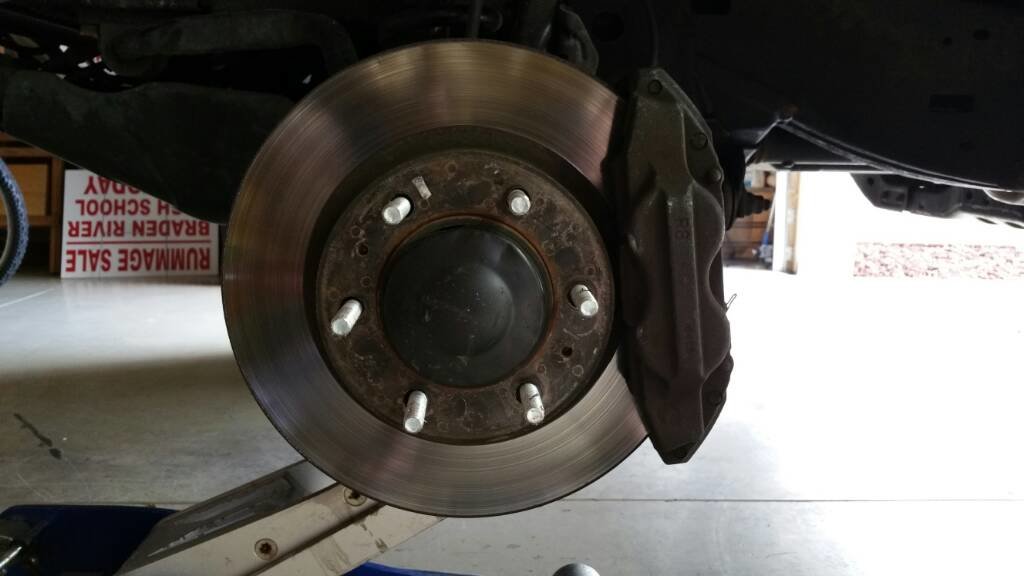

    Took off the factory sway bar finally. It was literally hanging on by a couple bolts. With the rusted frame, 2 bolts broke free from it and every bump was clang clang. No more of the that nonsense.

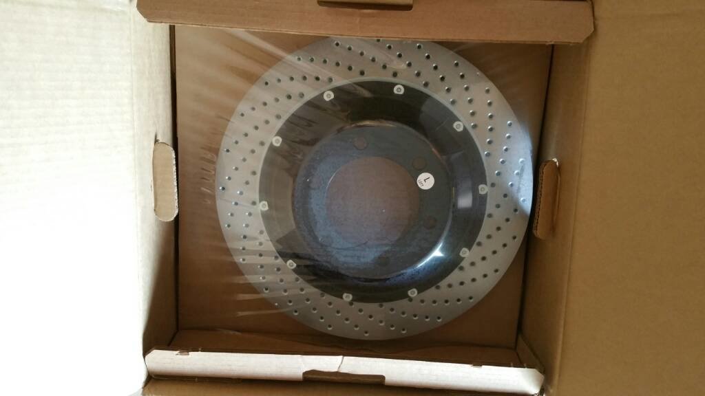

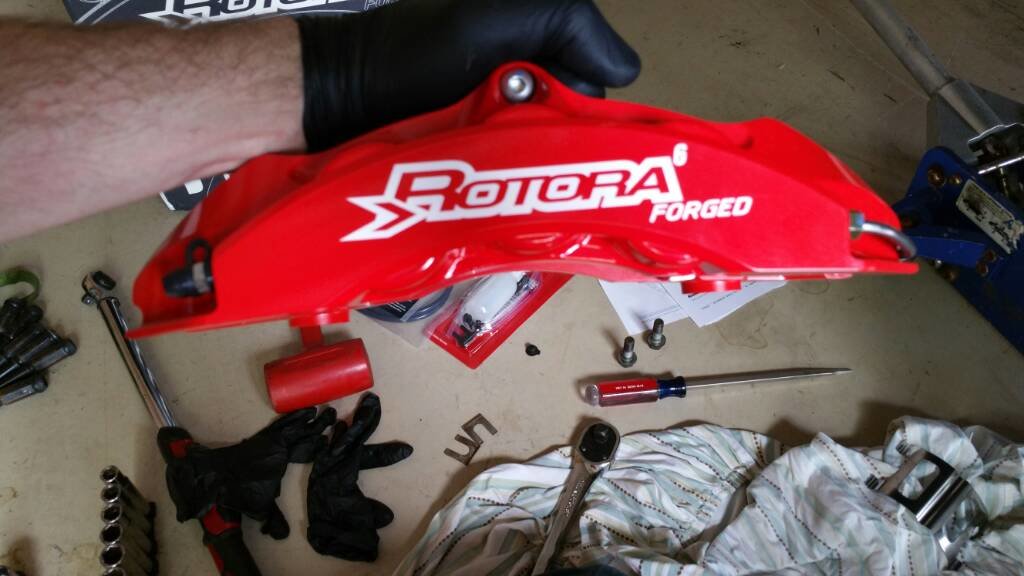

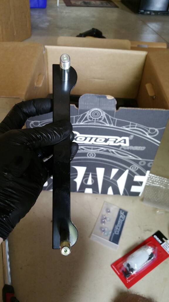

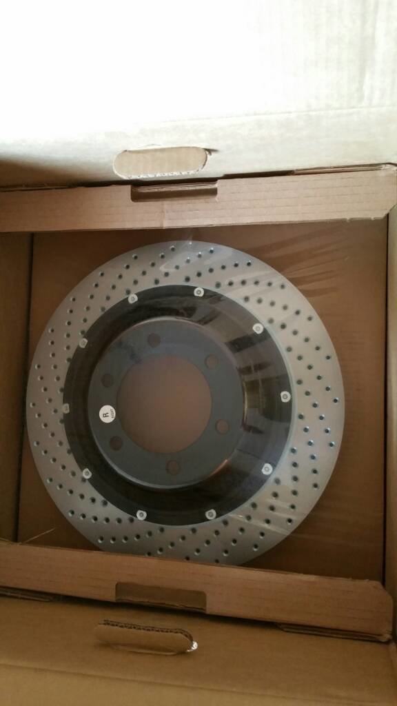

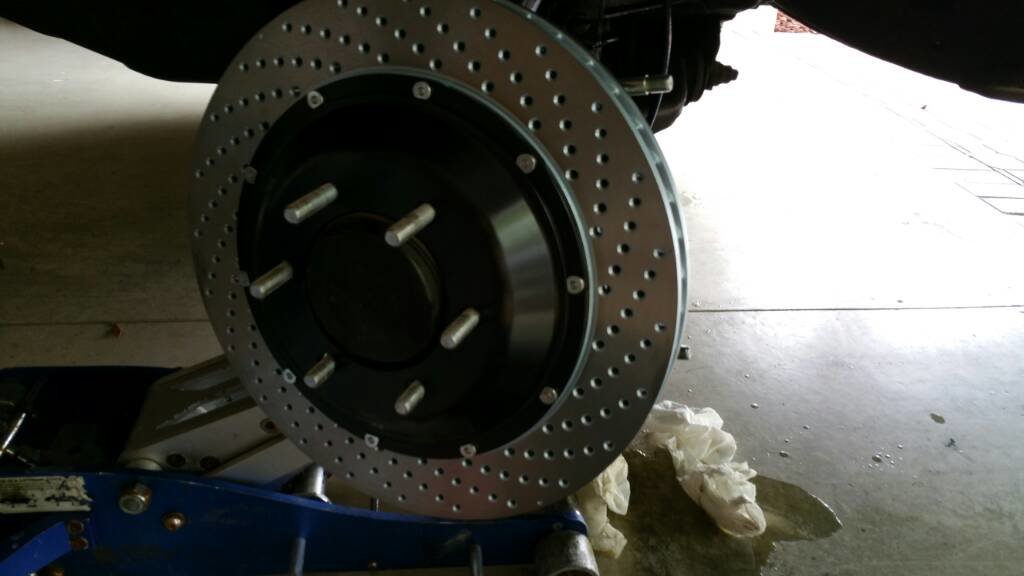

    Unboxing

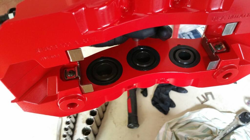

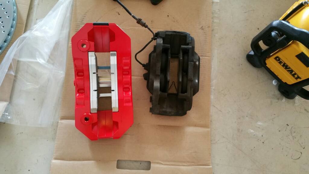

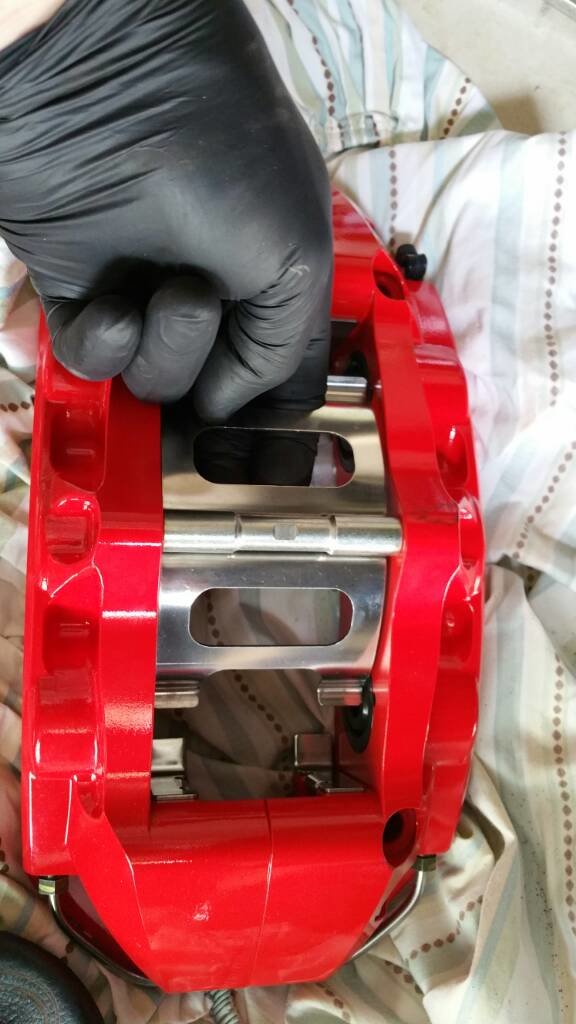

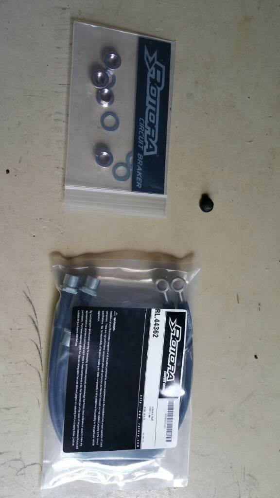

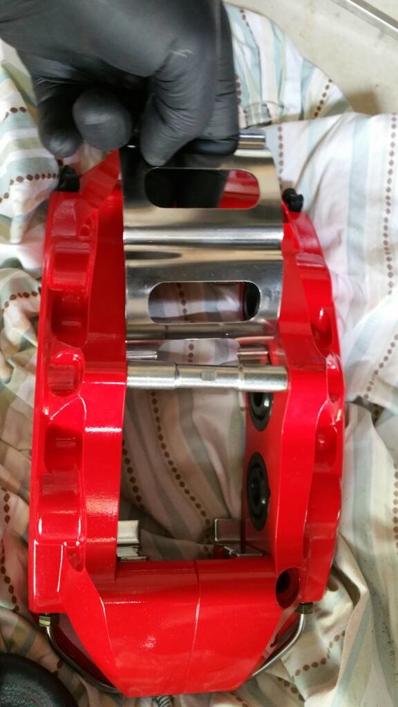

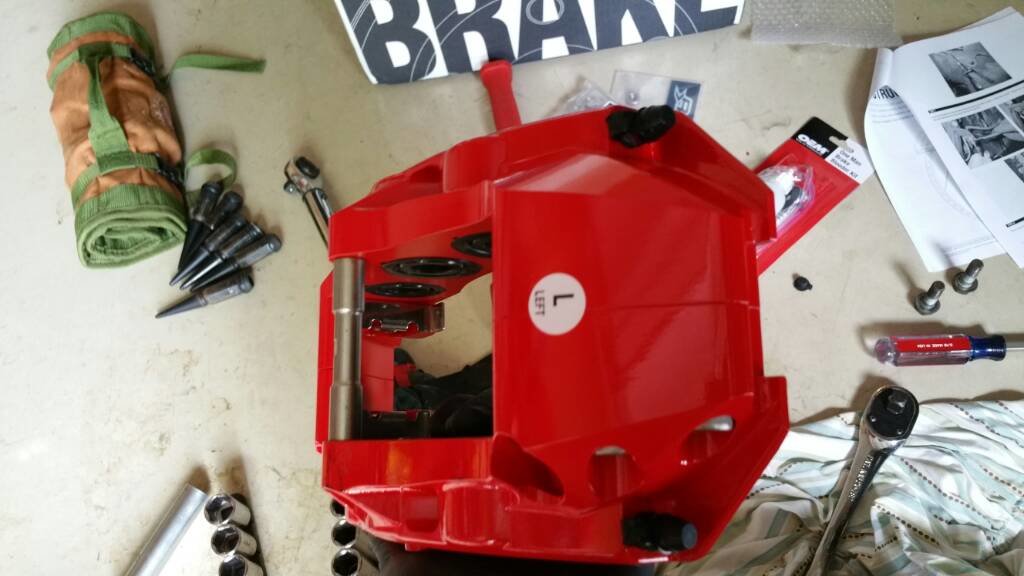

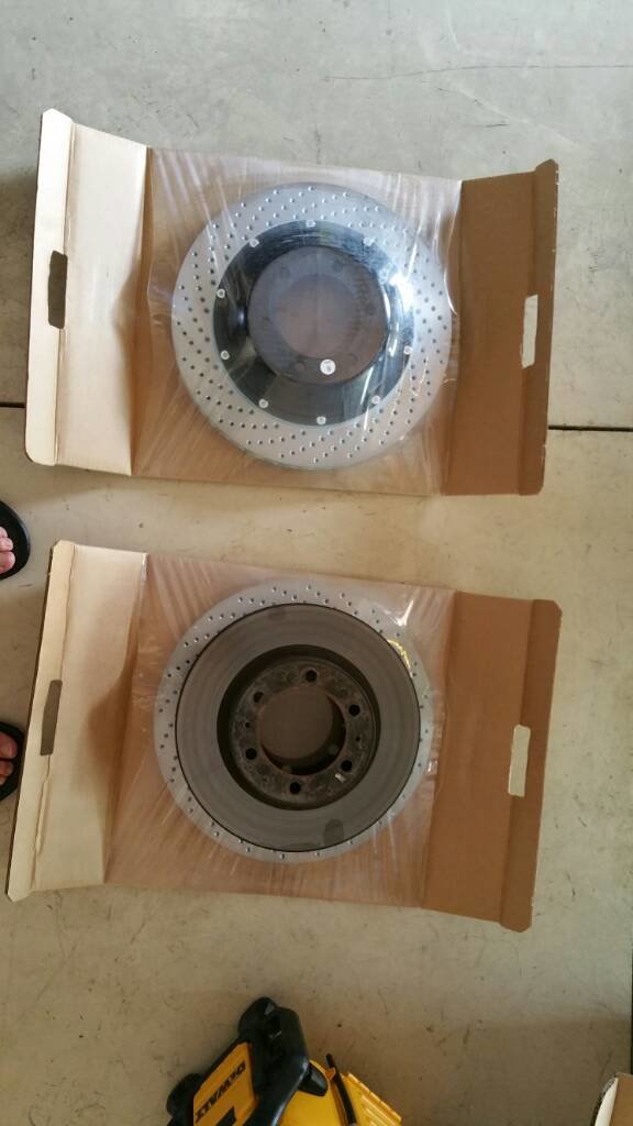

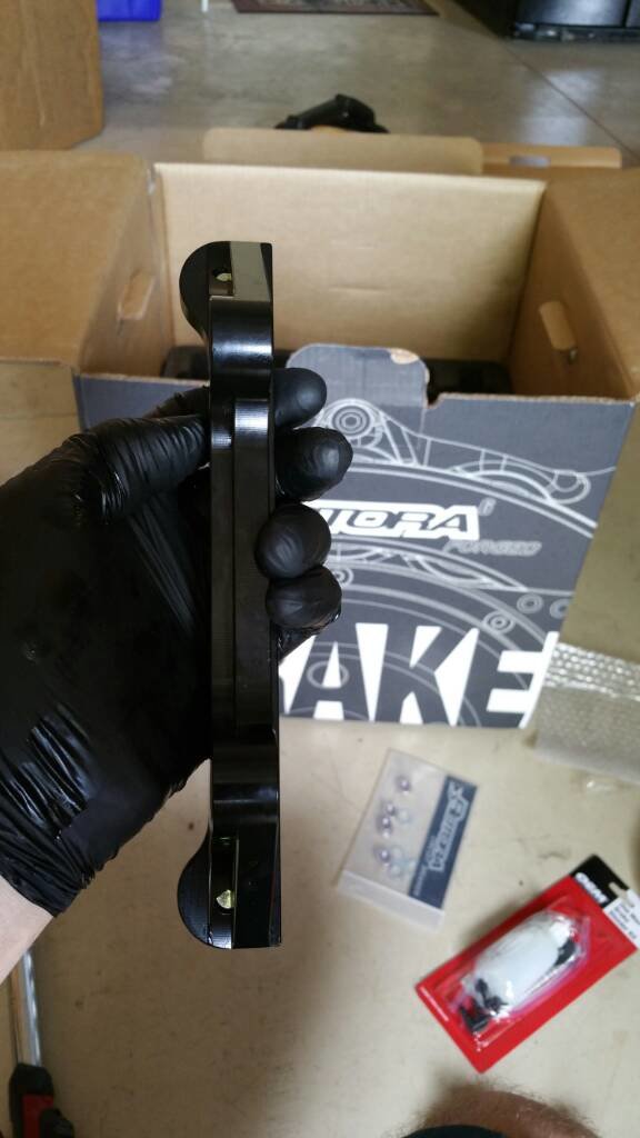

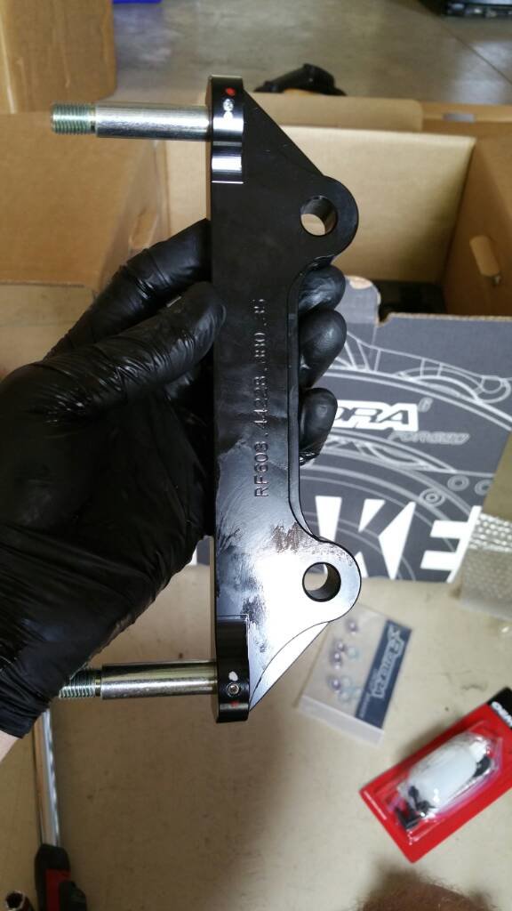

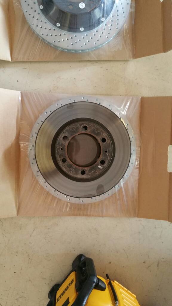

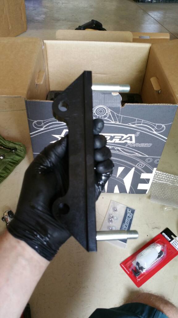

    The pieces in all their glory!

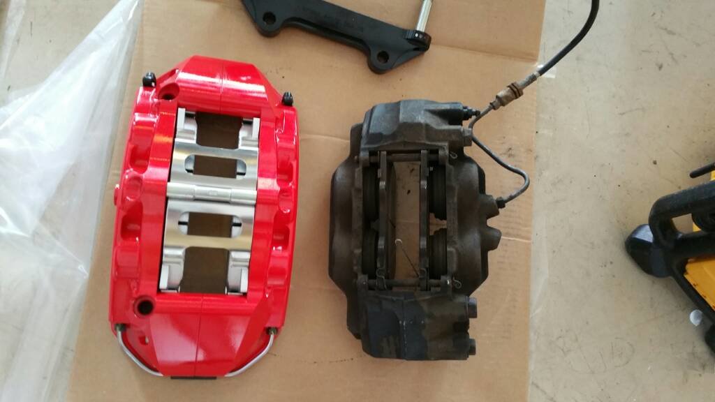

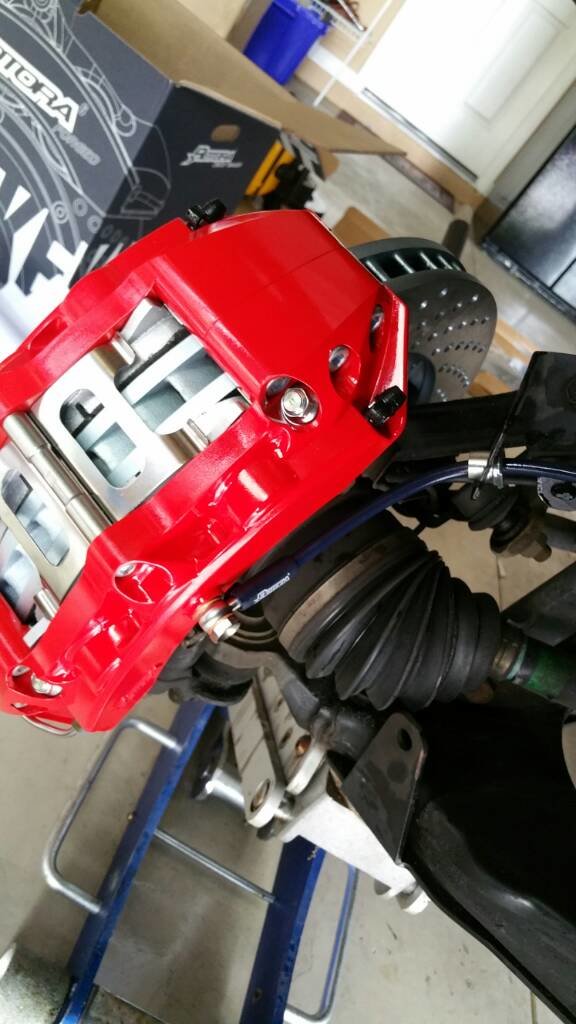

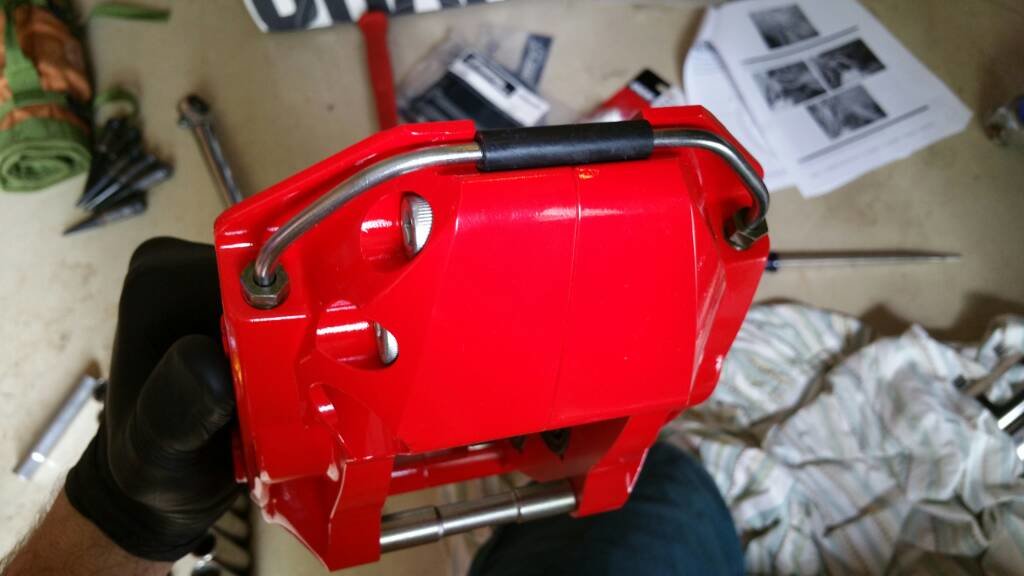

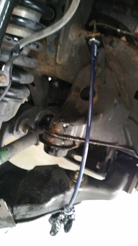

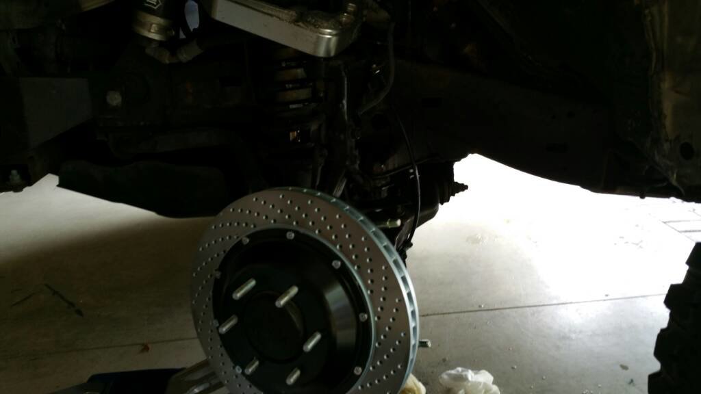

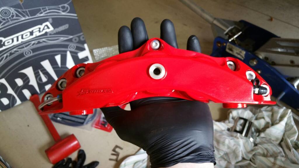

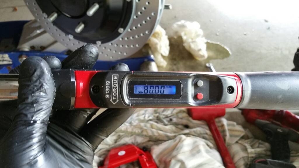

    Install (THE)

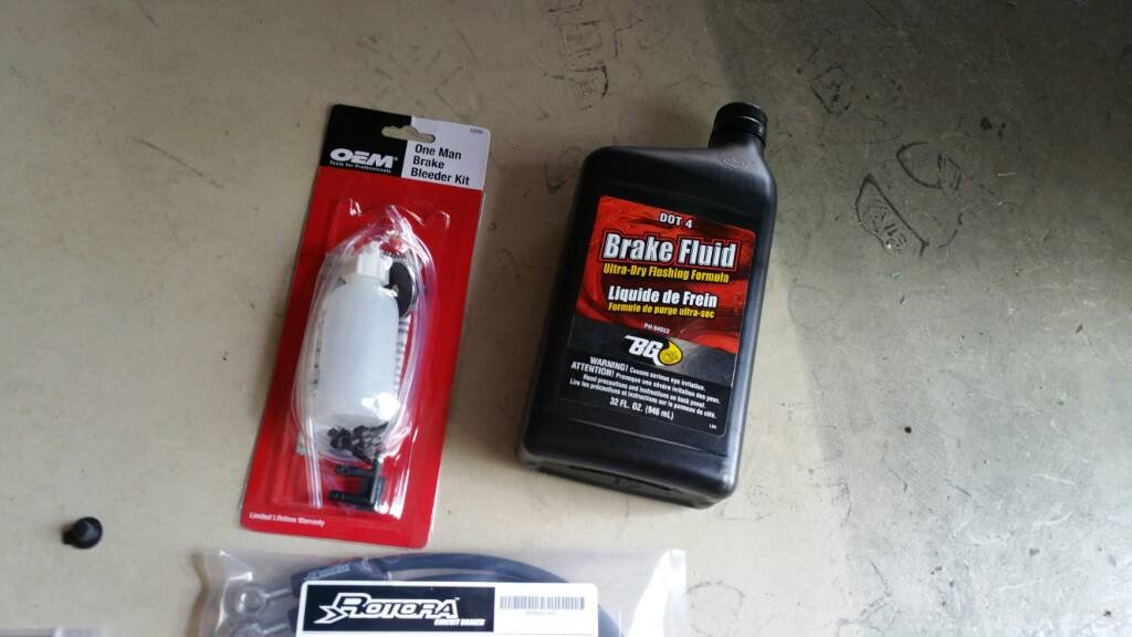

    Bleed & Flush
    In preparation for this kit, I went to the Local Toyota Dealership and had a buddy do a full system flush with the BG DOT 4 Brake Fluid Flush Kit. Hoses were hooked up and machines going nuts. All the while, he was just feeding the machine Fluid. Then came out the baster. He sucked all the old stuff out of the reservoir in the master cylinder and cleaned it some more.
    Went from dark almost black to the yellow goodness of NEW.
    So for the bleeding of the brakes, I had to track down another bottle of the fluid. 15 miles later and about 6 stops at dealerships and parts stores for intel on this elusive DOT 4 beast, Found it. Not cheap, they got me for ~$50 for this stuff. ONE BOTTLE!.
    Couldn't find my make shift collection bottle I made out of a Nalgene HDPE Small bottle and some bubbler hose, so I grabbed the one from the local autocrats store.
    You bleed the same way as any brake system. Says the proper procedure in the manual also. Furthest away, then work your way back in.
