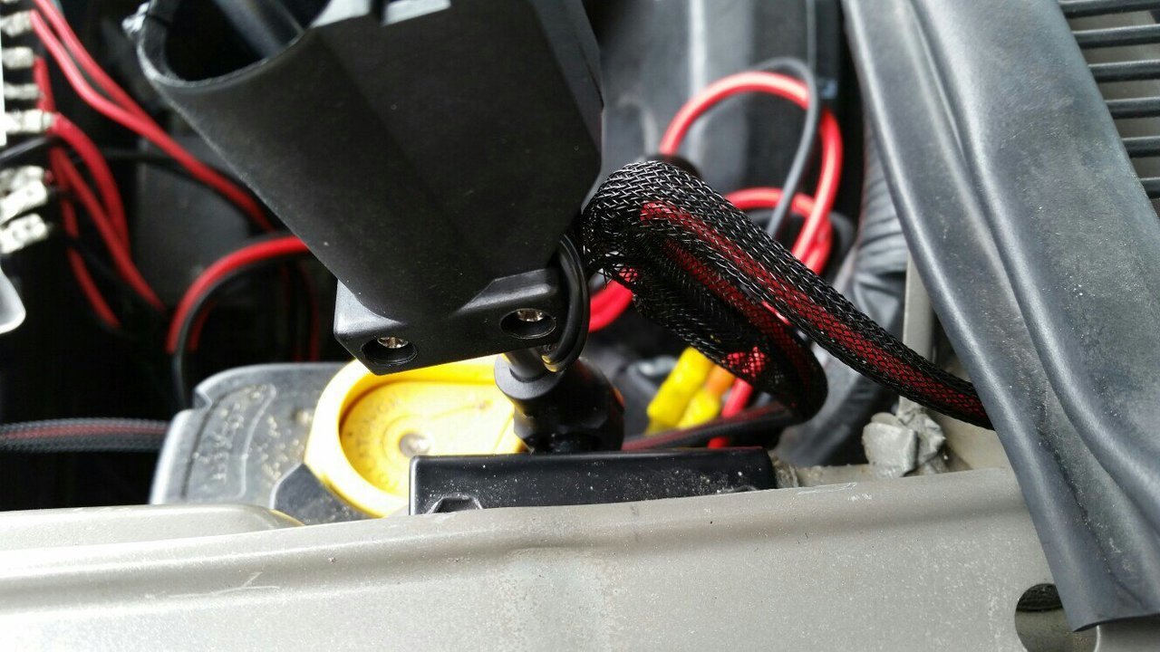

    LIGHT!!!!! = Warm white 5050 LED's w/ black PCB and a gas prop switch, with a few pieces of heat shrink tubing.
    https://youtu.be/0TVZe-YInrg
    was asked for a write up on this.
    Ordered
    * roll of the WARM White 5050 Black PCB Waterproof LED's 300/ 5m roll (eBay)
    * Gas prop switch http://www.ameritoolmfg.com/ReadySwitch.aspx (eBay) http://www.ebay.com/itm/Gas-Prop-Li...Parts_Accessories&hash=item1e83ace98a&vxp=mtr
    * Heat Shrink Tubing
    * Heat Gun/ Lighter
    * Soldering Iron
    * Solder
    * Drill
    * UniBit / Drill bits
    * Braided Wire Sheath
    * 18 guage Wire or thinner
    * Redline Gas Prop hood kit
    [​IMG] [​IMG]
    http://www.truckoutfittersplus.com/store/topper_parts_dome_lights_brake_lights.htm
    All the LED's are waterproof, cuttable, and have an adhesive back.

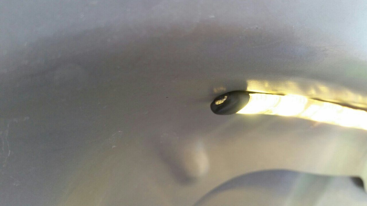

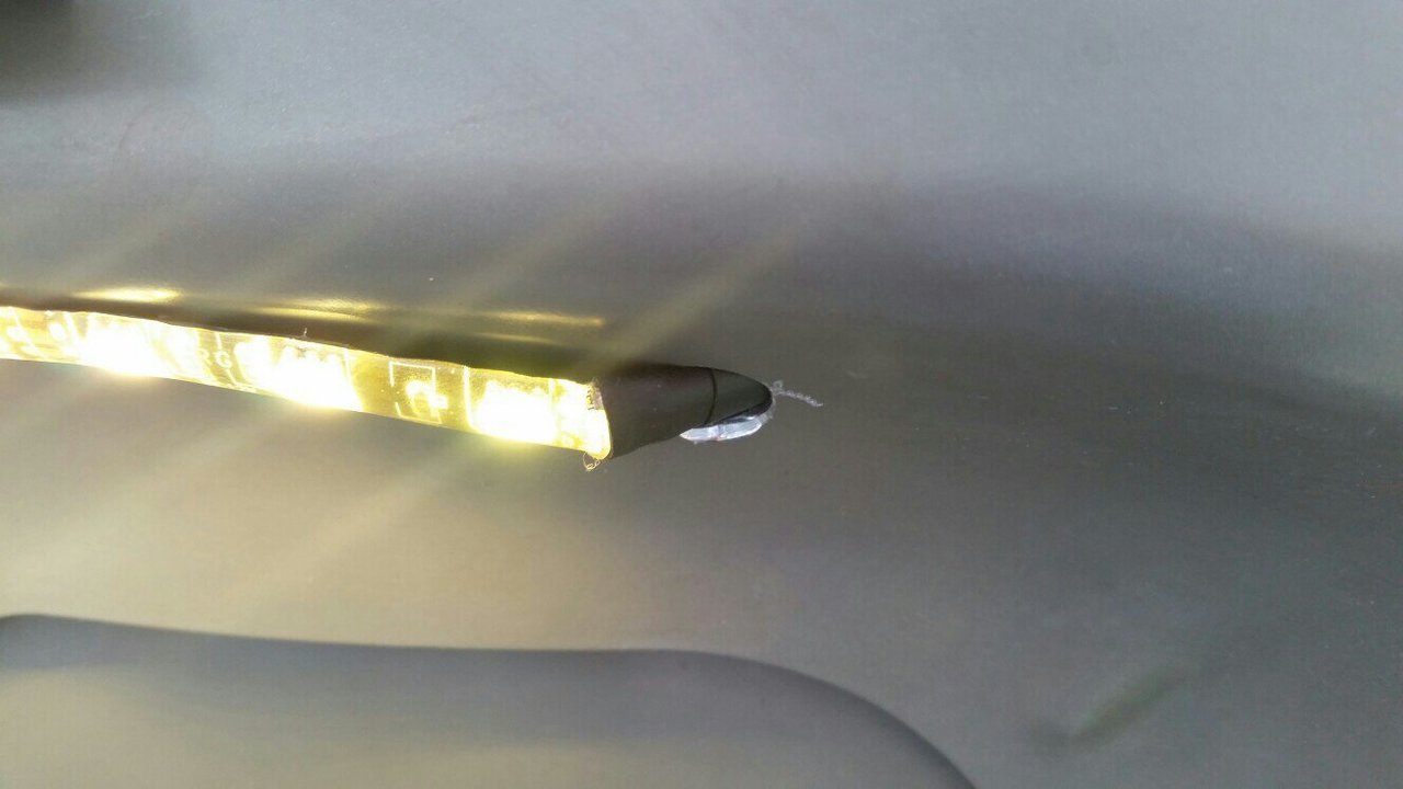

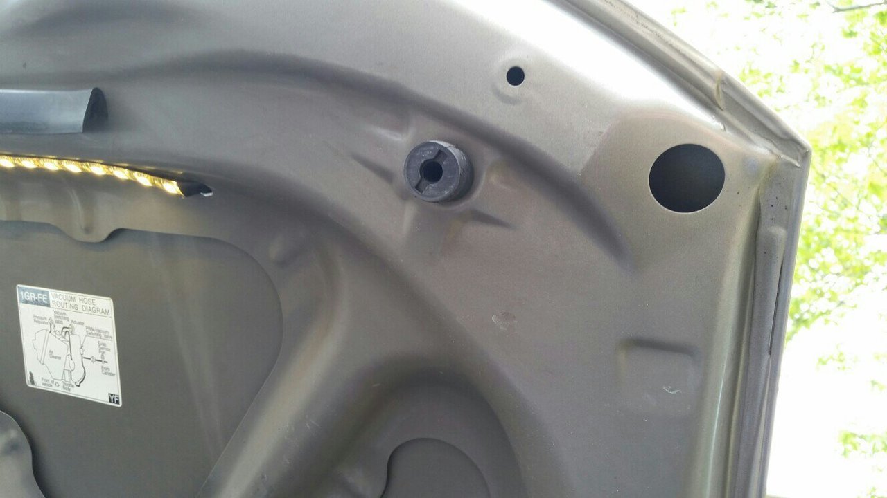

    Without a measuring tape, I held up a piece and measures where I wanted it to go. Cut it and soldered the end up for power. Using a piece of Heat Shrink Tubing (HST) I sealed the opposite side to maintain its 'waterproof'.

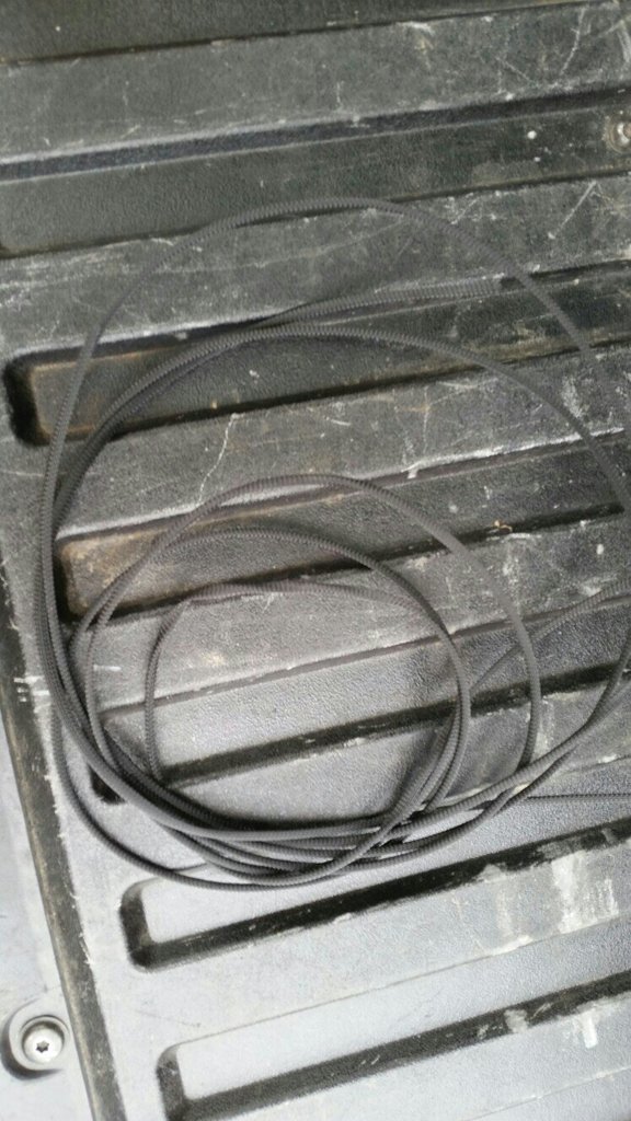

    taking the Red and Black 18 gauge wire, I threaded it through the sleeving.

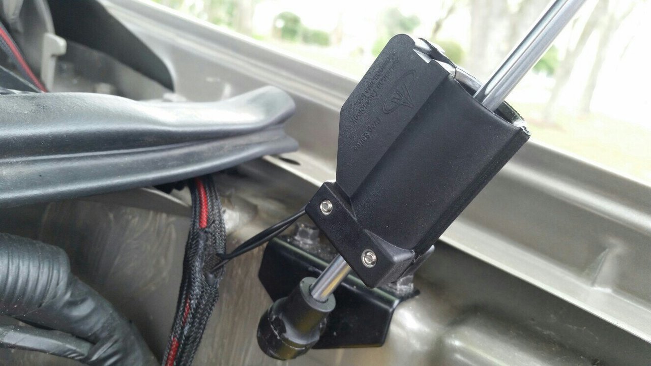

    - So on to the Redline Tuning kit. Install it, and then use a piece of HST with the internal waterproof sealer. Home Depot has it in the electrical isle. HST the bottom part of the shock where I did.
    then install the Prop Switch with ~6" of wire hanging off. You will need a small piece of tubing or rubber to stick around the shaft of the Prop in order for it to properly grasp. I positioned mine @ ~ 1" - 1.5" from the bottom of the shaft.

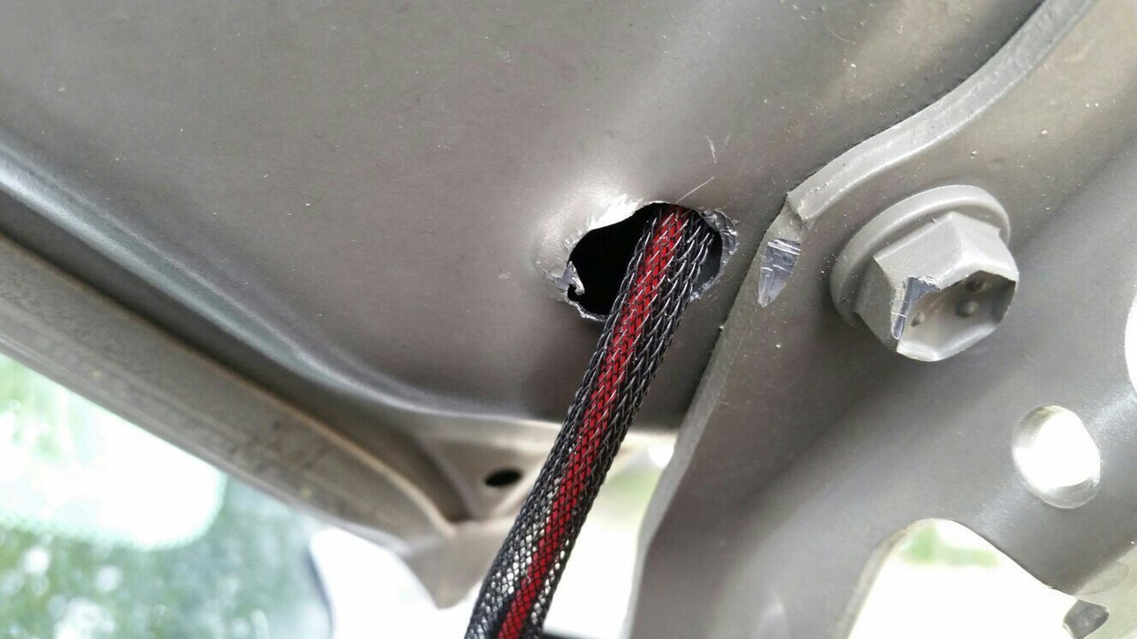

    Now onto the drilling. I made 2 holes using my UniBit. One right about center where I wanted to run the wire from the LED's and the other at the bottom near the hood hinge. No it is not pretty, but I am cleaning it up. Painting it and De burring it.
    7e3ypy6e_123282c7788d3b38f4e80ecc3e42c143fc51f57c.jpgquqapyhu_f20dac377d098297fcc3f6bc60aa6128d747b1cf.jpg
    Solder up the new harness you made to the LED's, heat shrink it all together to tidy up the ends and you are ready to pull the wire through the hood. If you look, there is a hole in the side of our hoods. I pulled out the wire through that hole then dropped it through the hole again to reach the bottom hole. Using a paperclip, I made a hook and pulled the wire through.

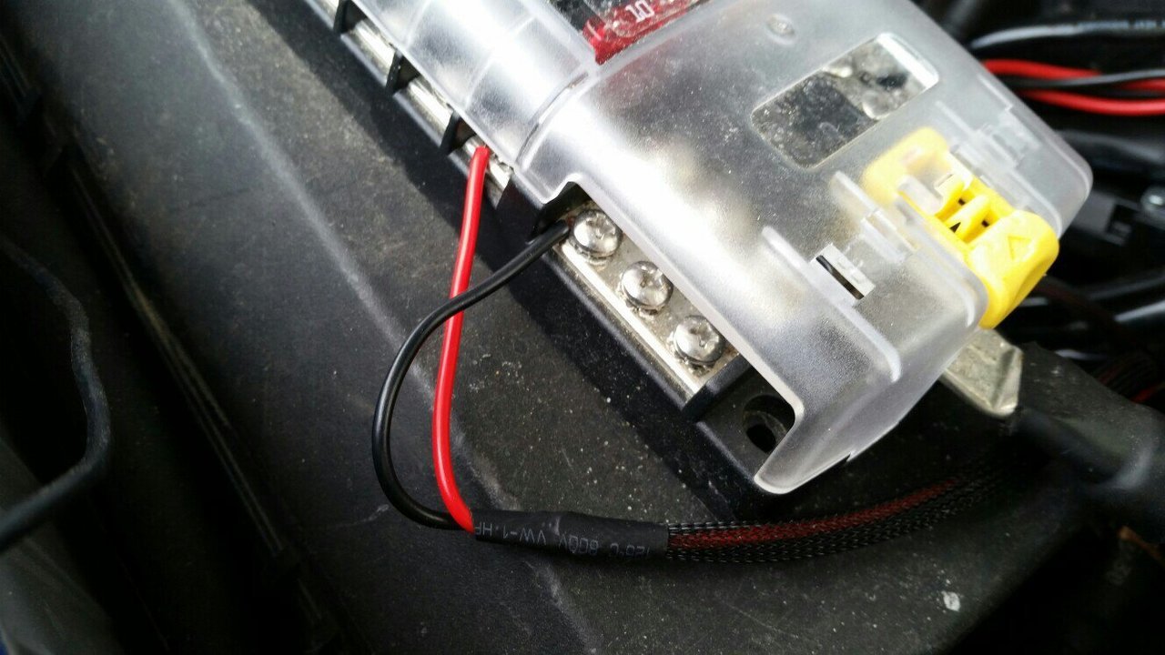

    Splitting the loom, to allow the switch to be integrated into the braided harness I made. I cut the negative wire and soldered each end up then heat shrunk it. Pulled it all back into the loom, and I have plans to 'loop' the wire onto itself and make it a little more tidy.
    Wire it up to POWER, or a fuse block, whatever you please. I will also be wiring this into my alarm and door switches so the lights all come on at the same time.
    Last but not least, just route the wires where you are comfortable with them. Adjust the height of the prop switch to turn the lights on and off at the hood height you are happy with. I wanted mine to turn on as soon as I popped the hood. Thats why mine turn on so low. Leaves no play for the future when I do the rest of the Alarm install.
