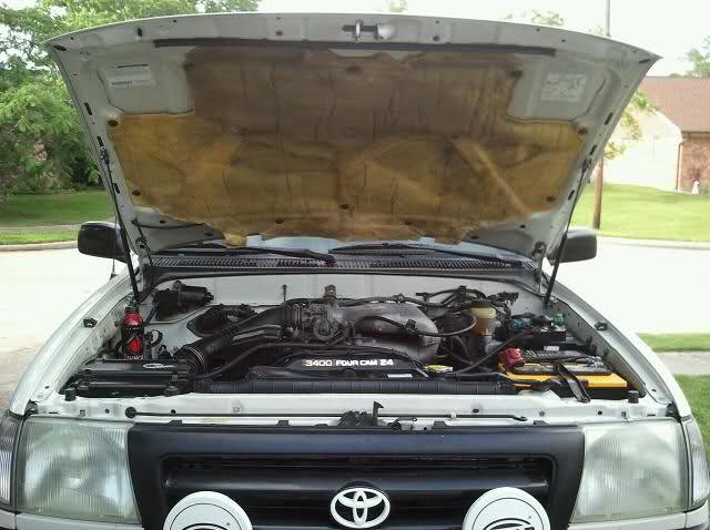

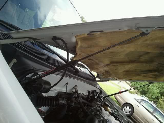

    Put on some Redline Tunning hood struts

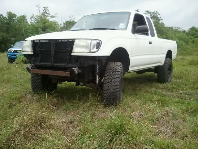

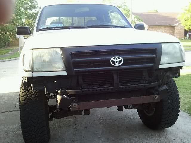

    Got all of the metal for my bumper build today, useing 1/4" angle iron for the crossmember/base and 2" x 2" .125 1/8" wall square tubing. I took off my stock bumper (now in the trash) and got the crossmember/base built and installed today so I can start welding onto that. :D:woot:

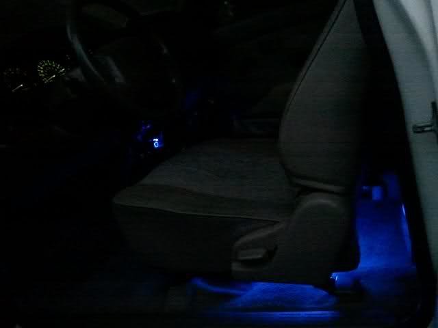

    Messed up my stock grille, and out with a few friends:
    Ordered a new one already painted black:
    Moved the blue led's under the seat (crappy pic but you get the idea, and it does light up the front floor board):
    :D

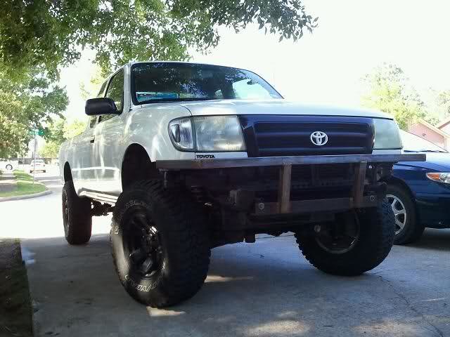

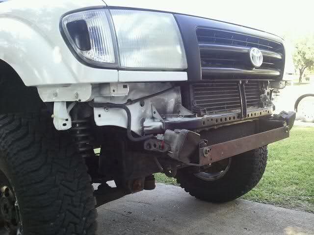

    Got some work done on the front bumper:

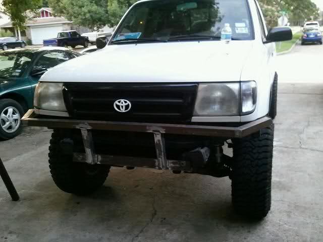

    Got some more done:

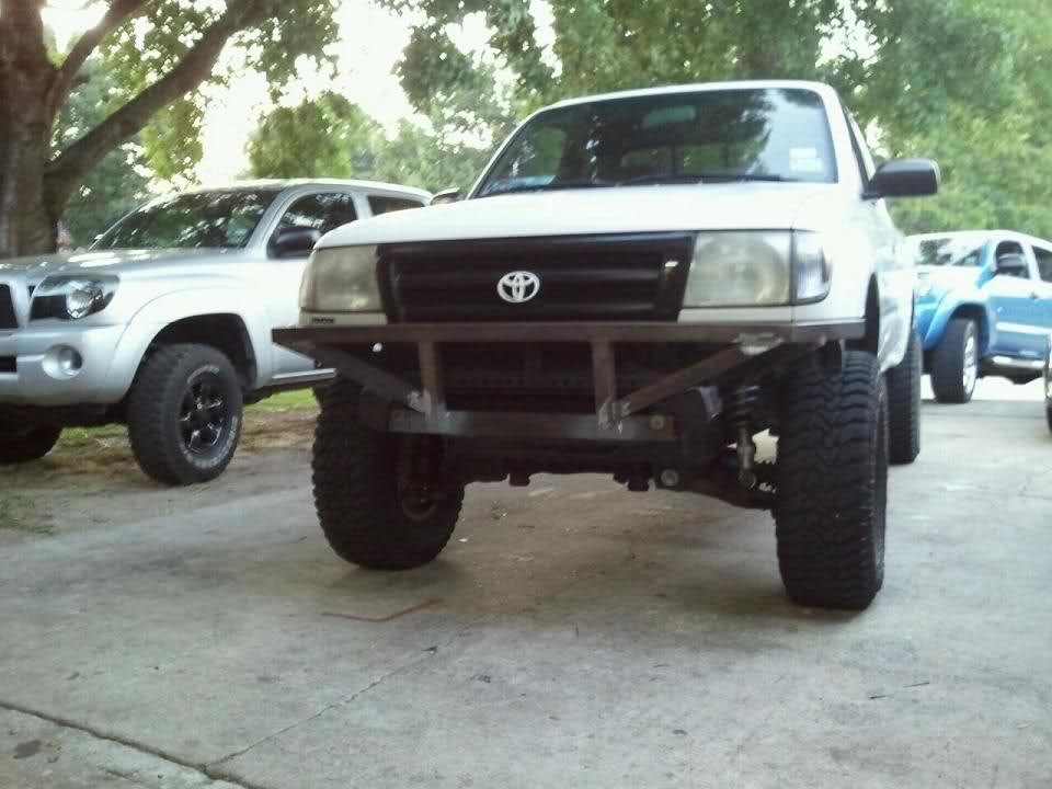

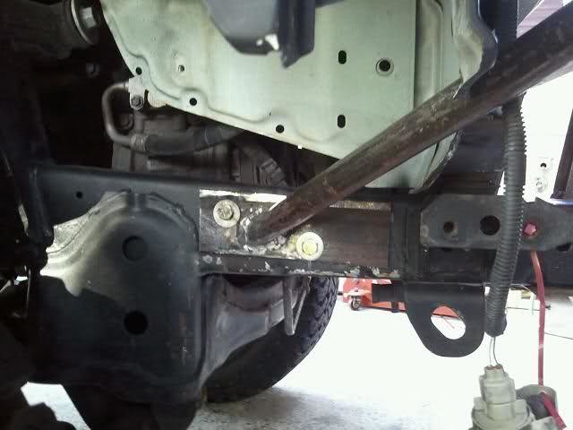

    Got the brackets and support bars welded on:
    Bracket:
    Support bar:
    Now I just gotta weld on a light hoop with lights tabs and two more pieces going from the front bottom mount angled to the main bar and bedline the whole thing. :D
