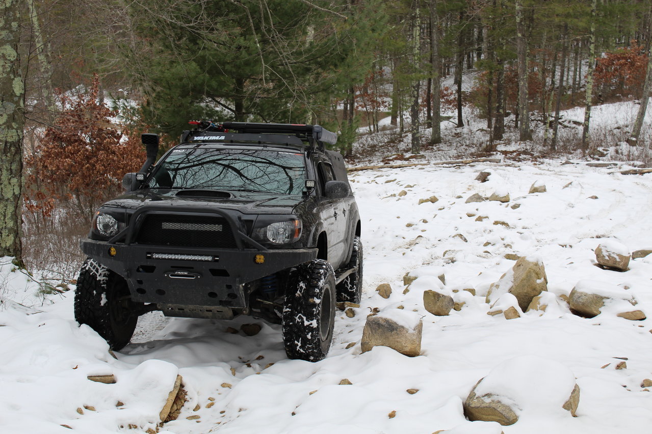

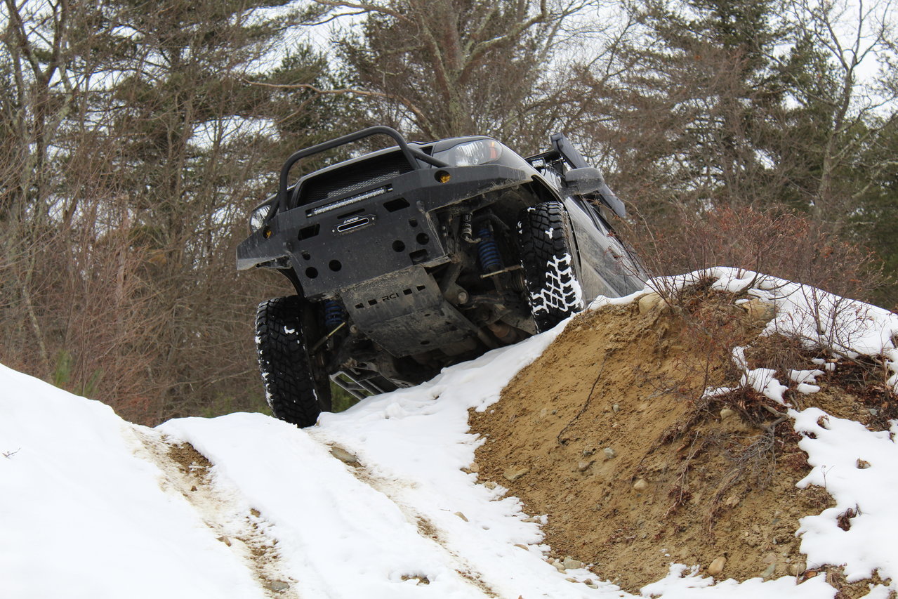

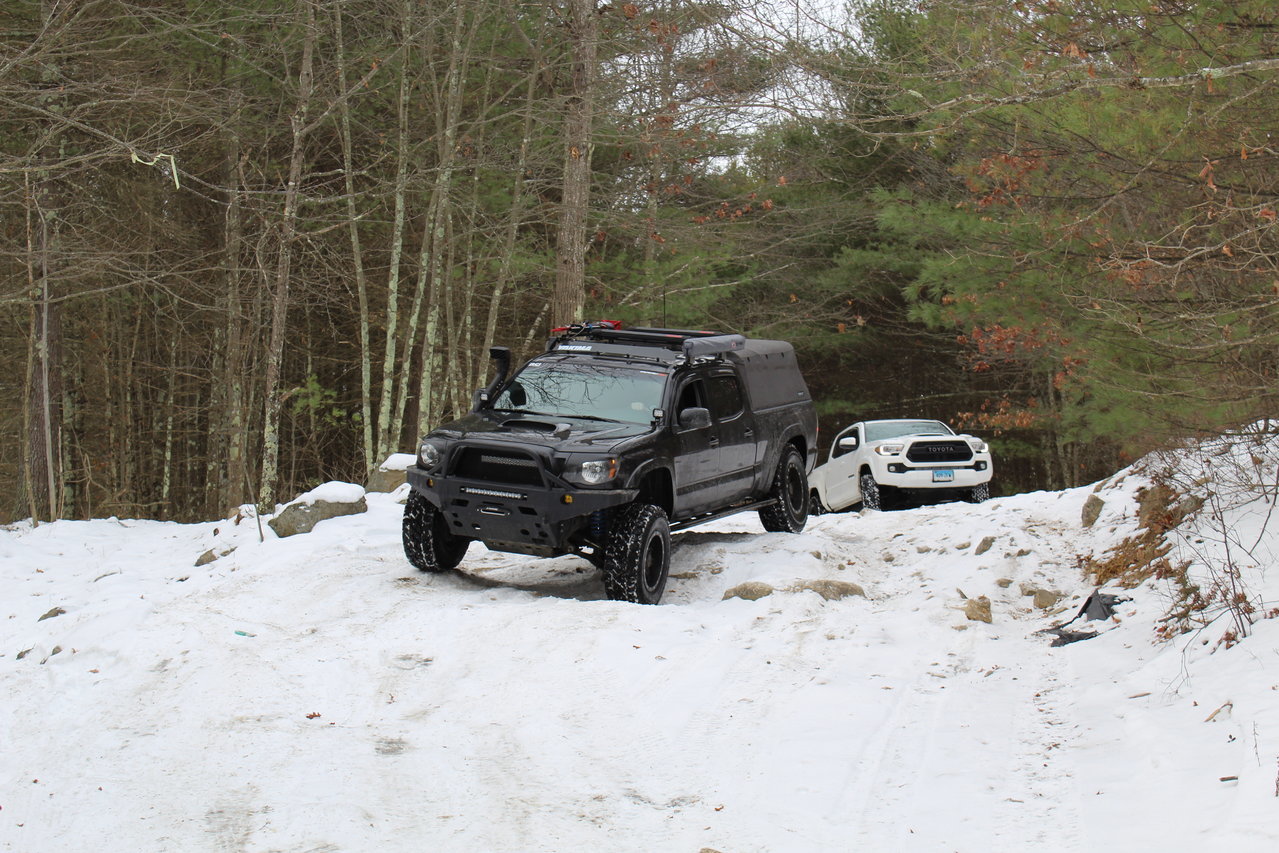

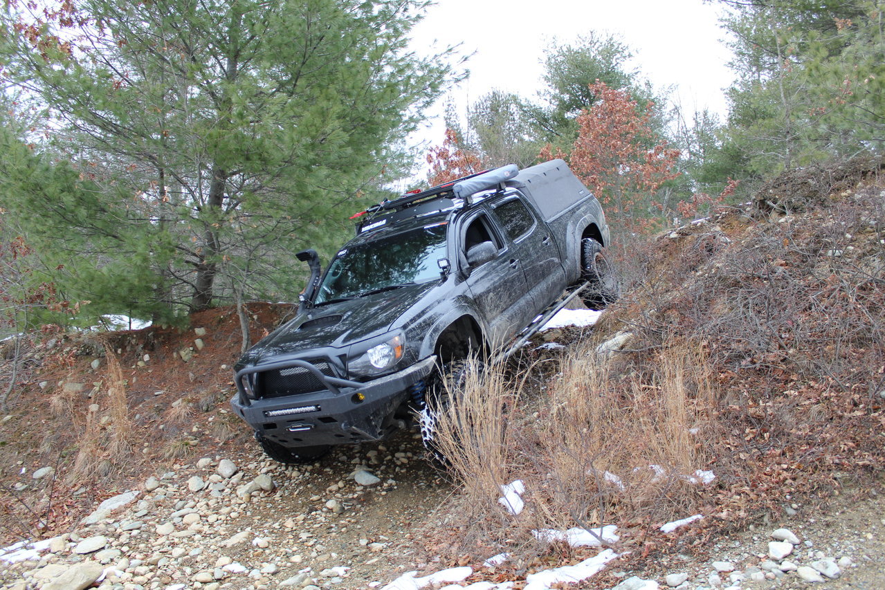

    Monday 12/18/17 wheeling:
    IMG_0851.jpg IMG_0874.jpg IMG_0884.jpg IMG_0888.jpg IMG_0892.jpg IMG_0894.jpg IMG_0899.jpg IMG_0910.jpg IMG_0925.jpg IMG_0928.jpg IMG_0930.jpg IMG_0954.jpg

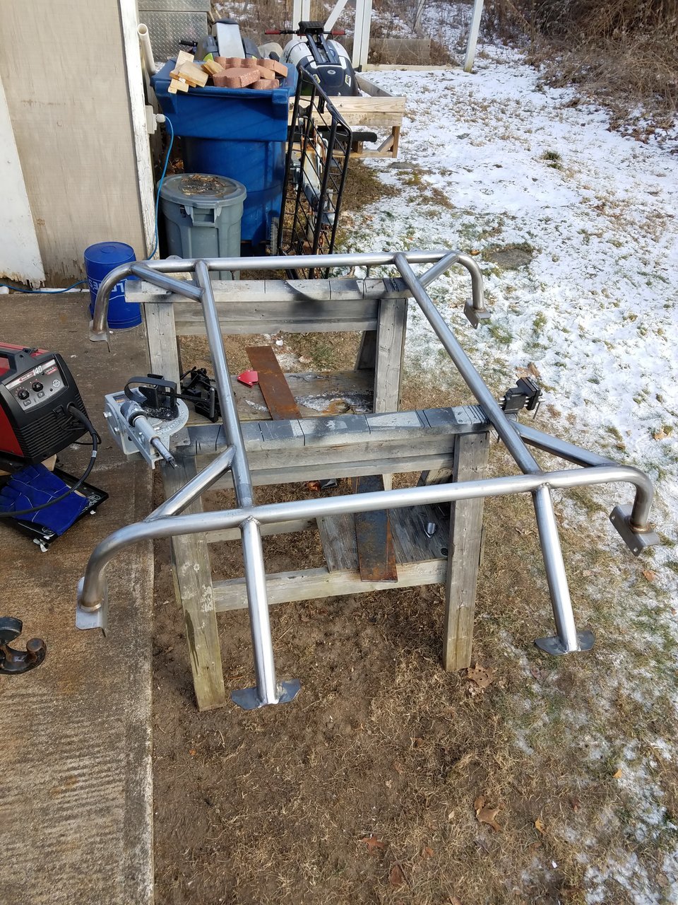

    My plan is to purchase a RTT this spring for camping trips and mtb enduro races. I wanted to mount it to a set of bed bars because I figured they are easy to install and I could do it myself. However, I didn't want just bed bars, I figured they would look to plain if the RTT is off the truck. I wanted something unique/custom to me. So I went ahead and ordered a set of bed bars from 4xinnovations. Great company to deal with. With the bed bars, I asked for them to send me two pieces of tubing 4' pre-notched. I would used these for extra support and to tie the bed bars together. Then I went ahead and ordered some more tubing from metaldepot.com, purchased a tubing notcher and a metal chop saw from harborfreight. Then I went ahead and starting fabricating pieces to make the bed bars "my own." Everything was welded together with a Lincoln Electric ProMig 140.
    Cut and welded some light tabs for the rear and welded some bolts which will hold my hi-lift jack.
    Made some brackets out of 2x2 3/16" angle iron to mount to the front of the bed rails.

    Been away from the forum for a little bit, failed to update bed rack build as it's finished now. 20180301_160514.jpg 20180301_154845.jpg 20180301_165447.jpg 20180325_123548.jpg

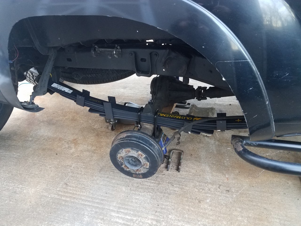

    Old Man Emu EL096R leaf packs installed

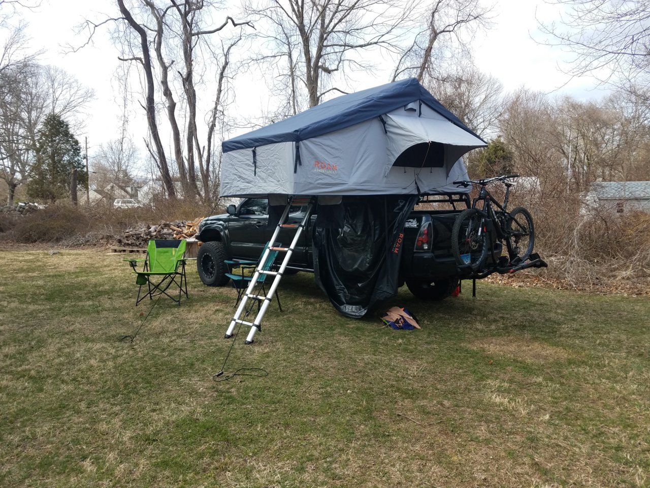

    RoamAdventureCo rtt and yakima hold up bike tray, ready for adventure
