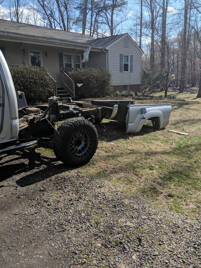

    Sho nuff did Started working on it fri afternoon when I got there and had pretty much everything done by sat night. We had a lot of other hands to help, 2 welders, and jobs assigned to each person as to make it go smoother and quicker.

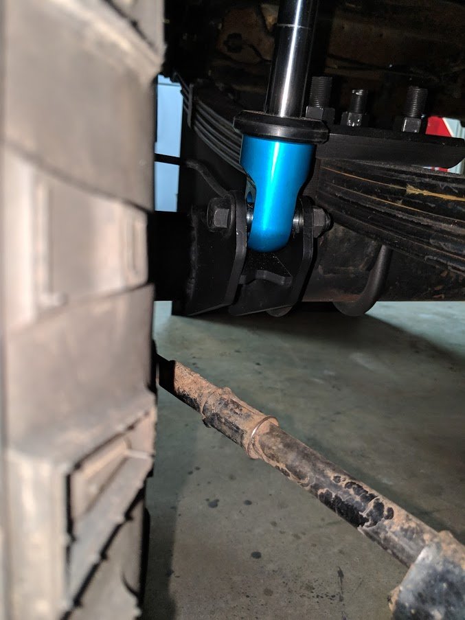

    Benefit of raising towers up 1" with 14" kings lower shock mount set for ~6" of bump is at the top of the axle tube

    The 62” spring under and Chevy 63” springs are apples to oranges. The 62’s will allow for an additional 5” of up travel and 7” if you notch the frame. This will allow the truck to sit low and have 9-10” of uptravel at ride height. The 62’s will ride night and day better than the 63’s if you plan on driving the truck at speed. If all you’re concerned about is slow speed articulation then the 63’s will be fine. The JD shock mounts are designed to allow the axle to bump out on the frame with a 14” shock... if you do 63’s spring over then you would have room to run a 16” shock or just mount the tabs off the top of the axle. Deaver also makes a spring over pack that works with our hangers/shackles if that’s the route you want to go.
    Personally I would only ever go spring under as the ride is much better, the truck can sit lower and you gain and additional 5” of travel.
    I’ve wheeled in the big rocks at Johnson valley for years with spring under and never once had an issue with the springs getting hung up on rocks. The spring under kit also uses a cupped spring plate that allows the u bolts to be shorter than the spring pack and protects them at the same time

    If you are reffering to removing the bed to do a relocate then yes it's much easier. We did a bunch of other stuff though where the bed would have to have been removed like boxing the frame
