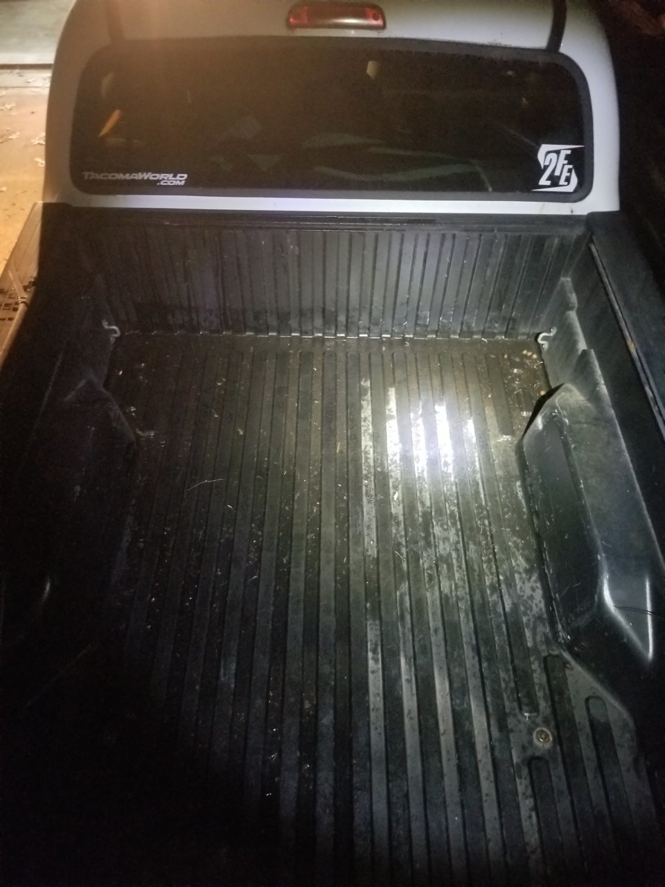

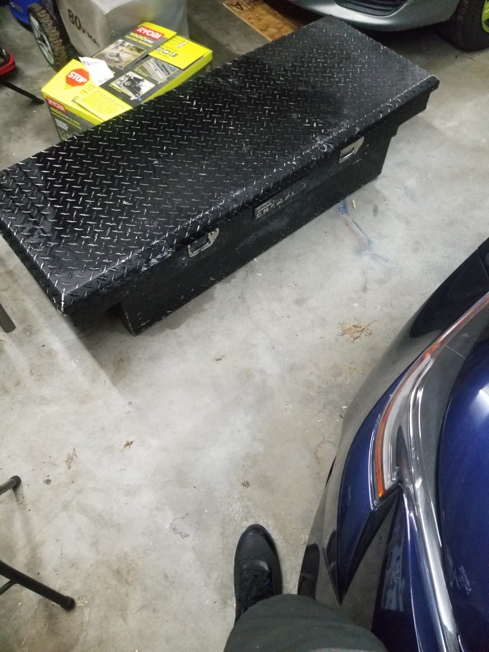

    Prepped for the 62 swap, removed the toolbox so we can pull the bed if we need to. Also swept out about 10 lbs of acorns.
