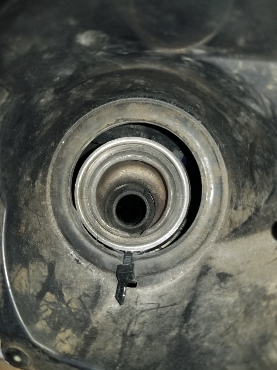

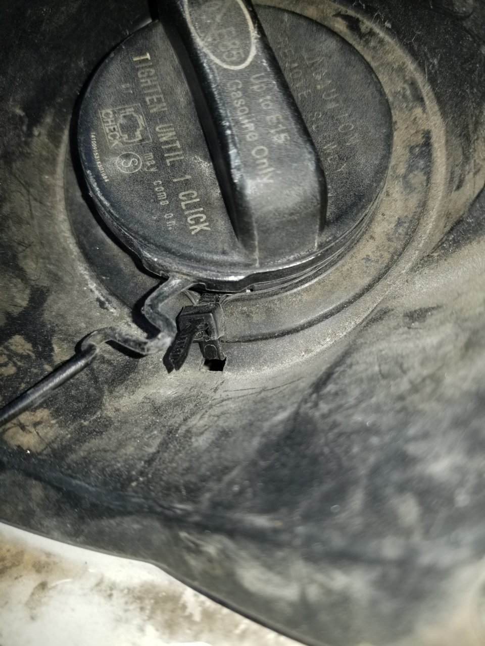

    So I got a CEL for the gas cap. Cap is fine, just can't get a good seal since it's not in the OEM location and is pinching the OEM gasket at the fuel door between the cap and the neck. :annoyed:
    Gonna have to buy some fuel hose, chop the neck, lengthen and reattached to OEM location if I want that sucker to clear for good. Which means the bed needs to come off again... :facepalm:

    replace the kink section with new fuel hose. blow torch? can't be tight if it's liquid.
