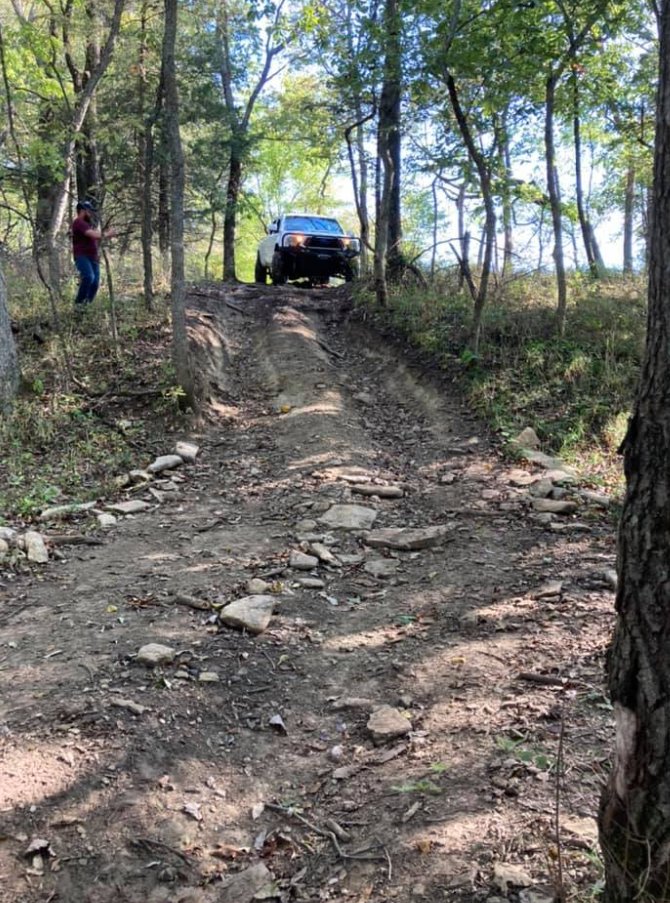

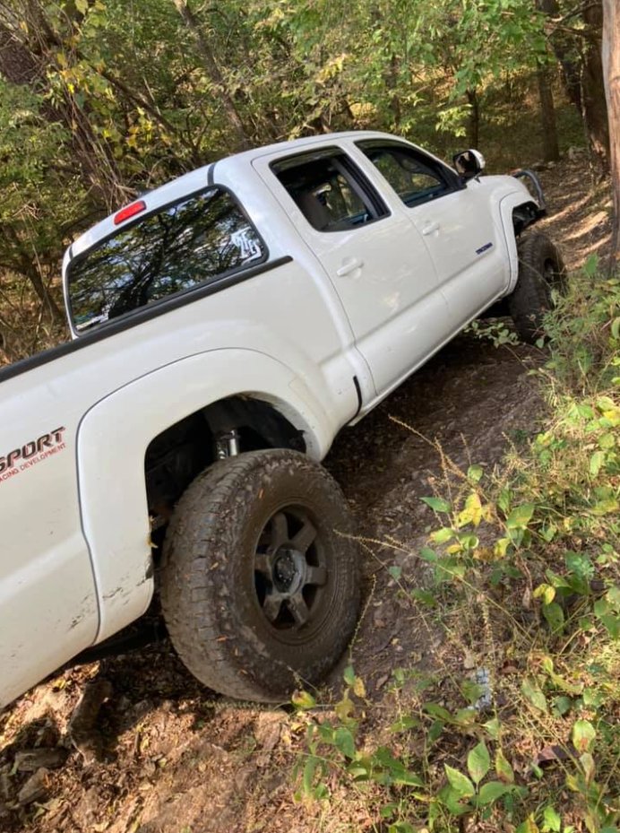

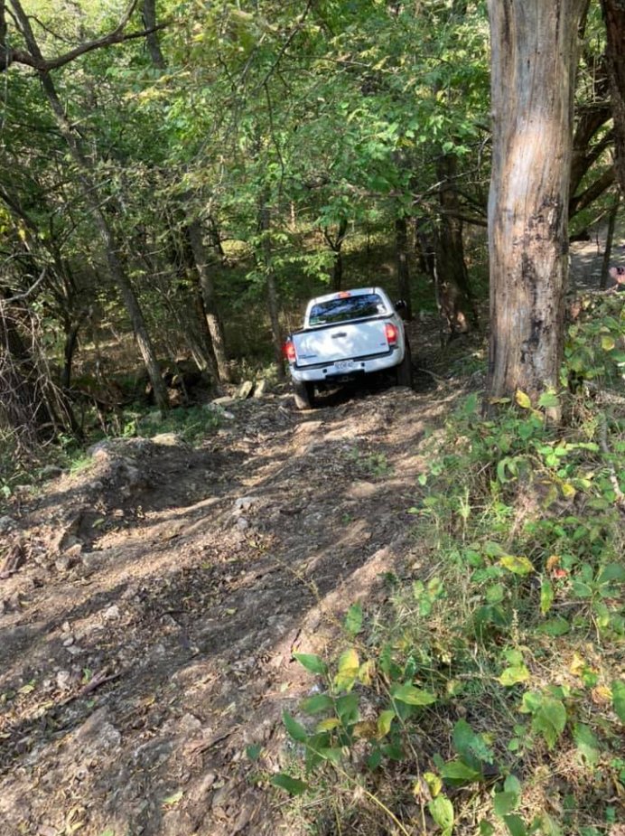

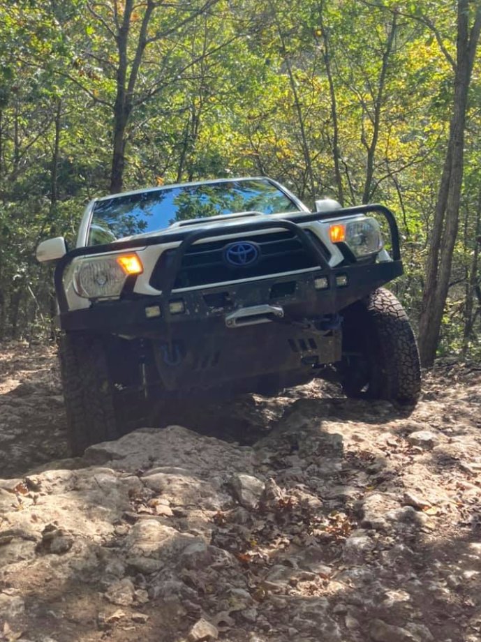

    Lil bit o' wheeling today at KRRP
  3. Oct 10, 2021 at 7:09 PM
    #1103
    Slashaar
    Slashaar [OP] Trail Limo Supreme & Certified Hole Massager
    Nov 23, 2017
    #236717
    15,516
    Josh
    Kansas City, MO
    2015 Tacoma TRD-Sport DC LB
    Coastal HC Front, 6112s+650lb King Coils, JD 62 Swap + 14" Fox 2.0s

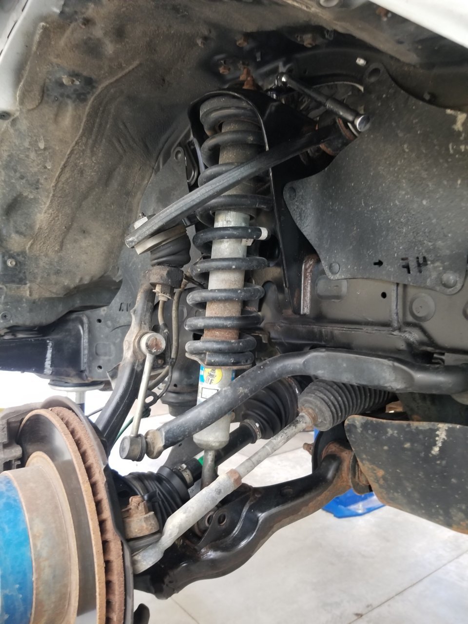

    Today was hoot. Had a blast. Just shows Trail Comms are a must. We'll get that sorted for the next go round.

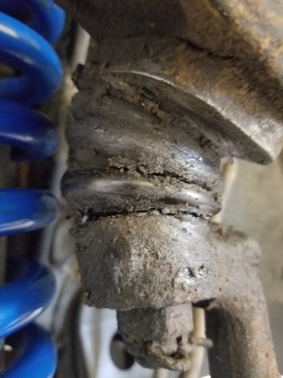

    Also ordered new SPC UCA joints since I suspect mines going out.

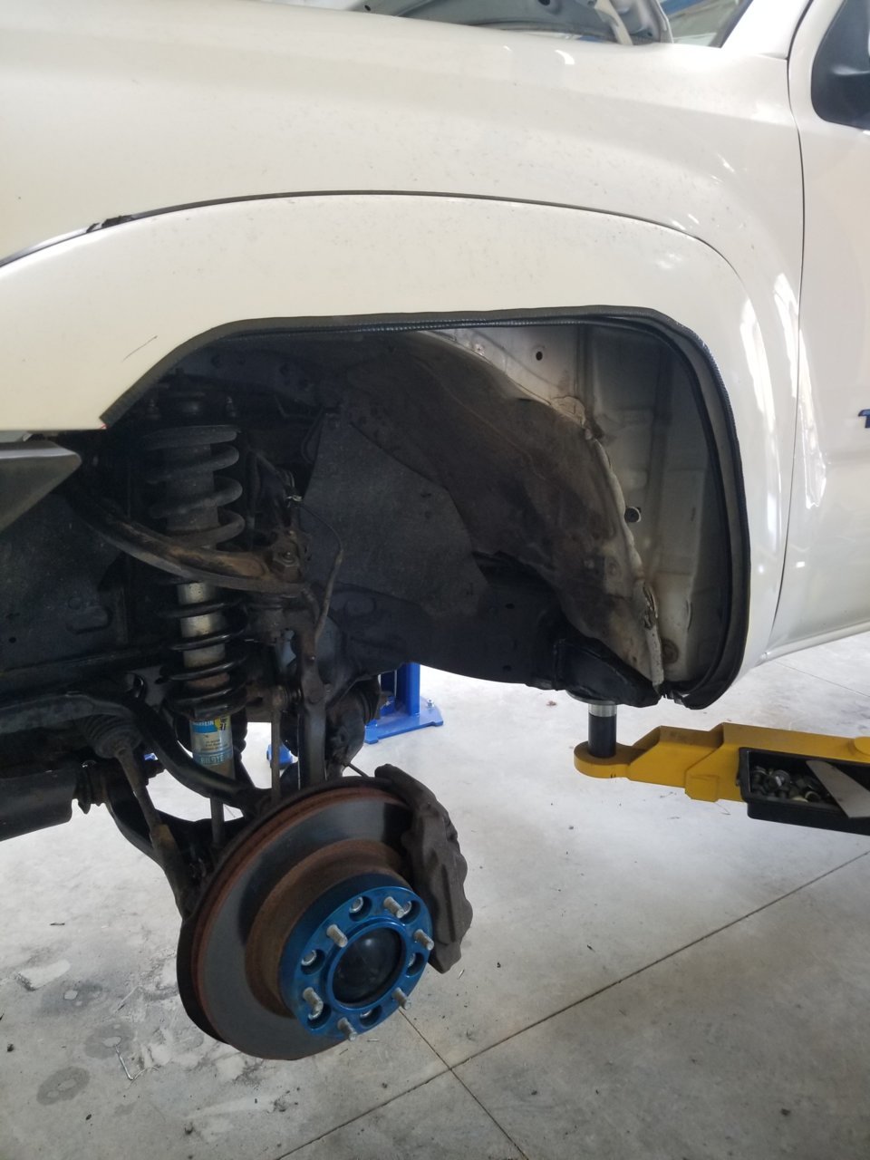

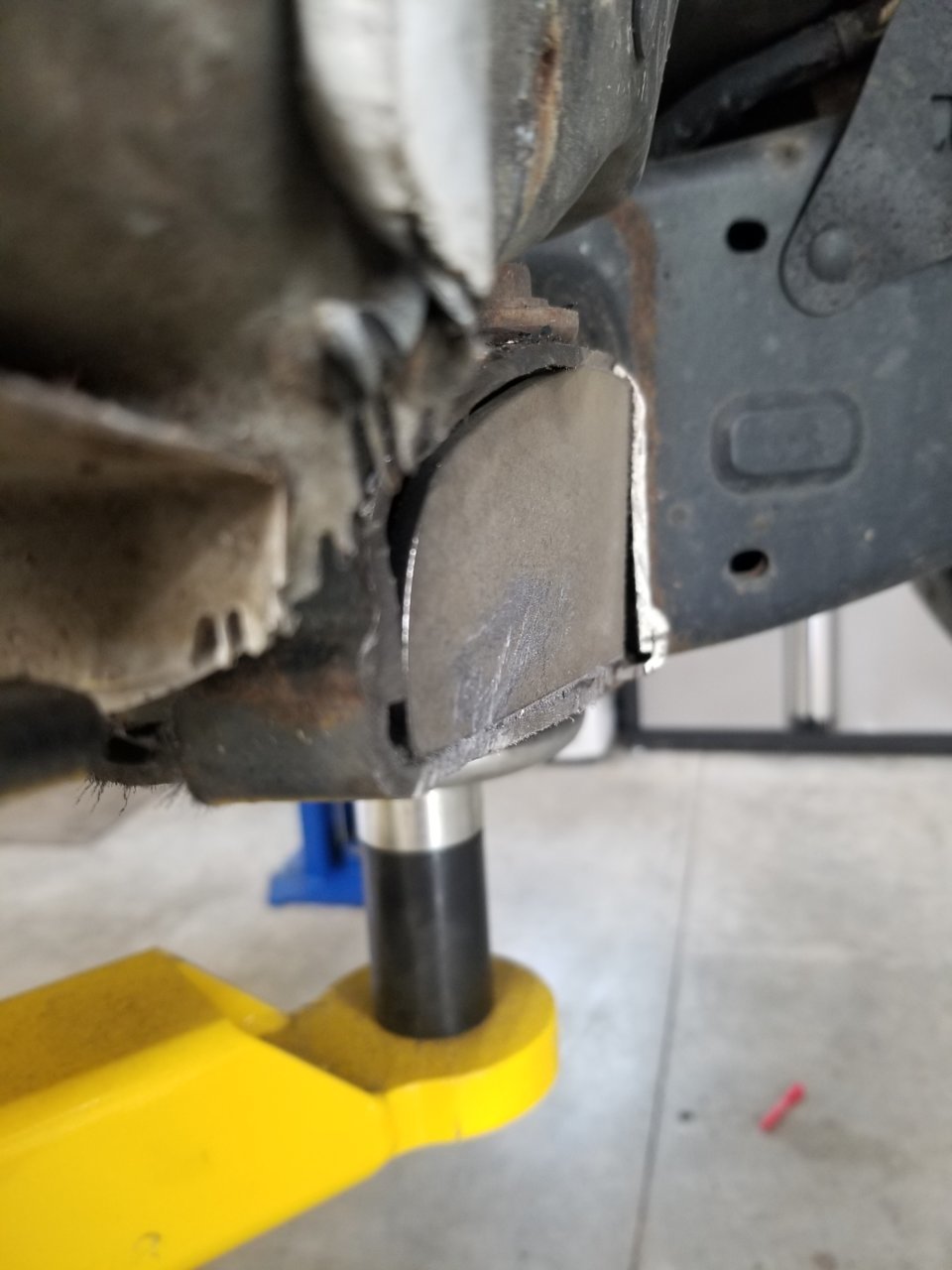

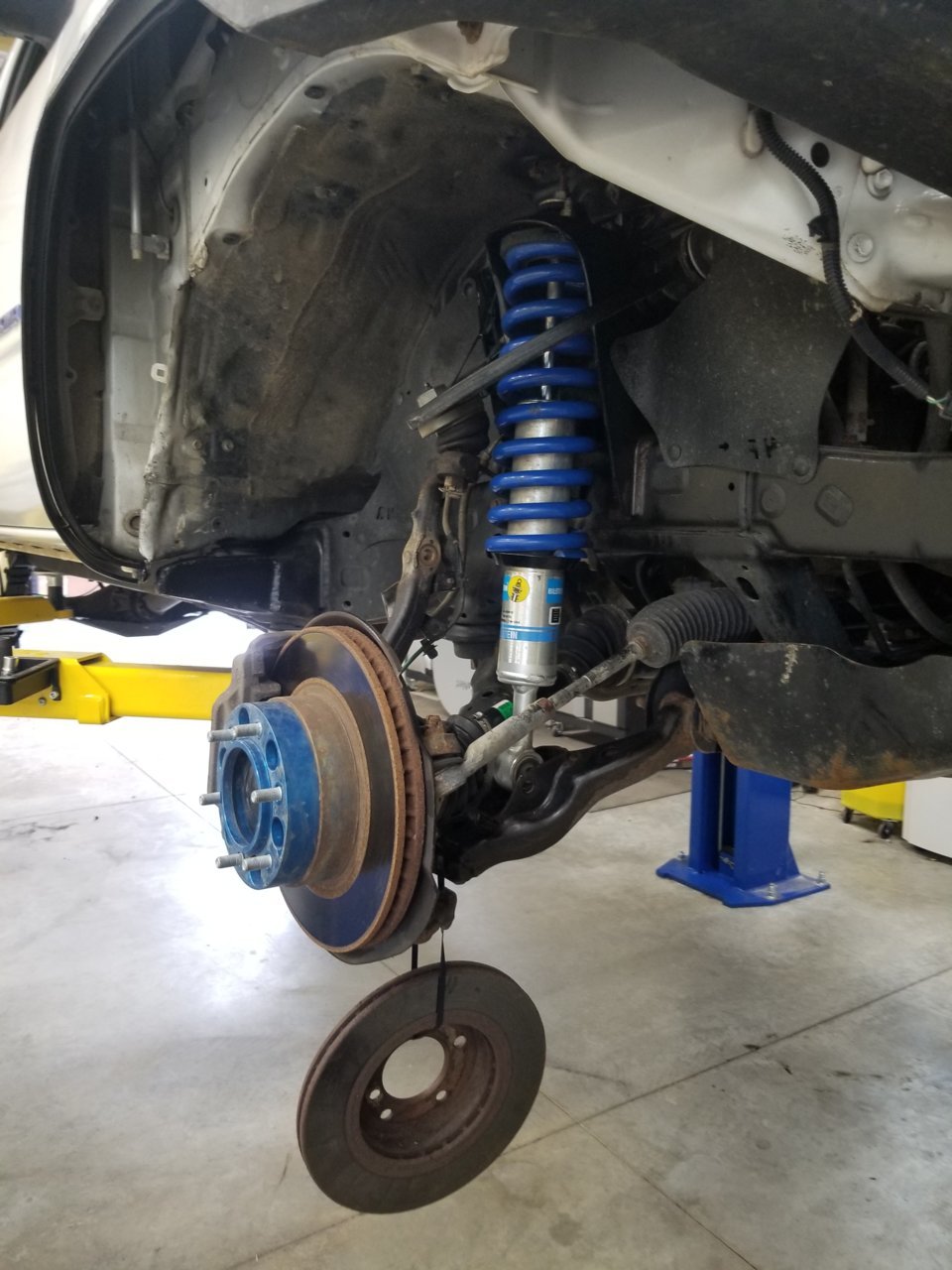

    Also, forgot to post last weekends upgrades and truck surgery.
    Put my wheels on finally, left on the spacers which created some clearance issues so... :sawzall:
    Headed over to @Sociopenguin 's 2FE Headquarters to do a little wrenching. Thanks broseph. :fistbump:

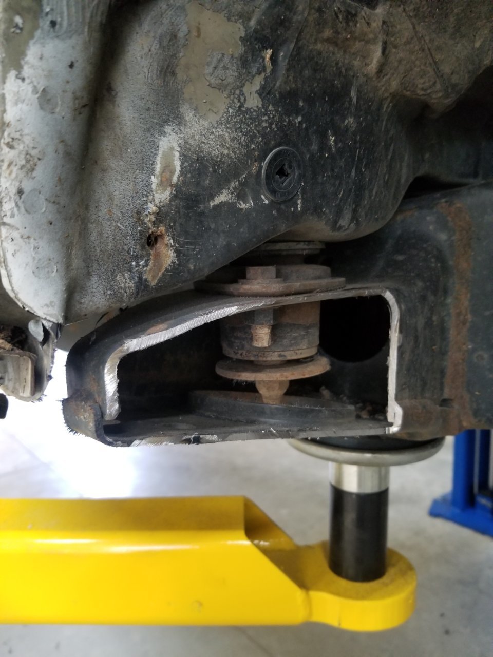

    Cab mounts turn for some choppage.

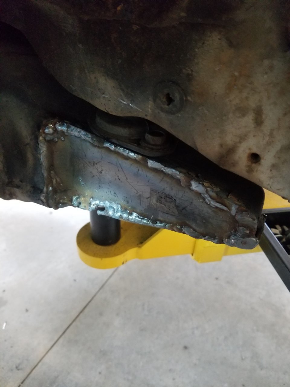

    Welded. :welder: Made a custom plate from some scrap on the driver's side since I went deep on this one. :notsure: Still ended up stacking welds to fill gaps.
    Done. Time to remove some junk.
    Last time the sway bar was attached. Cya.
    6112s with King 650lb coils
    My custom counterweight.
    All done.

    @kasnerd @WormSquirts ditched the sway bar, and took the 62s on their maiden voyage. Performed outstanding. I need to trim the U-bolts. :anonymous: Also rear fenders need the :sawzall: treatment.

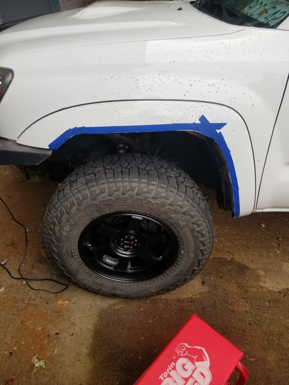

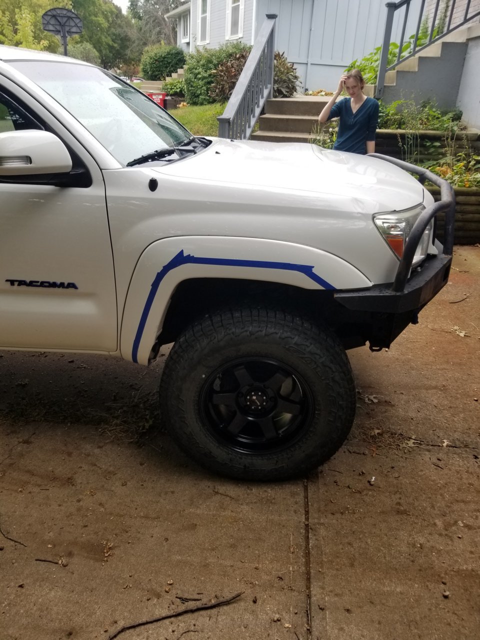

    this is how the the man, the myth, the legend (Harry) told me how he did mine.
    https://m.youtube.com/watch?v=Y9XrfWrd9IE
    use a metal awl or carbide tip to make a sharp line.
    body panel saw (hand air saw) for the rough cut
    sand down to scribe line, round over/deburr the back.
    don't drink any coffee or do smack, you want a steady hand and a lot of patience.

    I made a very similar tool specifically for the markers I use, and the amount I cut Tacos for 35's, and do pretty much the exact same thing as described. You can also free hand it pretty close by holding the pen steady and sliding the palm of your hand around the edge. Basically using your hand as that tool.
    If you're keeping your flares, I find it easiest to remove them (save as many clips as possible by turning them 90 degrees from the inside), then cut the metal, then reinstall the flares, then cut the plastic so they come down about a 1/4" further than the metal.
    edit: sorry just now read up a bit further and realized that you already cut your fronts, so you probably already figured it out. but that's how I do it anyway.

    I tried to get as close to the body line on the top of the flare as I could, then I just measured about where the other lines were and painter's taped it up. This is smart though
    I have a compass. I'd happily use that to create a line for the rears lol
