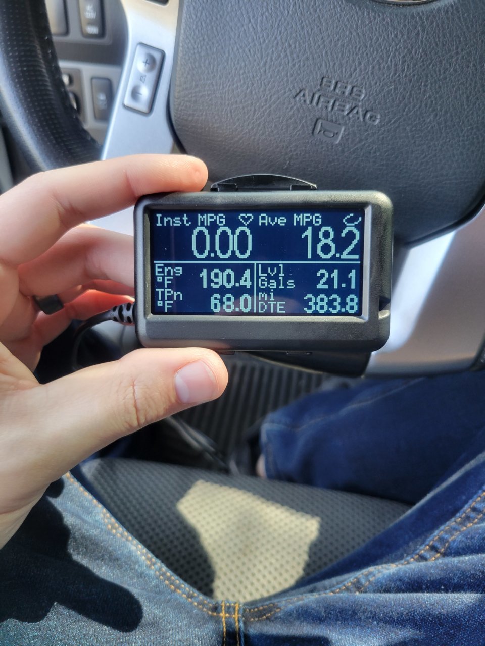

    Got one of these to help with driving habits and the trans temp settings. Need to set up the trans temp and eng temp. See if I cant replace the bottom left with that and swap tte to dte on the bottom right.

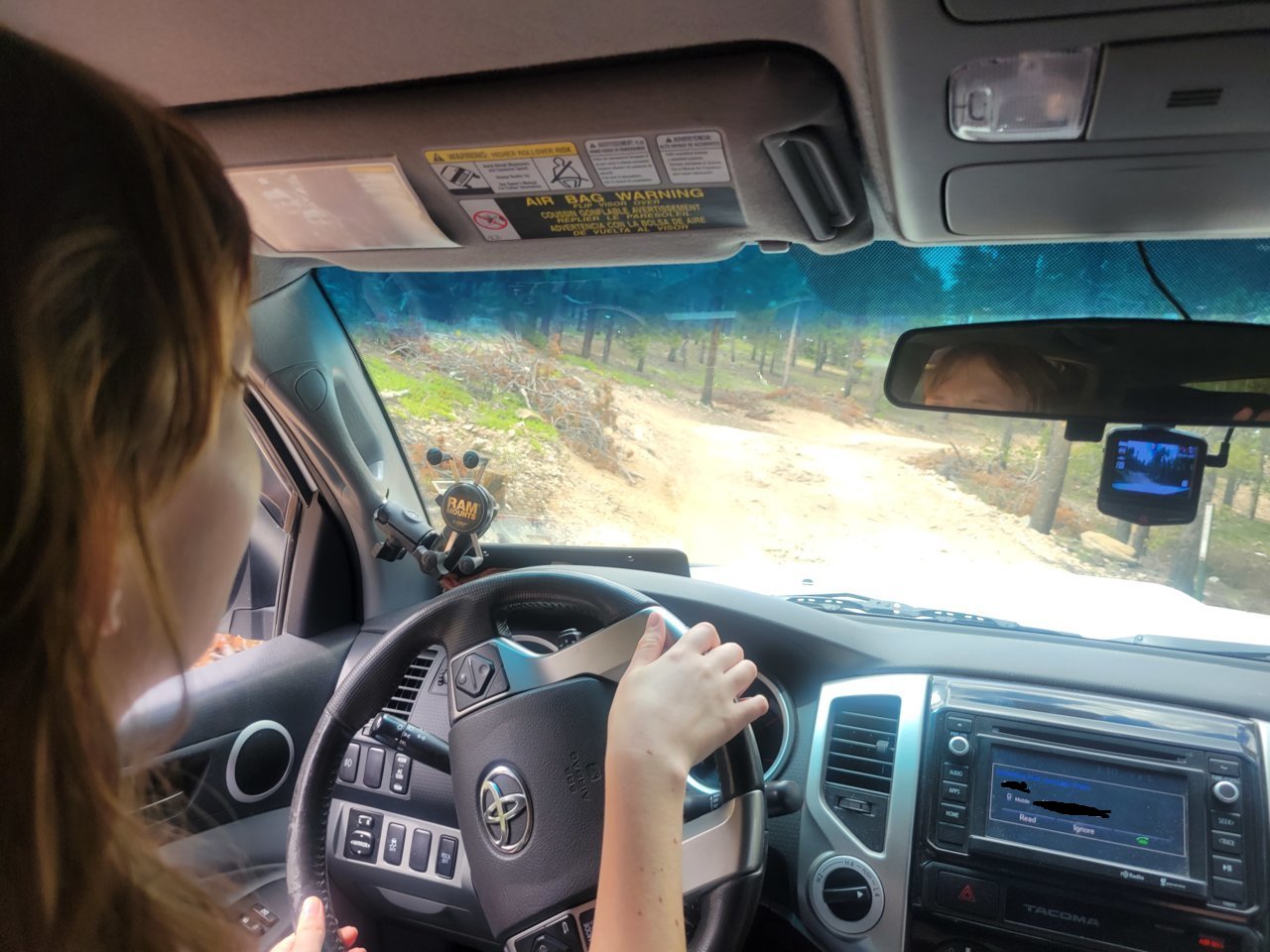

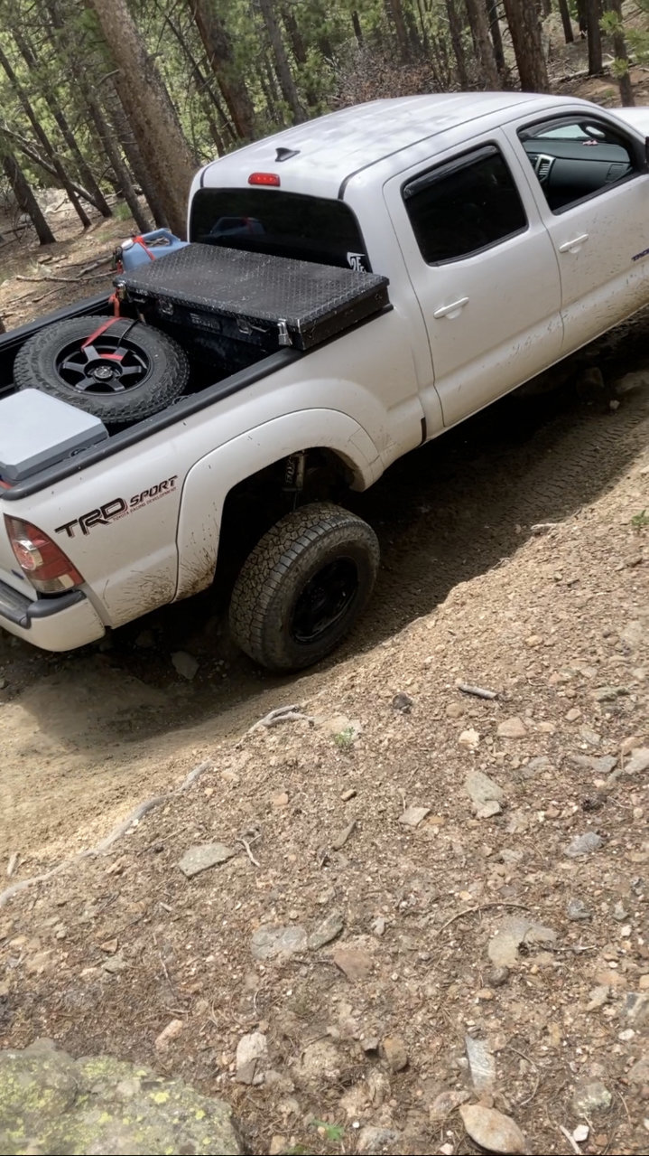

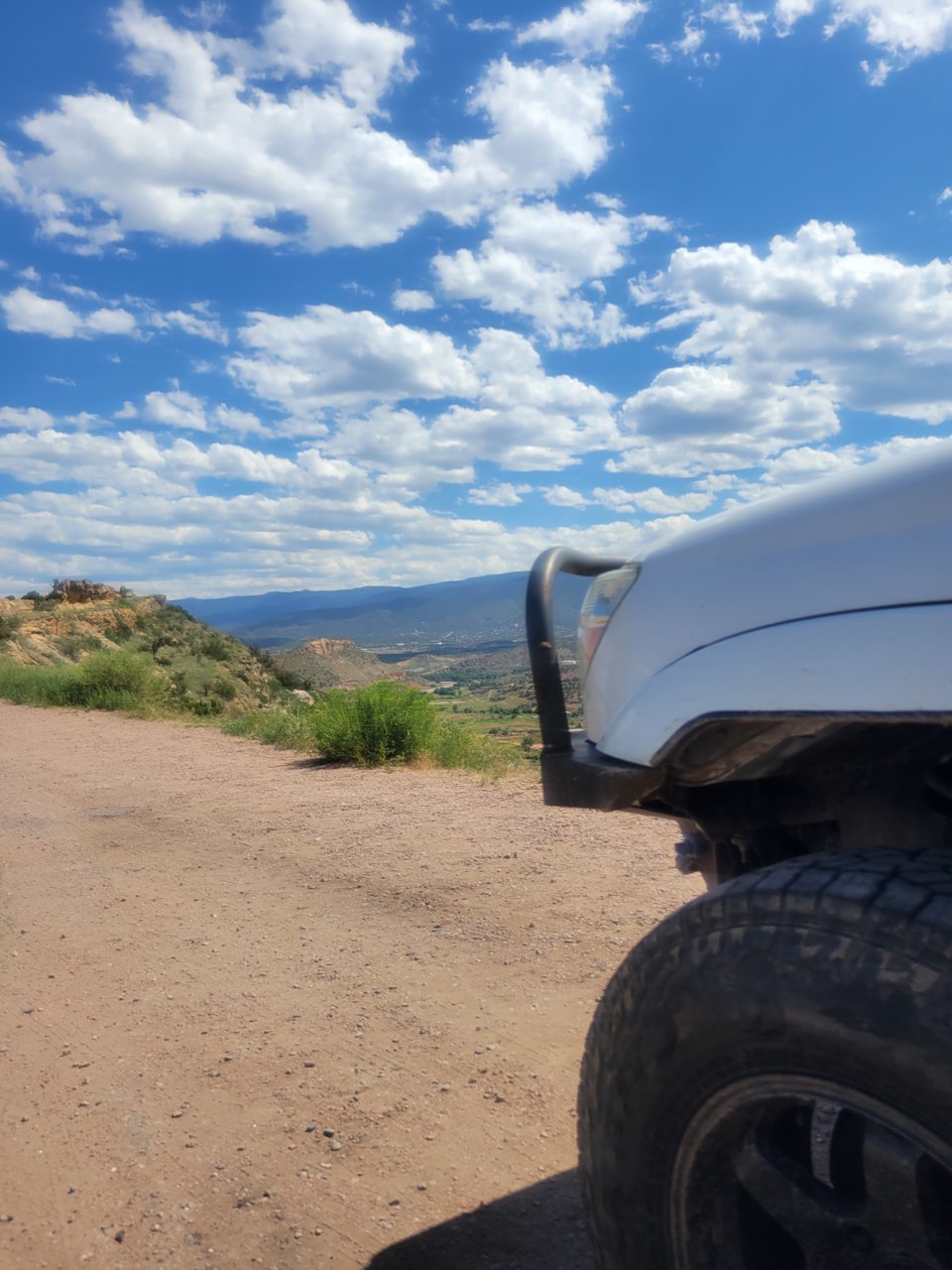

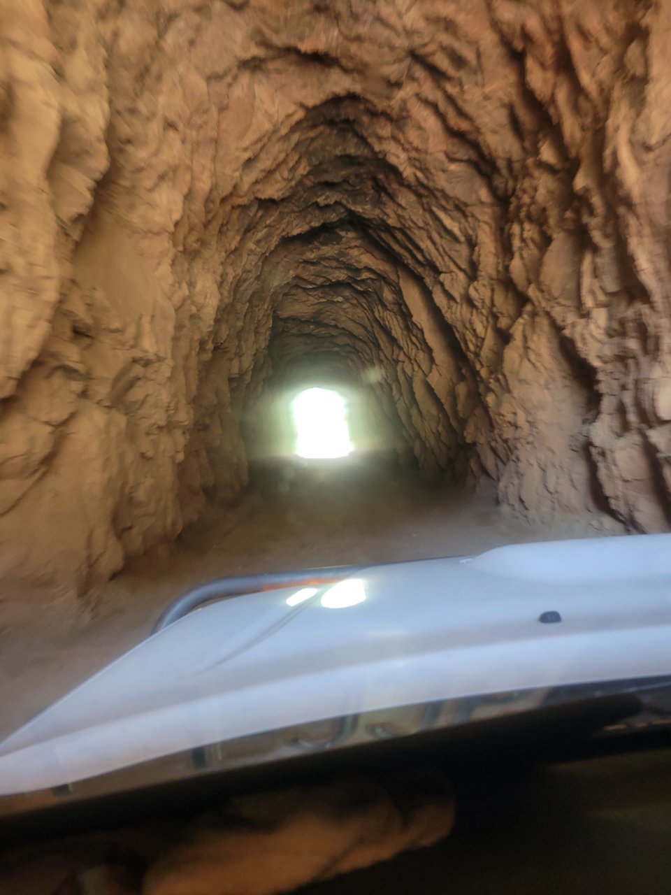

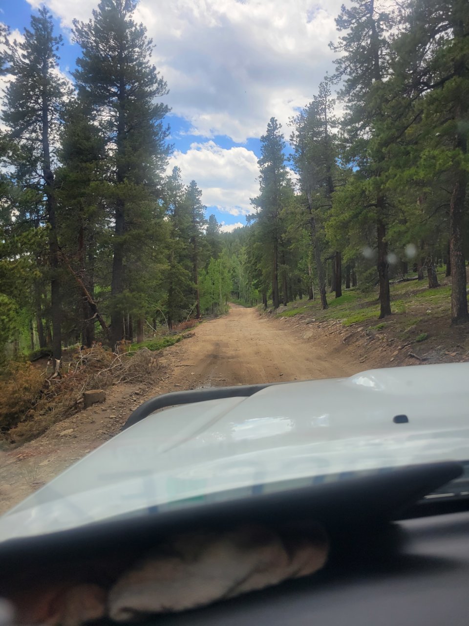

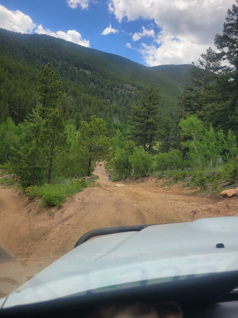

    Trails we did in Colorado. It was a vacation first and foremost so the trails were a secondary thing, so not much to report.

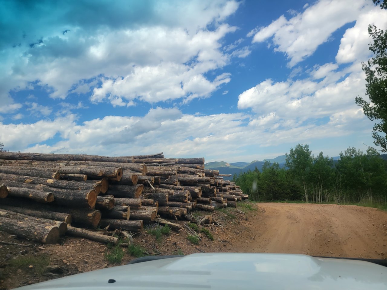

    Slaughterhouse Gulch Trail Colorado 7/9/23
    Was a firewood permit area with a sweet offroad trail deep in the woods. I have a video to edit and upload eventually.
    Even let @gasparic104 drive a bit.

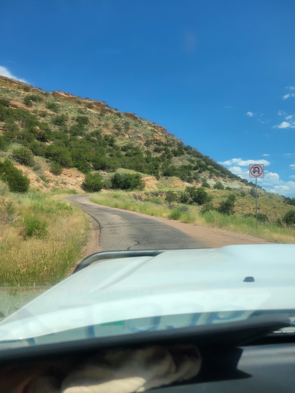

    Skyline - Canon City, CO 7/12/23
    It's a fully paved road that winds up the side of a short mountain range and then rides along the crest of it. Pretty neat at points where there's only a few feet to either side of the road before it's a long way down.

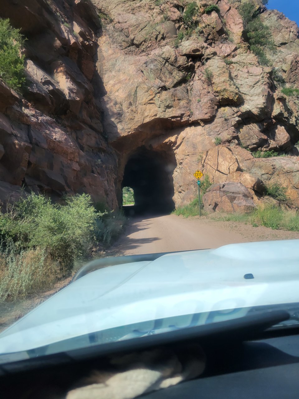

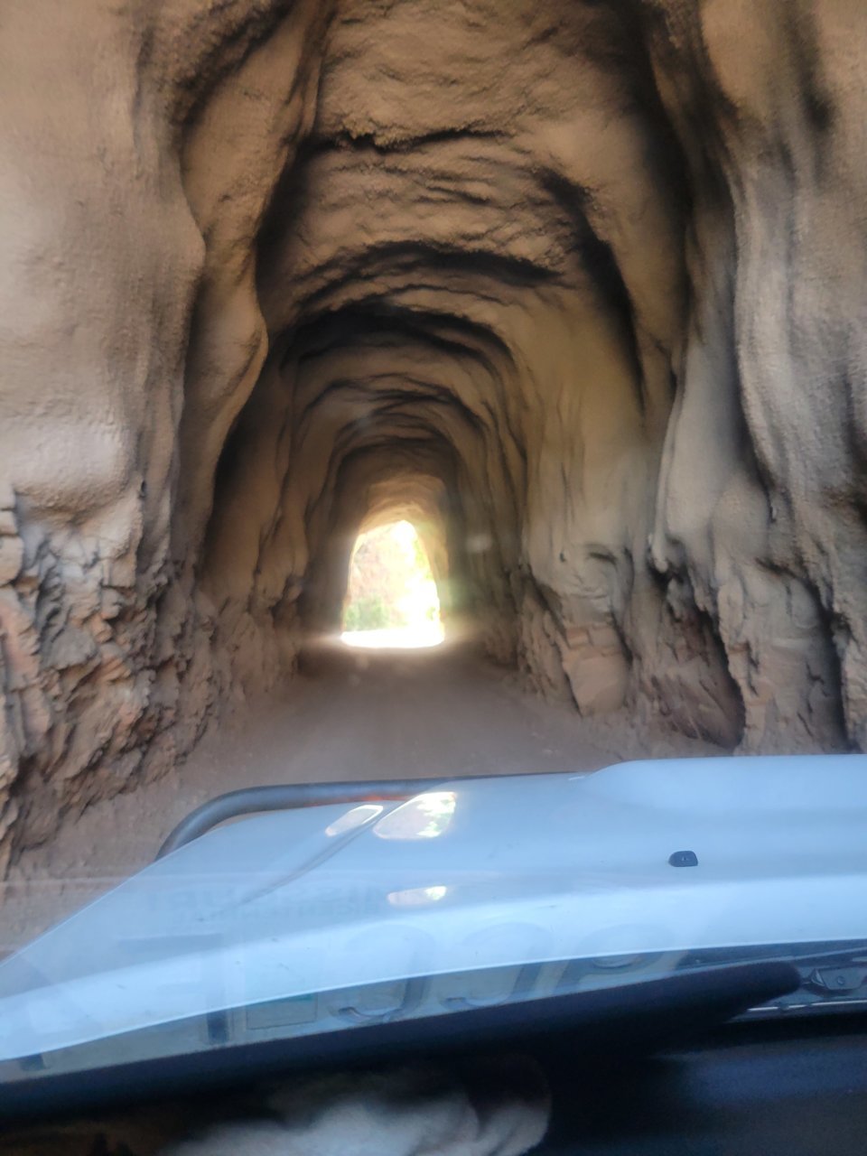

    Phantom Trail - CO 7/12/23
    Super neat dirt road through the valleys of some smaller Mountains including Nipple Peak. o_O
    Tons of permit camping spots if you get a permit to camp anywhere.

    What is it? Thinking about the same to watch trans temp when using for work.

    UltraGauge MX. Its the only one that you can get to the Manufacturers code for the Transmission Pan and Torque Converter temps. I wanted it for long trips, so I could monitor the trans. Bonus benefit of making me drive more conservedly. Have gotten mpg up to 18.
    Buy it, its 104 shipped. And have it preprogrammed to 2005-2011 (closest option for me), you'll have to manually adjust m codes 4 and 5 to get it to read on 12-15 models.
    I missed a setting so the trans was in Celsius in this photo. Fixed now.

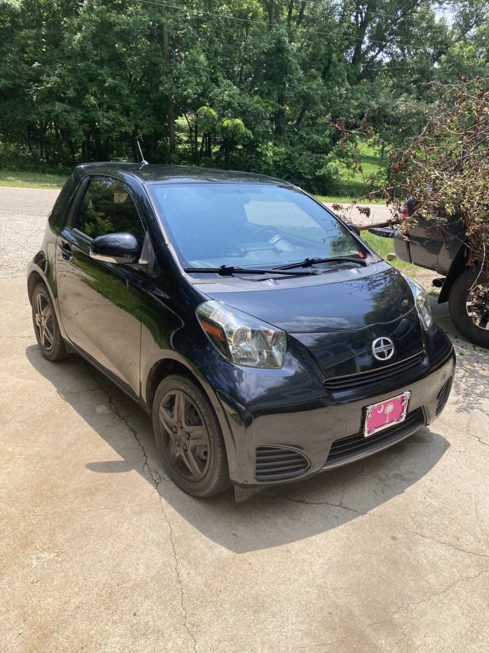

    So a little over a week ago, my wife and I were talking about how I need a daily driver. Somehow we got to talking about those little Kei trucks, which got me going down a rabbit hole. Now I've convinced myself I need a 96-98 Daihatsu Hijet, am going to Nashville to test drive a few of them as well as other keis to see if I fit, and am talking to a guy in Oklahoma who's got one for sale with a 'new' engine in it... I've also started researching importing one to fit my tastes as almost all of them stateside were imported to be UTVs and are all 4x4, which isn't the worst, but when you're trying to get a 660cc engine up to highway speed the extra weight doesn't help! I also went down the rabbit hole of even seeing if my state would title it, and after numerous mixed reports from the internet, I got in touch with a few locals that own them and are titled up and running around the state. I started talking myself out of it when thinking about sourcing parts, since they aren't exactly on the shelf at Oreilly's. I've been following a guy with a similar model on the Mini truck forums that's been picking through his and replacing and repairing parts and his process in sourcing them, so I'm a little less worried about it. If the crap hits the fan, I could always just throw the engine out of a US market motorcycle, atv or snowmobile in it. Seems pretty easy to swap with a welder and time since the bed just comes off with a couple bolts and the frame is totally open afterwards. The main part of the engine you sit over and the seats fold up and the shifter assembly also can fold up as it's all cable driven, so you get total access, albeit a bit cramped, to the engine. These things run on little 1l 3cyl engines and come in either a 4MT or a 5MT and for me the 5MT is the only way I can comfortably cruise at 60mph. (The 6MT tops out at 81 in the Daihatsu Hijet)
    Stateside Purchase at a dealer = Easy, titled. Expensive...
    Stateside used = Cheap, already here. May not be titled, which can make things difficult...
    Import = Cheaper than a stateside dealer, much more involved. Though the hard stuff you can find a broker for. I have a line on a guy my friend used to import his Honda Wagon.
    To make a long story short, I'm crazy. I got the itch for something weird and interesting to drive and now I'm sitting in a hole of excitement that may or may not pan out. Otherwise I'll be driving the beater 03 Corolla that for some reason I despise. I think it's the paint color, or the fact its BORING. My whole life I've been interested in Japanese cars, but then I got into off-roading and I won't let that go either. Now that I have the offroad adventure vehicle, I want something to street around in that's not something that doesn't bring me smile to drive.
    Hopefully I test drive these things and I hate them and then I can move on. :rofl:
    My name's Josh, and I have a car problem. :help:
