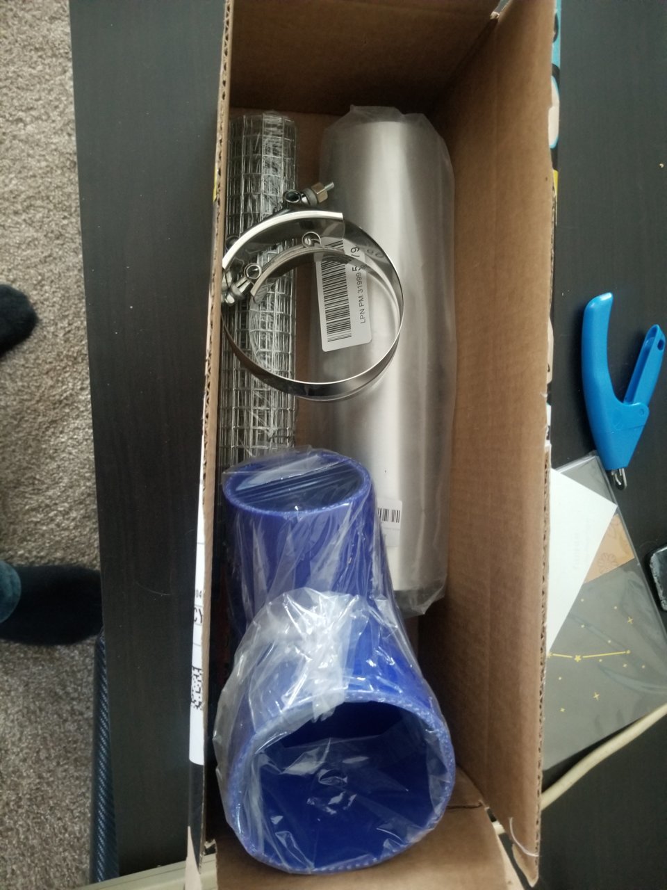

    I gotta get finer mesh. The stuff in the picture is like 1/4" squares and won't stop anything but big debris. Tired of pulling my cabin filter and it being covered in tree crap. Plus I gotta mesh both ends of that section of cowl to prevent anything coming into the intake too.
    Buying a new hole saw just for this and not cheaping out this time. Hopefully no ER visits *knock on wood*

    Another mod done. Glad I wont have to worry about the rain and mud in my wheel well getting sucked in anymore.
    Wish I couldve left out the smog pump. Look at all that extra space.... couldve relocated the winch controller there and no ziptie it to my rad hose.....:anonymous:
    Took a lot of restraint not to yeet that thing...
    Take note of my custom Extra-Reach Bolt Extractor™
    No going back! Also did a 1inch hole on the left inner side of the cowl for extra air flow.
    First test fit, perfect. Ran to Home Cheapo and got some extra tools, since tools are nice. Particularly a file set since I needed a round file to clean up those edges.
    Didnt hook back up the SAIS pump and it ran fine so :notsure:
    After I started it back up leaving the store though....
    Its weird that it disables traction control? Still ran fine but I reconnected it and cleared the code for now. :burp:
    Couldnt find any black paint to touch up the gutter mesh I used after I cut it so blue it is.
    All done. I use fuel line I cut to make a grommet so the pipe doesnt rattle and I cut the pipe at an angle starting the middle of the od just get a little extra air. I formed the mesh around the pipe before I cut it so I got a nice round sleeve that I just ziptied on nice and tight. Its also wedged against the mesh on the cabin intake so its not moving.
    Was a fun project and went pretty easy. Stabbed my thumb while forming the mesh but beyond that no injuries to report. Blew up about 12 cutoff dics for my dremel. Things are junk and super brittle so yeah....:annoyed:
    Cheap, easy and better aesthetically to me than a snorkel but if I ever decide to get crazy with my build I might make the switch. For now, this works great and cost less than $100. Budget baby!
