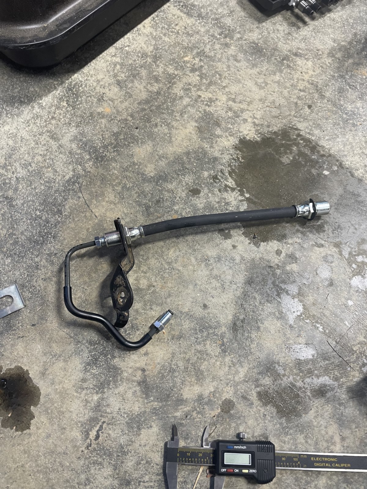

    Got all the slave cylinder parts in. I have a question? In the photo is the new parts but I have no idea where the bracket goes or what it bolts to?
    Any idea and on the small metal line that goes to slave cylinder, does the rubber protective hose on the metal tube go to slave cylinder or opposite of slave cylinder. I had generic parts on before and these are OEM so nothing to reference it to.
    My photo shows protective rubber end going to slave cylinder
