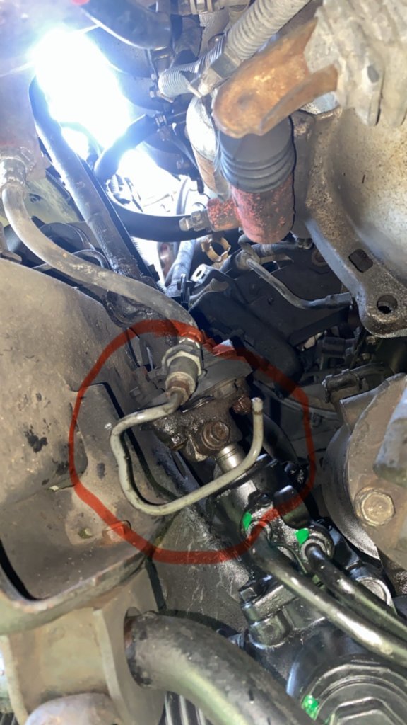

    This hard line broke causing my clutch pedal to lose all pressure. The pedal moves in and out freely and I can’t shift out of neutral. I can’t find where it broke off at or what the exact name of this part is.
    Checked O’Reillys advanced Napa and none of them can figure out the exact part with the hard line

    It looks like you will need to replace the hard line. It goes to the pink or red painted slave cylinder. Its a 10mm x 1.0 pitch fitting on 3/16 or 5 mm brake line. Oreillys should have a universal replacement that you will have to bend yourself into shape. Check Oreillys part #PAJ308. I also think there is supposed to be a bracket to hold the rubber portion of the hose also. Hope that helps.
