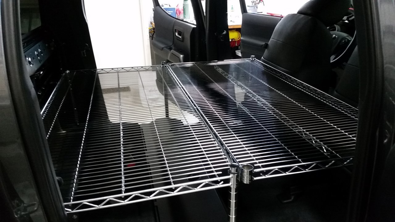

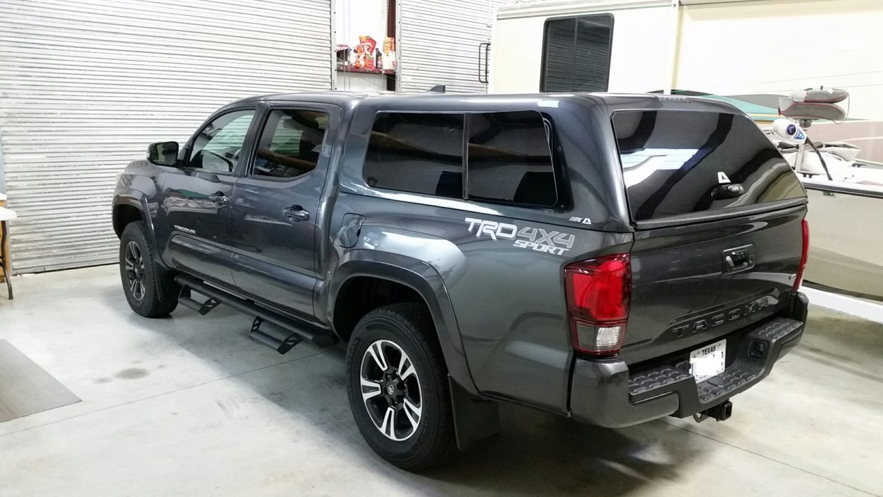

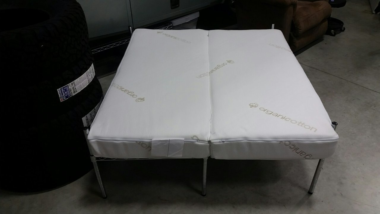

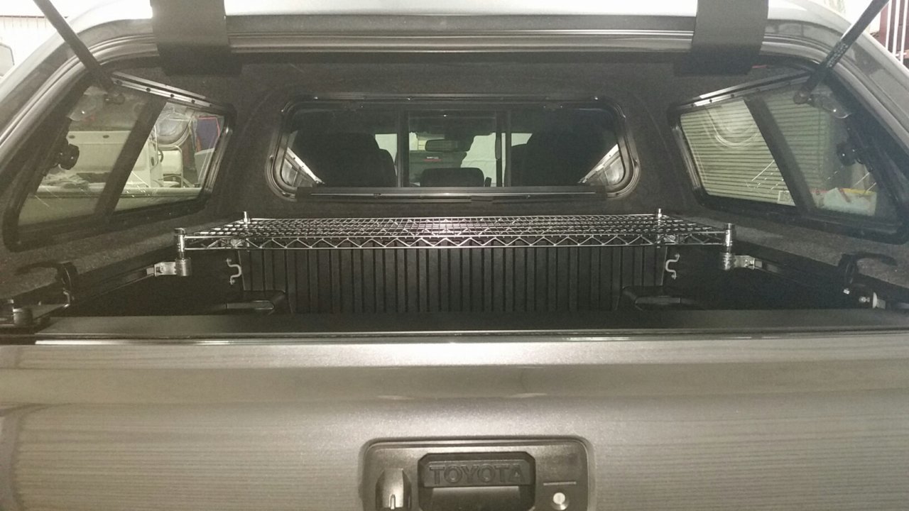

    I second the hammock under quick-pitch tarp. I can fall asleep fast in a reclined vehicle seat, but it doesn't last. After about 45 minutes I wake and from then on I wake every 15-20 minutes. The next day I carry with me the effects of sleep deprivation. Makes for a shitty day. Sleeping in a truck seat is its own kind of hell, regardless of the testimonials above. Done it. Too many times. It can be done, but why? The next day you are going to feel like you been eat by a wolf and shit off a cliff. Conversely, two lines quickly secure a tarp to two trees. It's quick. I know, I do it. When it is just me the hammock goes under tarp. Elevate one side of the tarp and you can pull the truck bed under the tarp and cook. Hammock is always level, and more comfortable than a memory foam mattress. Ten minutes max. Five when you have experience doing it. It's easy. And then you are comfortable. I went three days straight in an off-and-on torrential rain in that hammock and lawn chair under the tarp and when it was done there was still a dry spot on the leaves under the tarp. When it's a group we string a 20x30 tarp and have enough room for a tent, fire and kitchen with multiple truck bedcaps inside dripline of tarp.
    When it is too hot for a hammock and tarp, or no trees, or too dangerous, or time is short, THEN get in the cab. 48x54x5 memory foam mattress that folds for storage while traveling, lays out for sleep. (Makes a great padded, sandwiched place to store a rifle while traveling!)
    I lay diagonally and there is more than enough room for me. I'd estimate up to 6'5" could sleep diagonally on it and be much more comfortable than in a reclined front seat. Cab is air conditioned by a 6000Btu window A/C with remote control. A/C is secured to wire shelf under bedcap, blows through slider into cab. A/C condensate drains through condensate fitting in bottom of A/C, down a clear vinyl tube threaded through a hole in the bottom of the bed. Powered by Honda EU2000 generator. Sleep comfortably up front, and thereby conserve ALL of the bed area for camping equipment.

    You can create a great platform like that with Metro wire shelving and some short posts. Must remove the front seat on 3rd gens. I did it but found the 22 inch width too confining. Then I hit on the 48x54 combination using only the back while keeping the front seat for possible passengers. Some of the second gen passenger front seats laid down flat folded forward and you could do that. I have a buddy with a 2nd gen who built an L-shaped platform and kept the front seat but deleted the rear seat. He sleeps on a 4-inch memory foam mattress laid glovebox to rear bulkhead. I'll see if he will send me some pics to post. Hell, that's how I came to this Taco: I got tired of waiting on him to sell me his. 656 miles from Birmingham to here. Drive that Taco over here and I'll let you sleep in all of my hammocks. There will be two ENO's for sale when you are done! Or attend a hammock "hang" (get-together) in your area. Every state has a hammock community that has a hang at least twice a year. (Awesome feasts.) The purpose of these is to let everyone try out everyone else's hammock. (And they have these hangs in some nice, remote places you'd like to take that Taco.) Florida is the best of all of them. If at the end of the day, when you are beyond exhaustion from exertion, if you get into your hammock and you do not start laughing involuntarily and deliriously, you are not in a comfortable hammock. We fish hard, all day, and when we finally get in them, we all have a good delirious laugh from the onset of the comfort. Sounds nuts, but it happens. And it is a GOOD laugh too! Just a bunch of totally exhausted, delirious idiots, laughing our asses off together, feeding off each other, for no reason at all other than the onset of the extreme comfort. Great way to end a great day. I am serious as cancer.

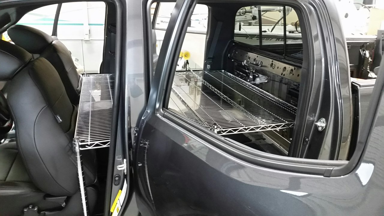

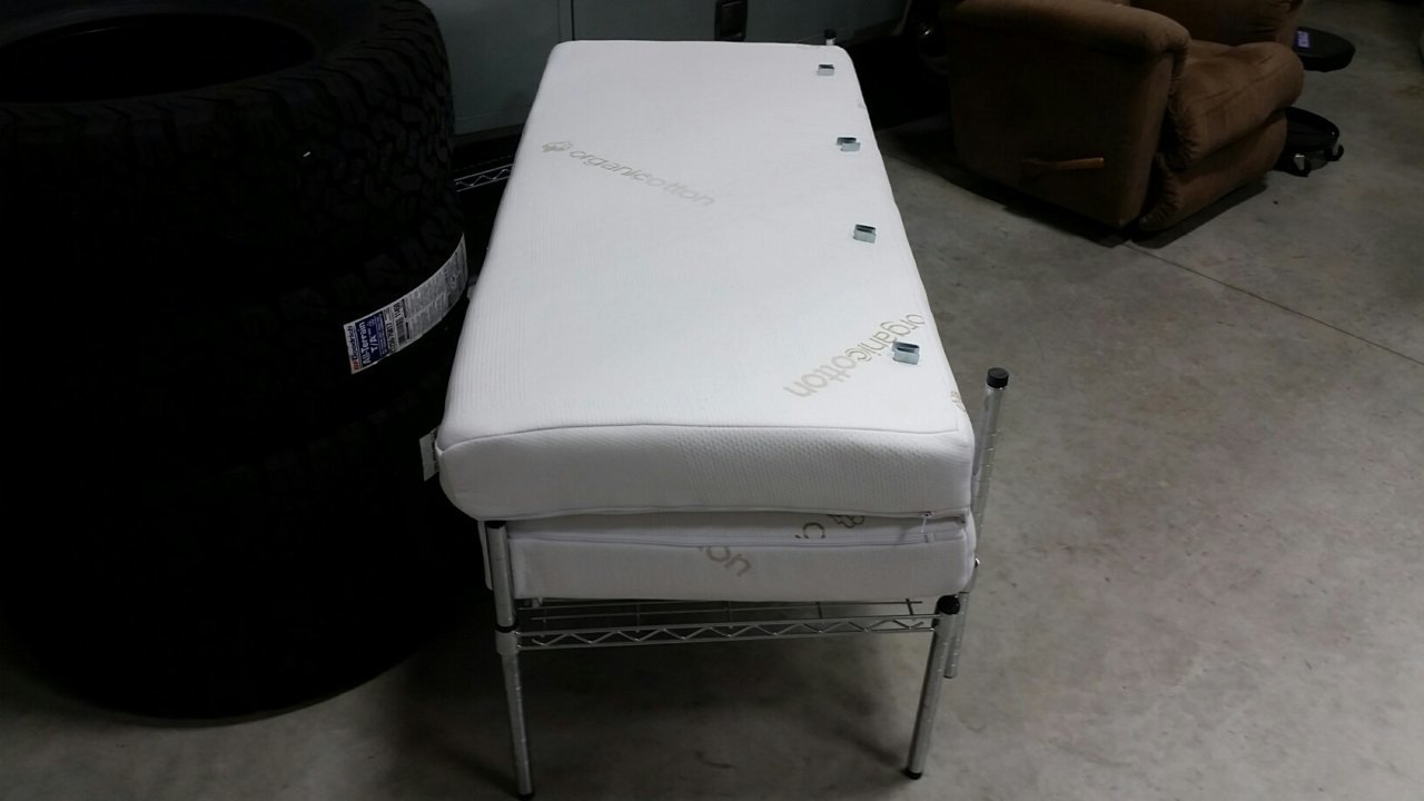

    Had a lightbulb moment: Leave the front seat in, take out the BACK SEAT and replace with this:
    20181221 - Cab sleeping platform, 48W x 54L, (two 24x54 Metro Wire shelves), driver's side.jpg
    20181221 - Cab sleeping platform, 48W x 54L, (two 24x54 Metro Wire shelves).jpg
    MUCH quicker to set up than a tent: slide seats forward, pull front half of platform forward, off of back half of platform, unfold custom gatching memory foam mattress with sleeping bag already folded inside of it. Get in, say your prayers...
