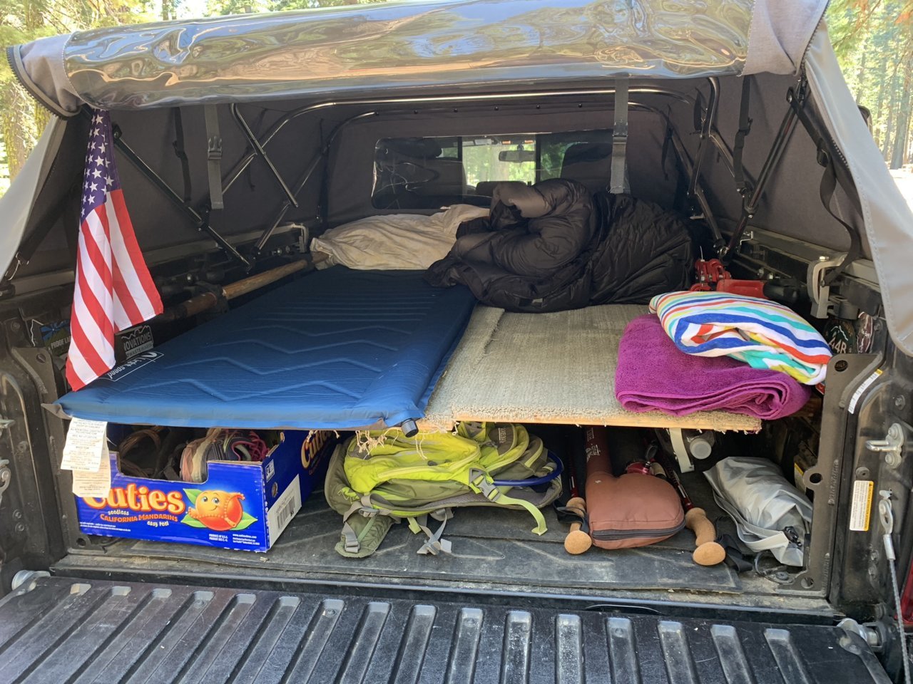

    5A7495F0-1A3E-4065-AB4A-892061A3BB52.jpg Here’s the setup I just put together. Turfed the bottom too for my surfboards.

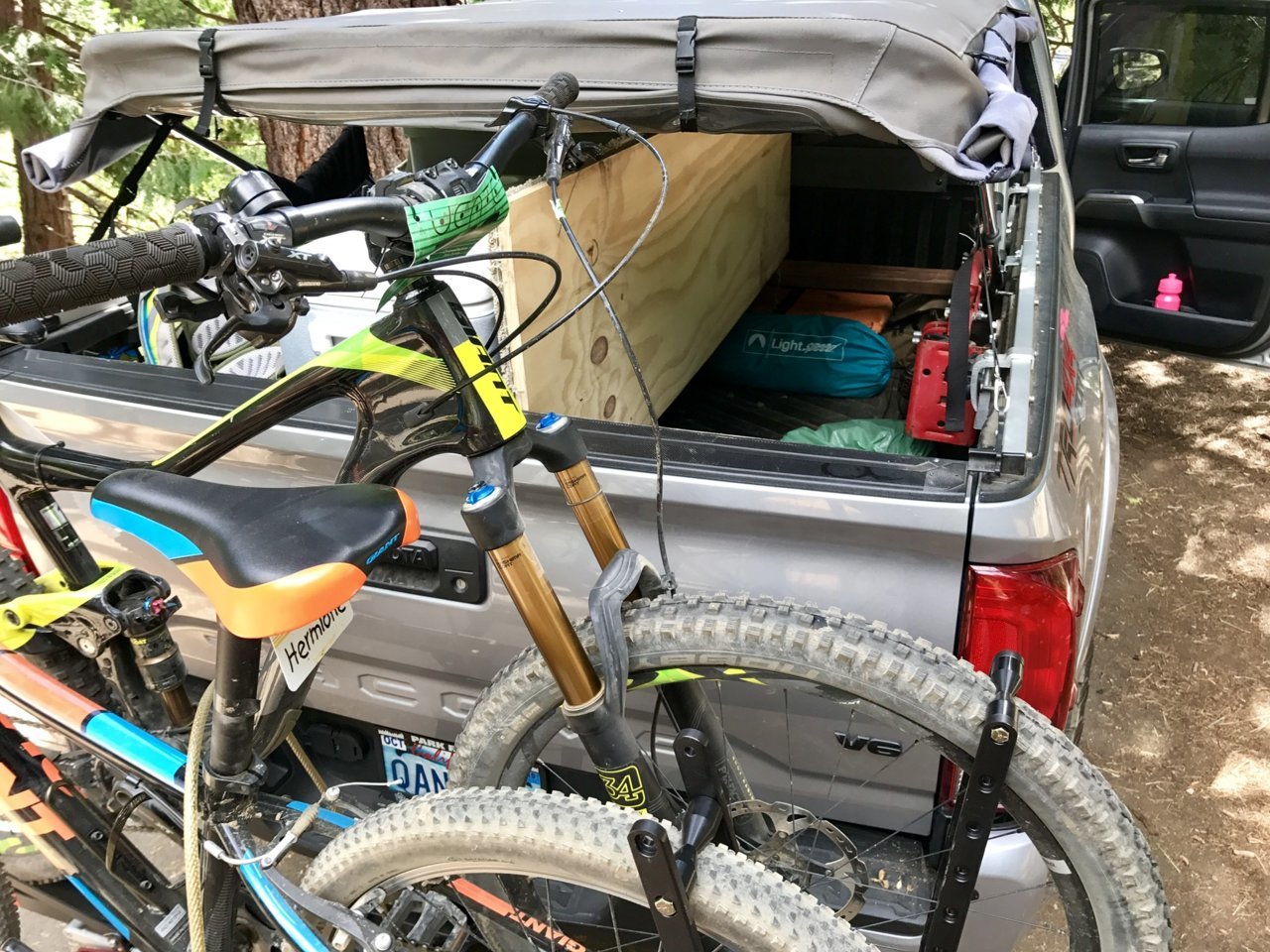

    Here is my setup. I did mine in three panels so I could stack them by the cab when not in use.

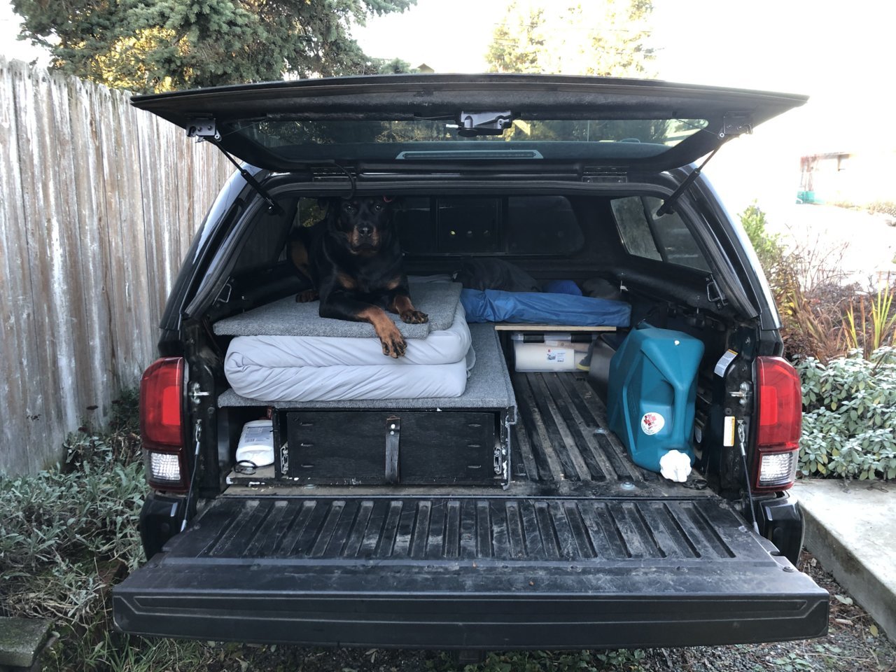

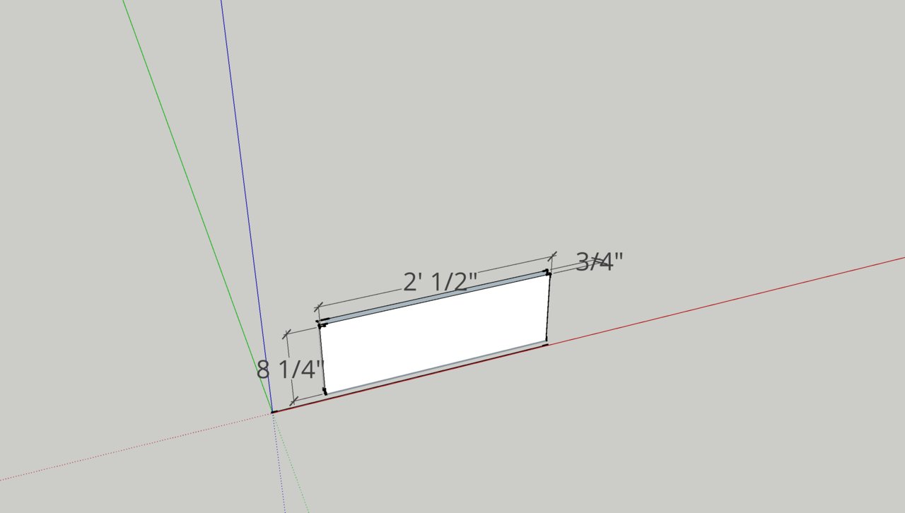

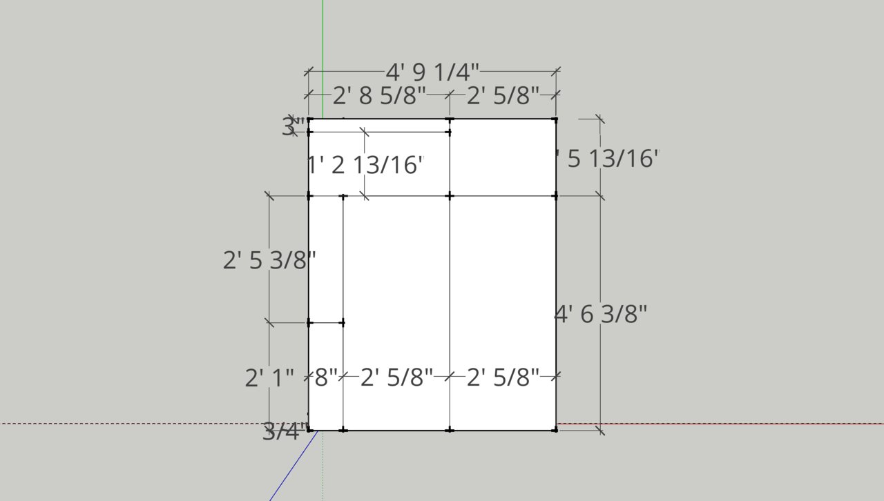

    I built mine out with a drawer system where one side is fully open to the bed, plus an option to go full width of the bed with my sleeping platform. Roughly designed using SketchUp and then called a few audibles on the way. Basically just using 3/4in plywood. It's decently heavy and given some changes in my requirements (new kid, big dog and her crate have to ride in the back now...) I'm planning a V2, where I'm thinking about using 80/20 as my structural material.
    here are some quick screen grabs of some of the measurements.
    Sorry for the huge images?

    here's the best picture I have of it right now. drawer is 4.5 feet deep and on 4 foot long, extra heavy duty (500 lb) full extension slides.IMG_3643.jpg
