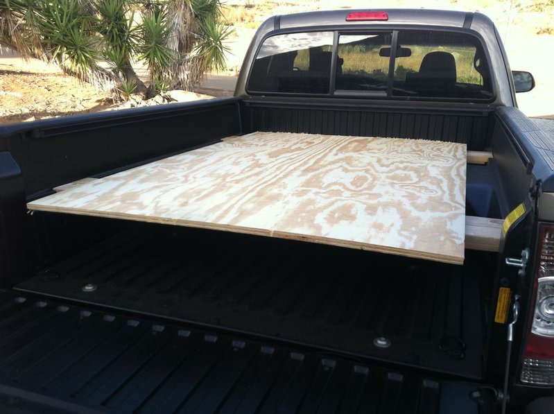

    OK, I got her done. I used two 2x4's in each slot and they fit quite well, and a 3/4" piece of plywood (4'x6'). I'm going to attempt to insert or attach a photo a photo.

    Forgot to mention - 57.25" was too long for me. 57" or 57 1/8" is as long as I would go.

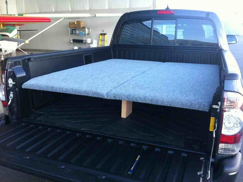

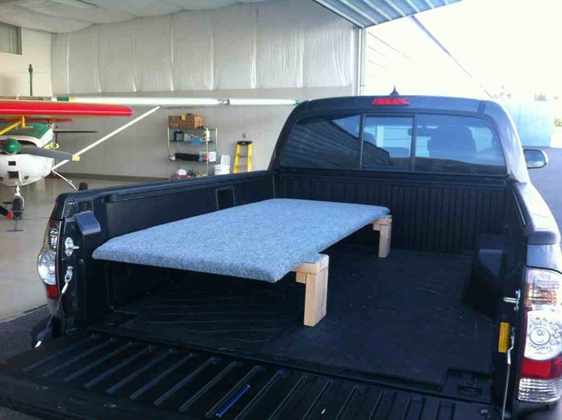

    Got any pictures of that?
  20. Jul 10, 2013 at 6:48 AM
    #80
    Speck
    Speck Well-Known Member
    Mar 13, 2013
    #99613
    65
    Tejas
    07 2.7 4x4
    here you go, also my first attempt at uploading a picture... so...
    I will eventually make a thread that shows the pictures along the way, but this should get you started. It is 3/4" cabinet plywood, which is much stiffer than regular. It is built in three drop-in sections, with the rearmost section being a few inches wider and notched to accommodate the shape at the end of the bed.
    I am only 150 lbs, but it doesn't flex more than a quarter inch or so. I can always add cross-members in the notches, but there is no need to at this point.
