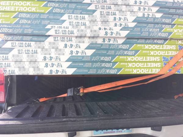

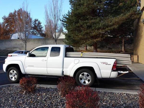

    Just successfully hauled 30 sheets of drywall above 2 shaped pressure treated 2x6s in the bed notches. Pretty much did what OZ-T did, but just used a file to take away enough material on the corners of the wood to get it to fit - like a glove! I didn't notch them.
    Total weight was 1176lbs, so just under 600lbs per 2x6. They bowed down a bit, but not bad. I didn't even need to put a sheet of plywood underneath.
    I'm very happy about the bed notches in our second gens. Get some full-size truck functionality for ten bucks worth of lumber.

    Holy shit , that's a lot of weight , like 1500-1600lbs
    I wouldn't have trusted the bed notches or a 2x on the flat with that load
  19. Dec 13, 2014 at 4:31 PM
    #99
    OZ-T
    OZ-T I hate my neighbour
    Dec 15, 2009
    #27584
    50,587
    Peter North
    British Columbia
    Edit : just saw that it was lightweight drywall
