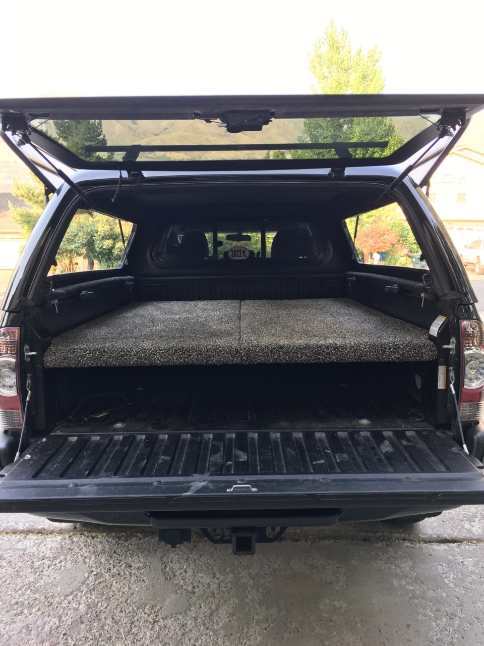

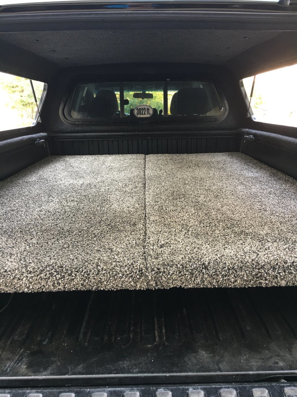

    Many thanks for posting measurements. Saved me hours, and I’m terrible with tools anyways. Dimensions were spot on. Here’s the finished product on my 2015 dclb. And yes, that is thick carpet on a half inch pad. Barely fits but oh so comfy.

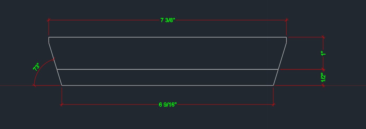

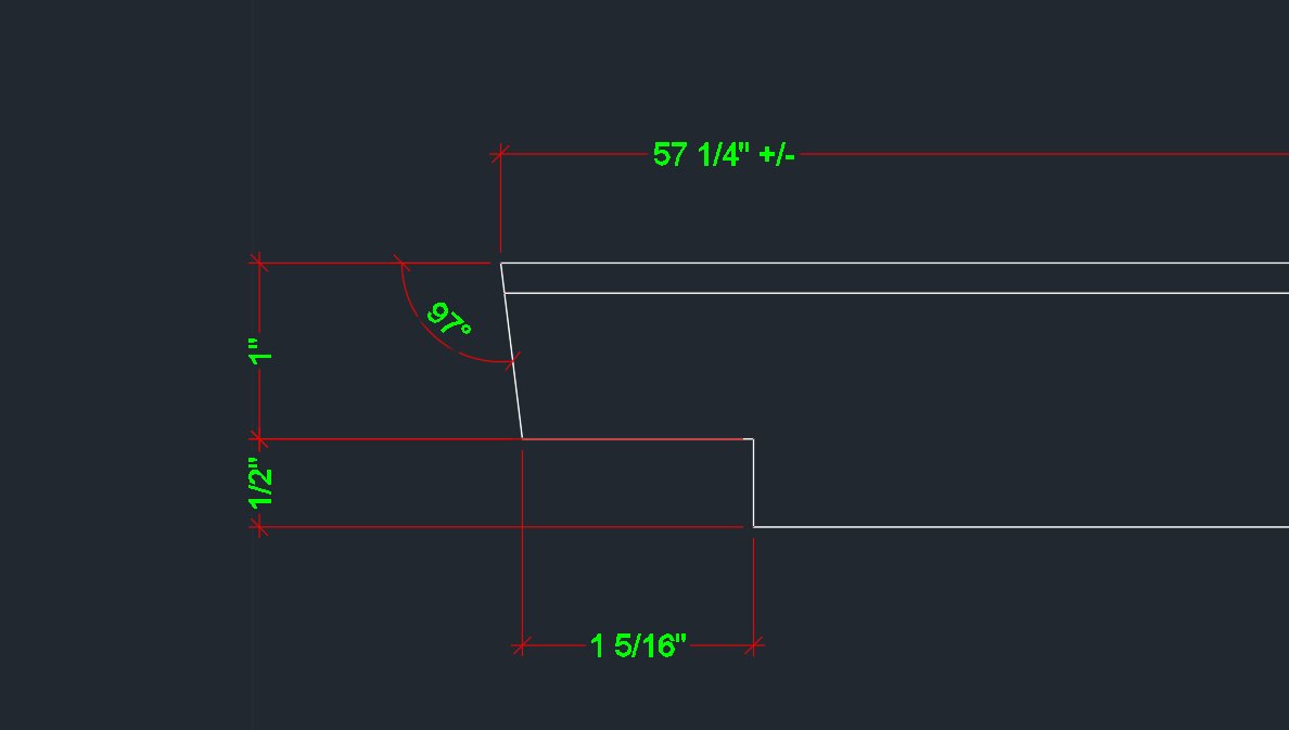

    Your dims on the the photo are tripping me up. I'm going off your numbers you have written and not the large area you have shaded calling out "remove this."
    Does this look correct below?

    yes , looks correct
    I see you have a 3rd gen , those numbers are based on the 2nd gen , not sure if it's the same

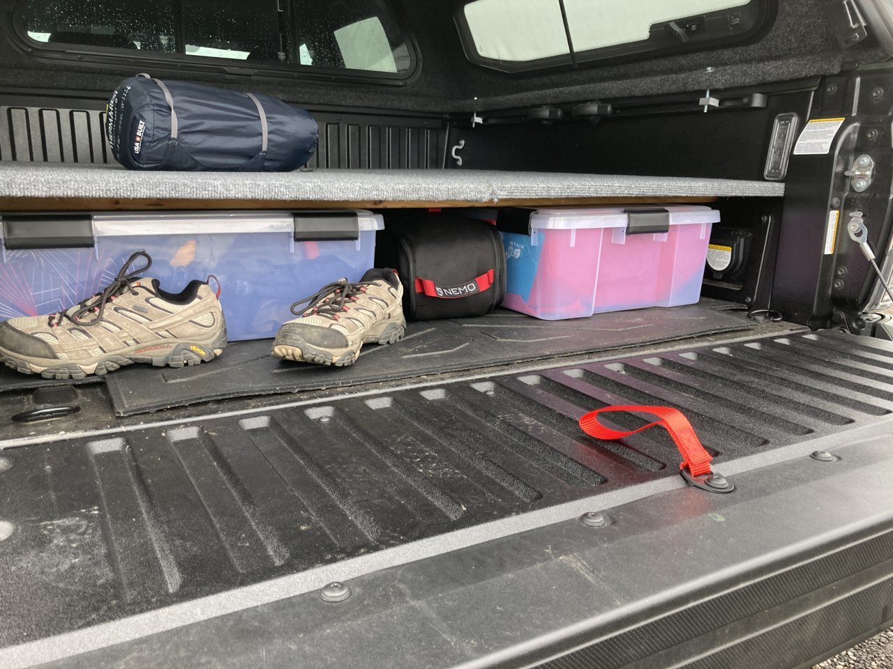

    When it’s time to close up the bed, and take a snooze.

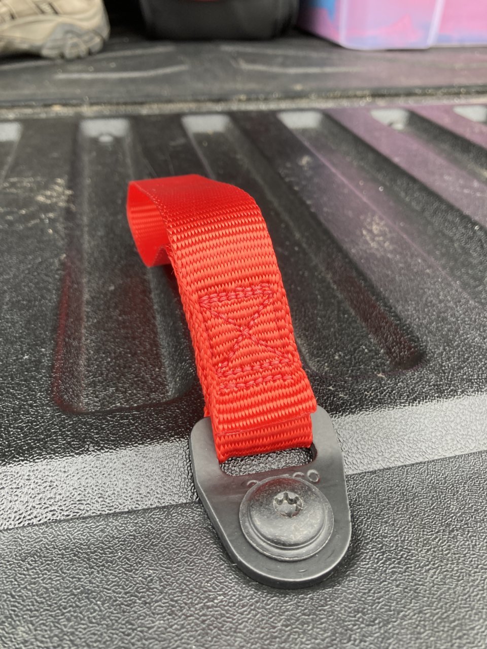

    Great solution. Where did you get this bracket?
