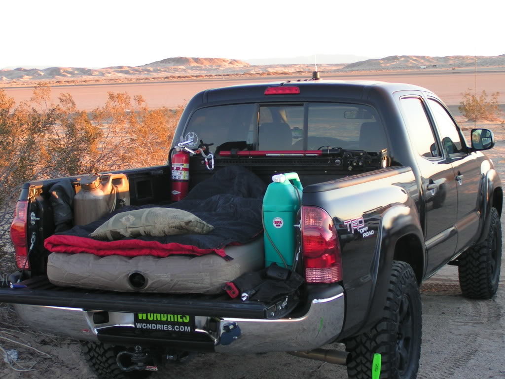

    in one of the climbing mags about a year ago there was a special on climbers vehicles. One of the trucks had a solid platform on top of his bed with hinges on one side and a piece of (wood?) folded out and over the side of the truck doubling the size of it and he put a tent on top of it. There was a few legs under the hanging piece for support.
    That way he still had plenty of room in the bed for all his stuff.

    ARB makes a tent that is designed to roof mount on SUV's I'd bet with some cargo bars in the bed or some 2x6 you make it work over the bed.

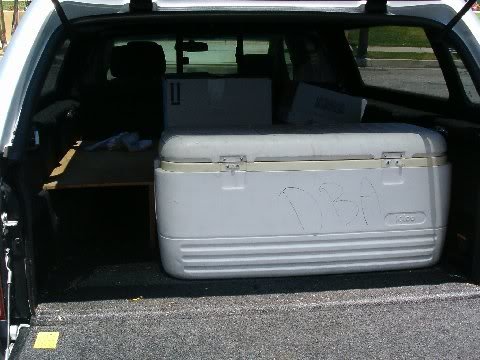

    here is my simple design - it's two piece so I can carry a cooler for work - the side piece fits over the wheel well and is screwed to the 3 sided box - [​IMG][/IMG]platform20for20truck20001_4123b9a1641d9c59c253ddbf83e9e18a3f602e09.jpg

    is that platform anchored to anything?

    Same idea, but why not just cut a 4x8 sheet of plywood to fit on top of the wheel wells. Put some T-shaped legs in the middle for support. You could add spacers on top of the wheel wells to get the platform as high as necessary.
