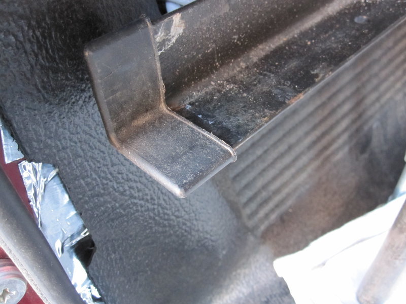

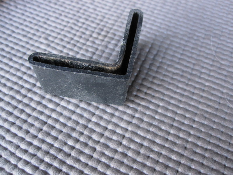

    For the sharp, protruding ends of the bed frame I bought, at Amazon, 1 1/2" GashGuards: Deluxe Plastic Bed Frame End Caps, Sheet Savers, Set of 2 at
    http://www.amazon.com/GashGuards-Deluxe-Plastic-Frame-Savers/dp/B005JS8ZKA

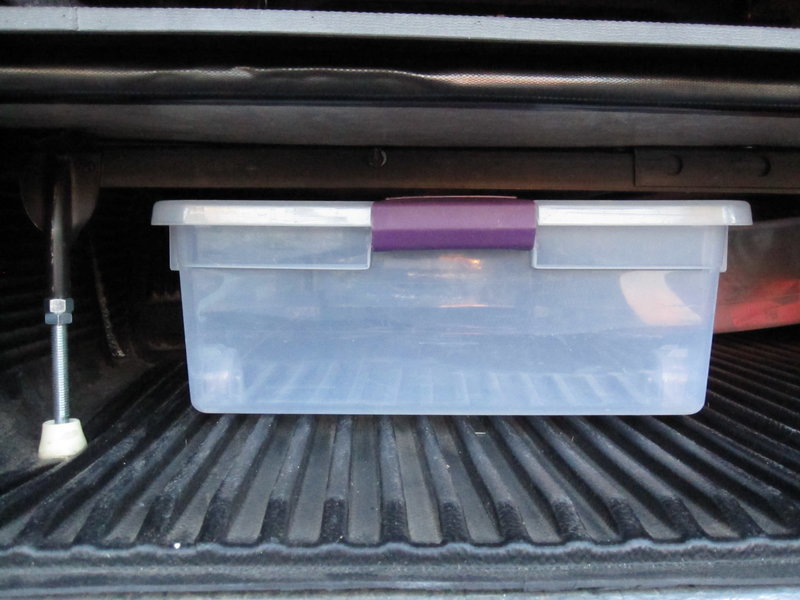

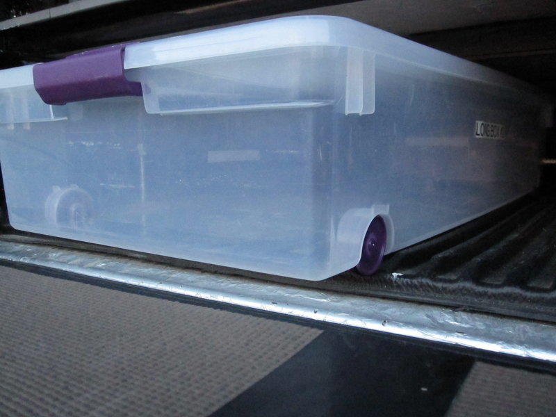

    Bought the same plastic boxes (at Target) you have, but the "underbed" variety, with rollers/wheels that track nicely in the grooves of the bed-liner, and do not significantly increase the height of the box, since the wheels are down in the recessed grooves. (Depends on whether your bed liner grooves are same width as the rollers/wheels; mine are)

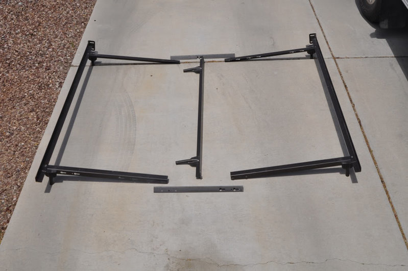

    I had a hard time finding just the right bedframe. @ScampTramp did a great job:
    (photo by @ScampTramp grabbed from http://s941.photobucket.com/albums/ad254/phlyphishers/sleeping platform/ )
    What makes this an excellent bedframe?
    1) Center rail with legs at the center, not just the corners. Mine had no center rail or legs, so I had to cut and drill angle iron to make a center rail.
    2. Very heavy duty angle iron. With the very rigid angle iron I did not need the center legs, which improved access to underbed storage. If I had his bedframe, I would cut the center legs off.
    3. Adjustable to the width of the truck bed. (Most bed frames are adjustable to exactly twin, double, queen, and/or king widths)
    4. He found it cheap! ($15 at Thrift Store)

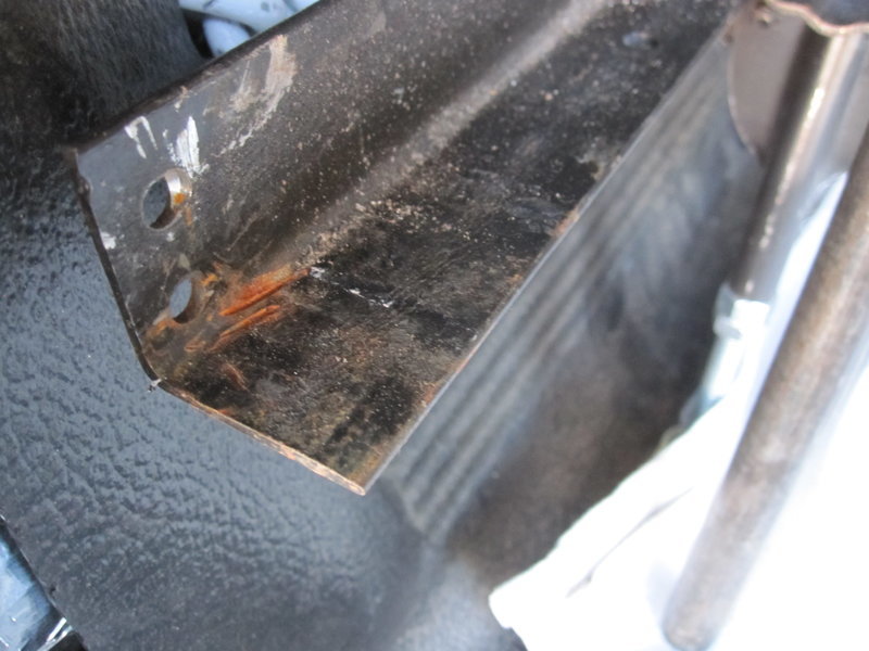

    MY IMPROVEMENTS:

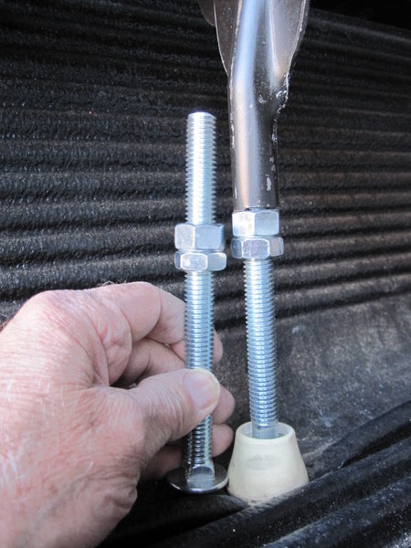

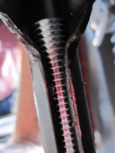

    1. I drilled out or cut off all the fasteners that normally hold a bed frame together, and fastened the rails together with short hex bolts, nuts, and lock washers. This allows you to spread the bed frame to the width of your truck bed for a fairly tight fit.
    2. For legs, instead of inserting hex bolts, I used carriage bolts with "jam" nuts to make the legs height adjustable, and a rubber chair foot.
    The bolt that serves as a leg is inserted into the part of the bed frame that normally receives a caster. That bed part is tapered and I drove the bolt in with a rubber mallet, until it bottomed out. The LENGTH of the bolt depends on two variables: a) the DEPTH of the bedframe foot and b)the HEIGHT that you want your bed frame. I wanted the frame to rest slightly above the wheel wells, but high enough to accommodate my storage boxes. This maximizes headroom on top of the bed. The NUT and the "JAM" NUT allowed me to make slight adjustments in the height of the frame. If the bedframe foot is not tapered, you will likely require the nut and the jam nut to adjust height. The DIAMETER of the bolt depends on the inner diameter of the bedframe foot; it should fit snugly and insert as far into the bedframe foot as possible. (HINT: if you have to remove the bolt, simply grab the square head with a wrench and unthread it. You don't thread it IN, but you can thread it OUT.)
    Carriage bolt leg with Jam Nut height adjustment for insertion into bed frame (3).jpg Carriage bolt leg with Jam Nut height adjustment for insertion into bed frame (4).jpg

    Sterilite® ClearView Latch™ 60 Qt Storage Tote - Clear with Purple Latch $15.99 at Target
    http://www.target.com/p/sterilite-c...-13794500#prodSlot=medium_1_14&term=sterilite
