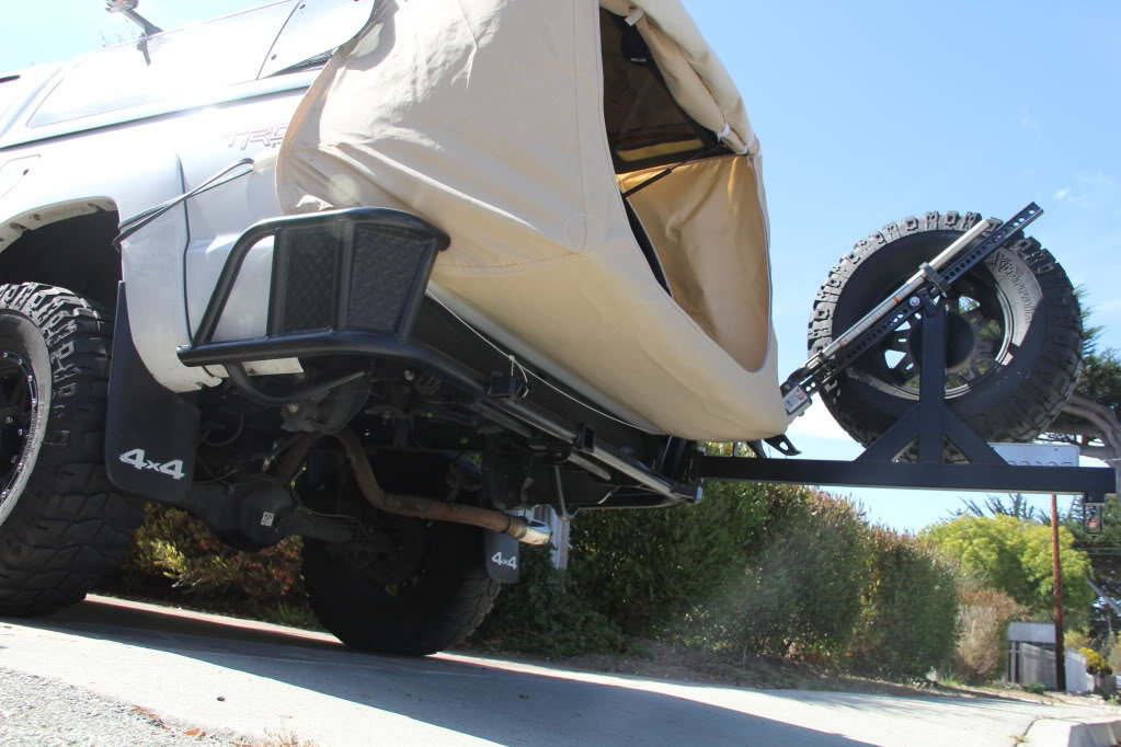

    Where can i find this end cap canvas thing?
