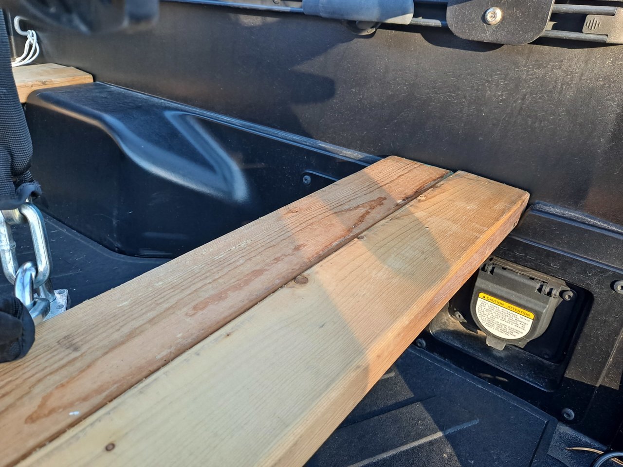

    I used 2x6s, however I needed to route the ends a little bit to get them to fit right. Plywood on top. The plywood to the right is sectioned as removable panels to access cargo while inside. Plywood needed to be cut at corners where the bed lights are.PXL_20220624_193203212.MP.jpg

    2 - 2x4's fit perfectly in the pockets.
