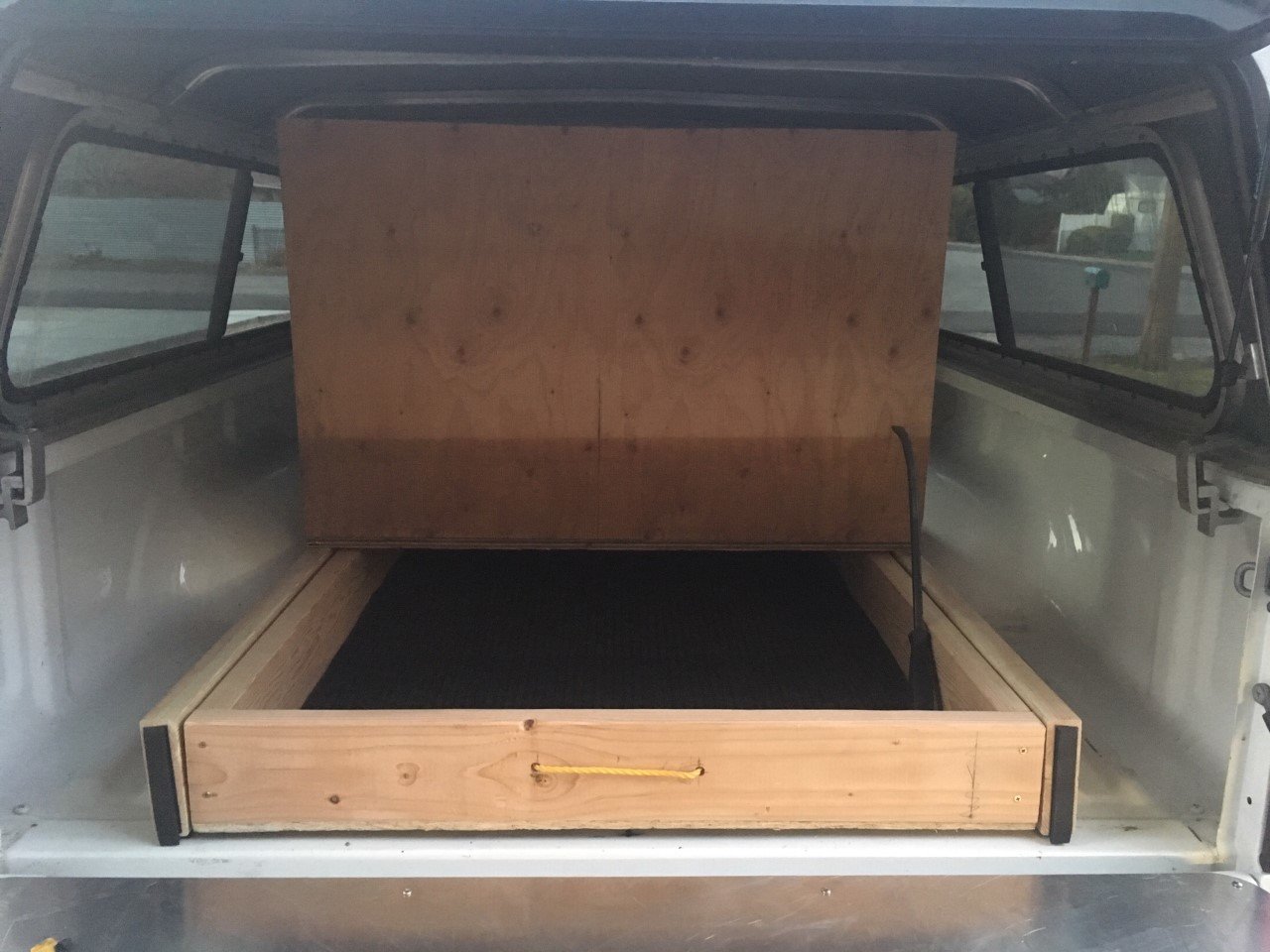

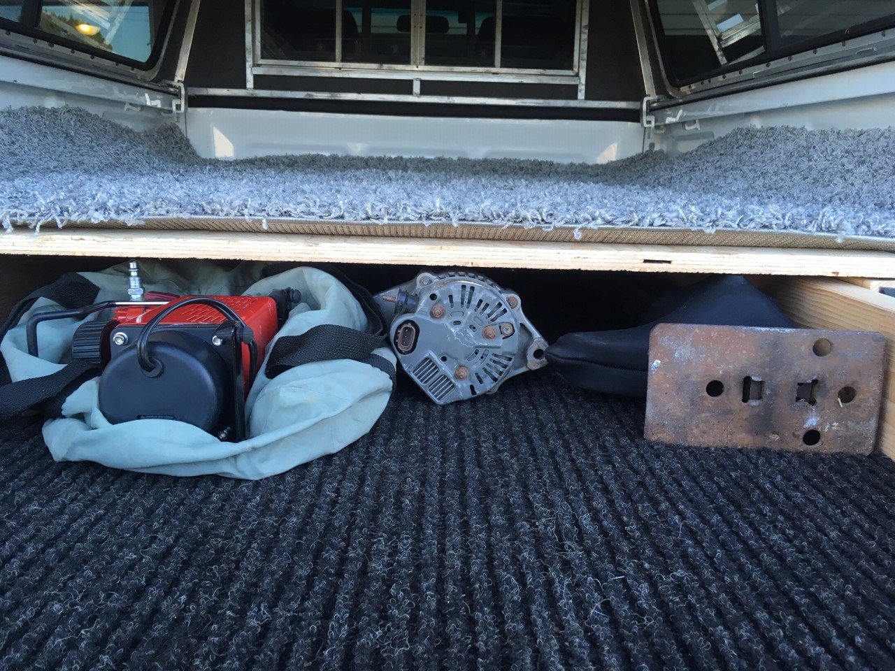

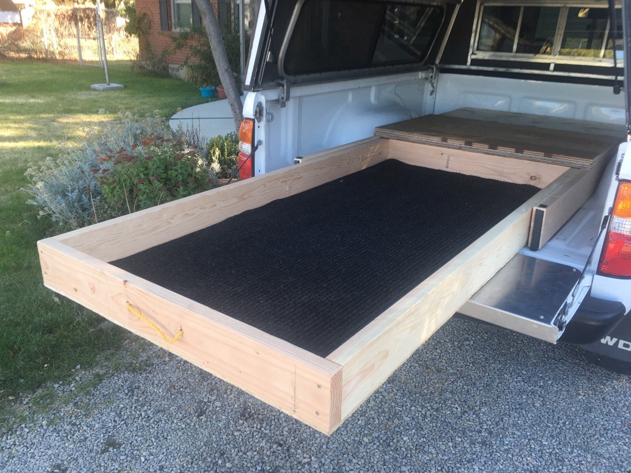

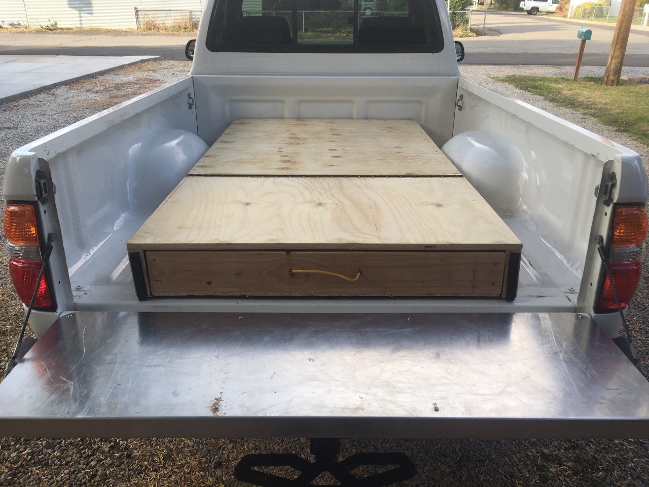

    Here are some more photos of mine. I got everything free from my dad's stash of home improvement leftovers. Otherwise I would have used lighter materials. I wanted it low-profile so I still have head room in my cab-height shell. Both pieces are super-easy to remove; nothing is permanently attached.
    I used weatherstrip tape on the bottom of the 2X8's that form the shell, so it doesn't squeak or rattle on rough roads. I also used weatherstrip tape on the front and back to interference-fit it in the bed so it doesn't slide. I debated making 4 foldable wings that conform around the wheel wells, but decided they would just make those spaces less useful. That hunch was confirmed when I set it in the back the first time, grabbed a couple jerry cans and they fit perfect in the pockets on the sides of the platform.
    The lid can fold all the way back without hitting anything.
    The drawer is about 4 feet by 6 feet, plenty of storage space. Here it's pulled out far enough I can reach all the way in while standing on the ground outside. The angle of the photo is odd; only about 20 inches of the drawer are hanging out past the tailgate.
    It's deep enough to fit the essentials: a hi-lift jack, compressor, spare parts, tools, propane bottles and my camp stove. I can't wait to sleep above my camping shit instead of curled around it.

    Please steal away. Had I needed to go out and buy materials, I would have used 3/8" plywood for the top, made the drawer sides out of 1X8 and put a divider down the center of the drawer to keep the top from bowing when I sleep on it.

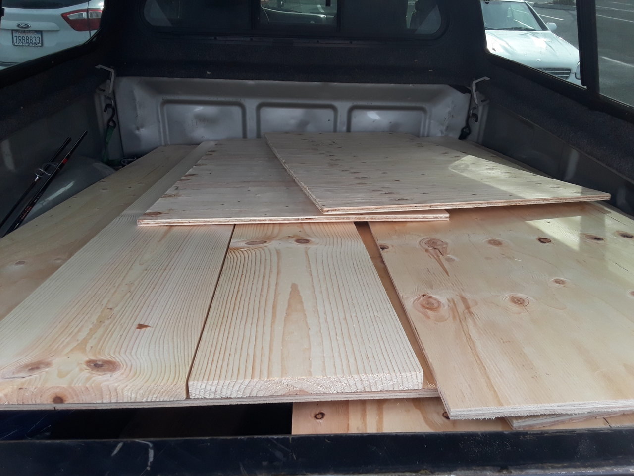

    20190117_122420.jpg got some supplies. And of course it down pours when I get home...ugh

    It wont be fancy. Just some 15/32 plywood and 1x10's. Then reinforced with some scrap 2x4's. I want to be able to pull it out fast, but still hold my fat ass up if I sleep on it..lol

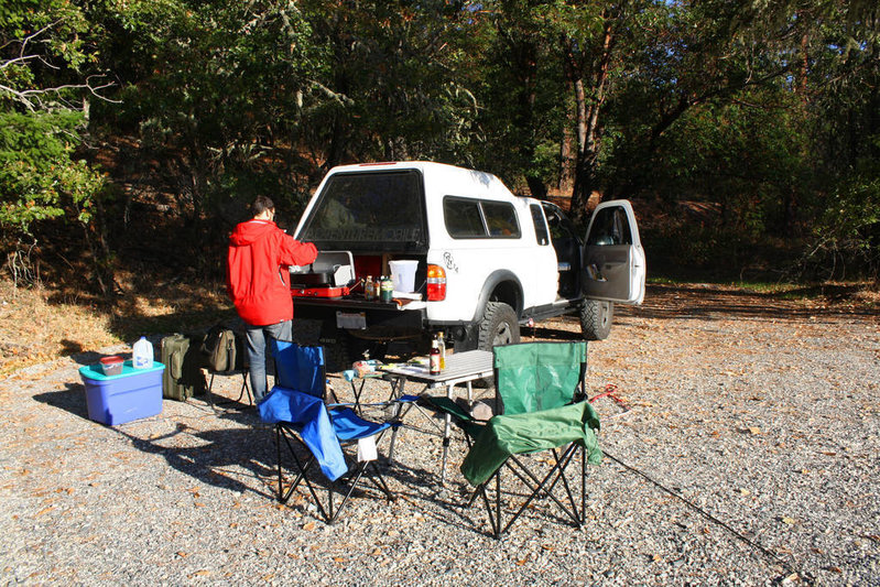

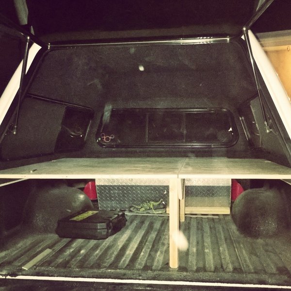

    This is what I came up with for my 1st Gen... Just a comfy cot and some action packers... Easy to set up and break down with plenty of storage
    In Action
    and some xmas light for the topper
