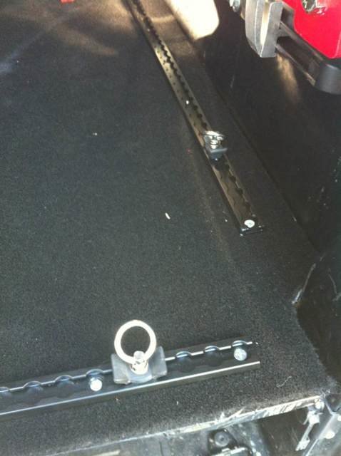

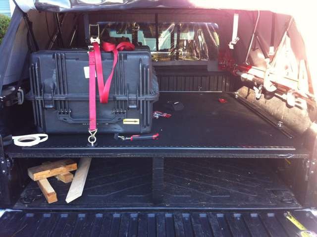

    I went to a local lumber yard. They had Russian birch that came in 60" width - nice strong plywood also.
    I ripped it down to 57 1/8" width and kept the length 60". I notched the edge (closest to the tailgate) where the bed comes in. Dropped it in and fit like a glove.
    I put carpet over it and some coretrax so I can tie things down with. http://www.realtruck.com/core-trax-tie-down-track-system/
    Got 2 sets of 48"
    The russian birch seemed strong enough and didnt move much even with me on it - but I still ripped a 2x10" down to 2x9" (60" length) and ran it up the center for support.
    Got 4 of these: http://www.containerstore.com/shop?productId=10026213&N=&Ntt=waterproof+totes
    Nice units, cheap and two slide in on each side.
    One day I may build sliding drawers - but I like that this setup is very easy to remove if needed.
    Wood and carpet - $100
    Coretrax: $150
    Containers: $80

  20. Aug 7, 2012 at 6:40 PM
    #40
    Wicked 2007
    Wicked 2007 Well-Known Member
    Dec 16, 2010
    #47770
    692
    Bay Area, CA
    2007 Tacoma AT DC SB 4x4
    2007 Tacoma Double Cab SB 4WD - Auto -TRD Off Road - Icon Billet UCA - 8" ORI Front Struts - Bilstein 5100 11" RCD Shock - AllPro Expo Springs - Demello Sliders - Tom Woods 1 Piece Driveshaft - 16x8 Mojave Teflon Rims - Locker Mod - Locker Guard - 35" MT MTZ's - ARB Bumper - Warn 8000 winch w/synthetic line - All-Pro Front Skid/Transmission Skid/Rear Armor - ARB Front Locker - Nitro 4.56 gears - Marlin 4.7 crawl box - Twin Stick FJ t-case - ATO high clearance rear bumper
    It happened:
