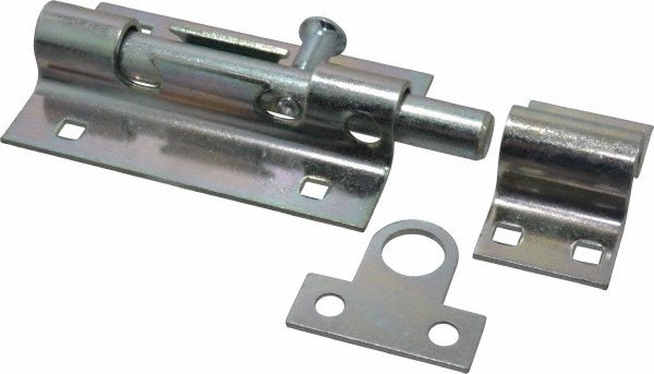

    Forgive my ignorance, but what does the pop-n-lock do? Is it redundant if your tailgate already locks? I love the sliding lock idea for the platform and think i'll use it - just trying to figure out if there is some tailgate idea ya had as well.

    The pop-n-lock is a locking handle that replaces the handle on your tailgate. I believe what he was saying was: combined with the locking tailgate, having two of the pictured locking mechanisms attached to the two halves of plywood, would allow you to fully secure what's underneath in storage.
    Without the locking tailgate, and only the pictured locks, you could open the tailgate and take what's from underneath it. On the flip side, with the locking tailgate and nothing connecting the two panels, a thief could easily just lift the wood apart with the same end result.

    Sweet, confirms what I was thinking. I have a lockable tailgate and will be building a platform like this. Definitely going to put in some slider locks!

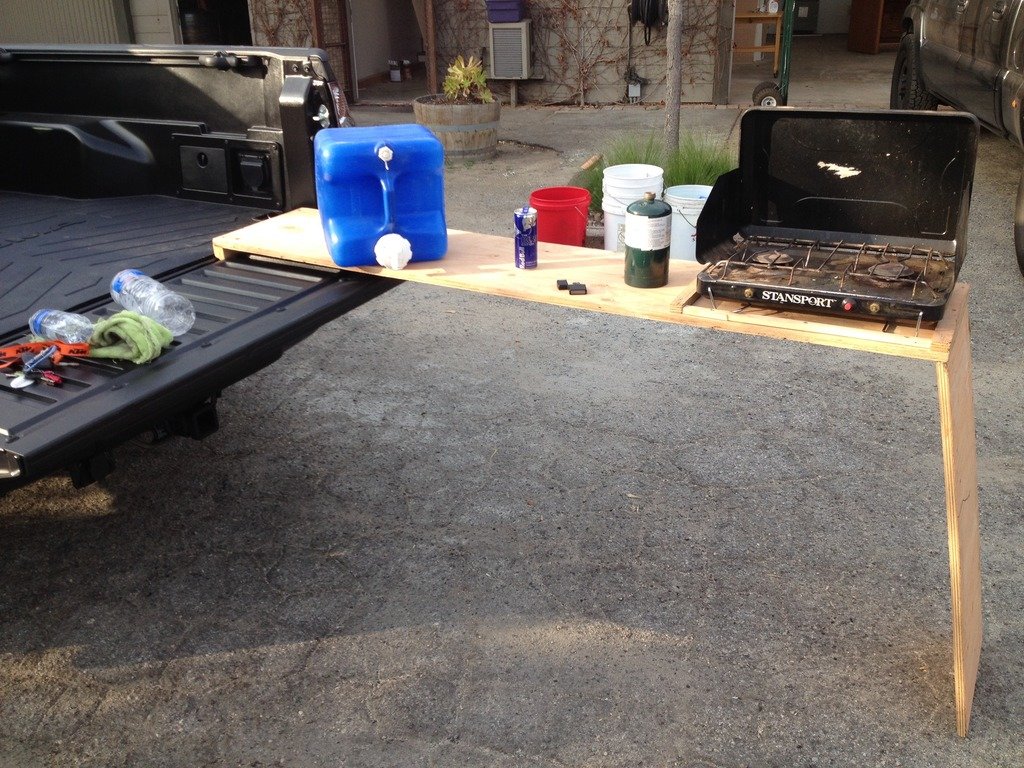

    I had some leftover scraps after building my sleeping platform, so i made this little extend table that works great for cooking/prep. I added a lil scrap so that it seeds itself in the tailgate jam, so it won't collapse on itself. On the other end i used some hinges so the 2 parts would fold together nicely. Hope it inspires somebody to do the same! IMG_4750_zpsoauuziqp_1aaa0d1caf2606a91d840aa531565726450cbeda.jpg

    I did the same but I used a fence post that has holes in it that will take a cotter pin. That way when the ground is uneven I can set the right height. I rarely use that table. Some nice NRS roll tops are what I seem to use more often.

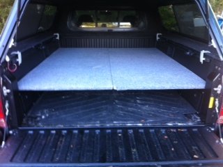

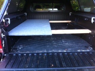

    Posted these in the "Camper Shell" thread, thought I'd share here as well.photo 1.jpg photo 2.jpg I went with 2x6s with the ends notched to sit flush with the lip of the bedliner. Since I wanted to do a two-piece platform, I used 3/4 ply for stiffness. Indoor/outdoor carpet applied with spray adhesive and its done. 1 1/2 hrs and $84 (I needed 2 sheets of ply cut 28 1/2 x 69in.). I probably could have gotten by with 5/8 ply, but I think 1/2in would sag.

    I was going to go 1/2" also for weight reasons, but ended up going with 3/4 and glad i did. There is a little tiny bit of sag, but its sturdy.
