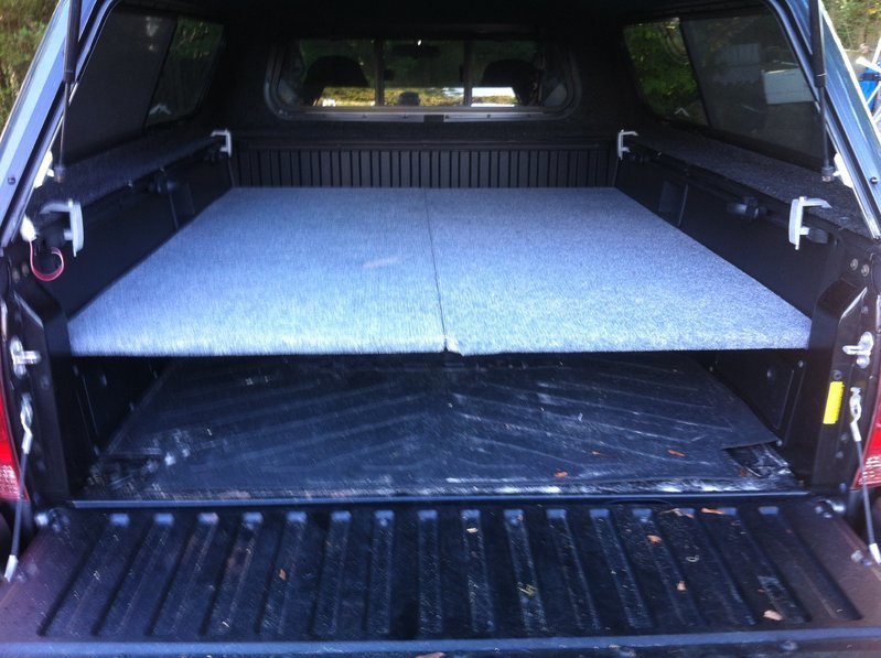

    The best support is the "uni-strut" or "power-strut" metal c-channel from Lowes. They have it in a 3/4" height that is perfect for the notches, and if it sags, you just flip it over and sag it back over time.
    I bought two (8' or 10') lengths, cut them down, and have 4 total cross beams (2 per notch set) running in my truck. Way better than wood because it maximizes the space under neath

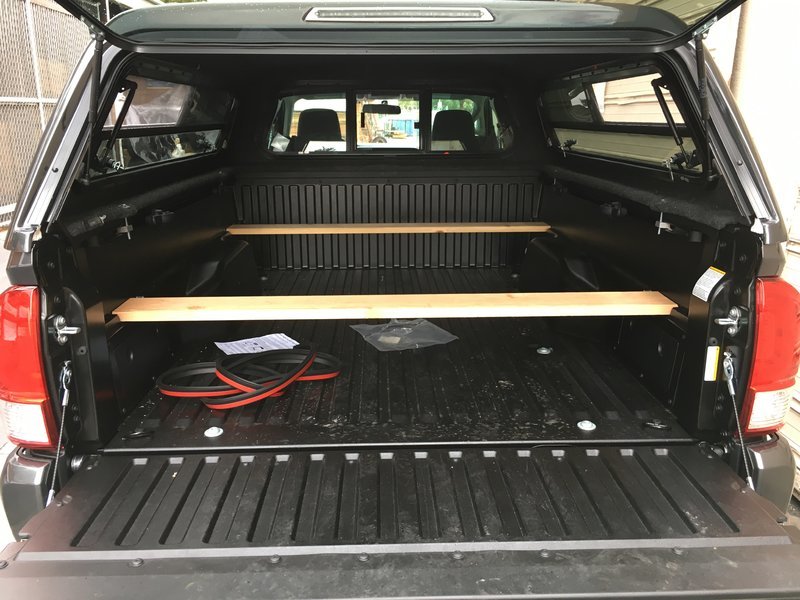

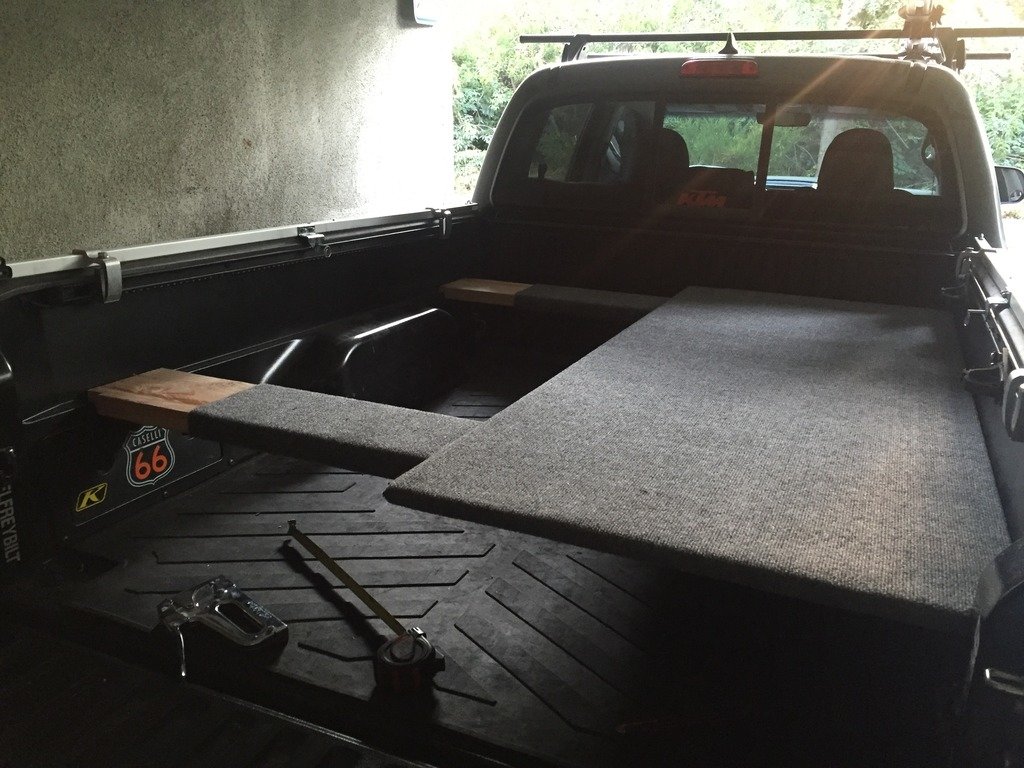

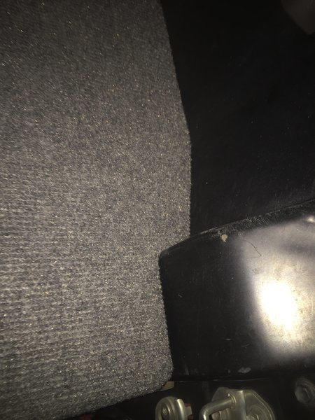

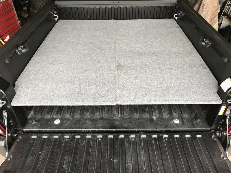

    Spent the day at the lumber yard and hardware store. The cross beams are 2x6s that are sliced down to a true 1x6 (as opposed to .75 inch). I put a support underneath on each crossbeam as well. Top is 3/4" ply upholstered with the 'ol staple gun.
    I also took my time with the tailgate seal and went to town. Crucial on these things by the looks of it. The moment I finished they day's work, the skies absolutely opened up. Spent a while in the shell looking for any leaks. Thing is tight as a drum at the moment. I guess my obsession with waterproofness at the Leer installer went well. Had them silicone the third brake light too.

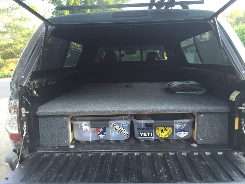

    Nice work. I have that same setup. I have a roof top tent for the wife and I. My two daughters sleep under the truck cap. I can load the back of the truck with all the camping gear and assemble the bed in seconds once everything is out of the truck and camp is set-up.

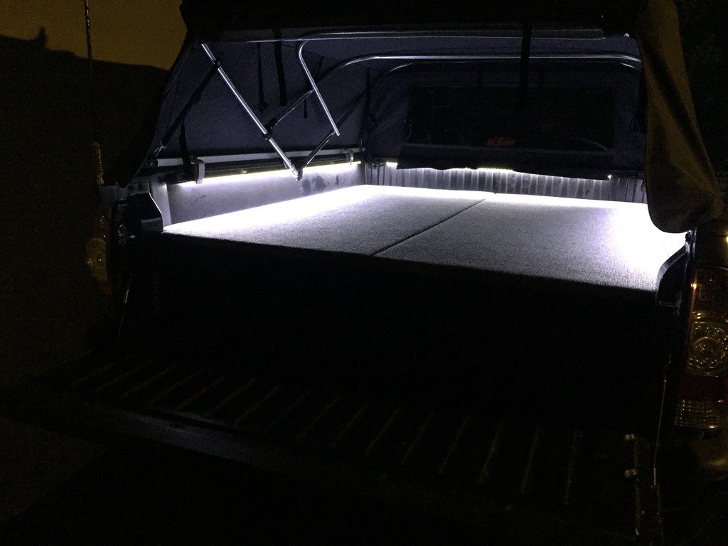

    How I spent Christmas Eve...

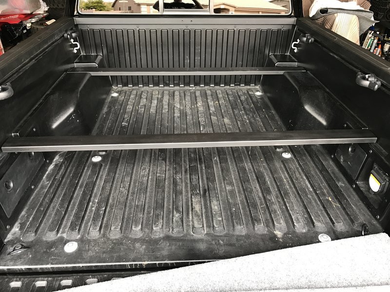

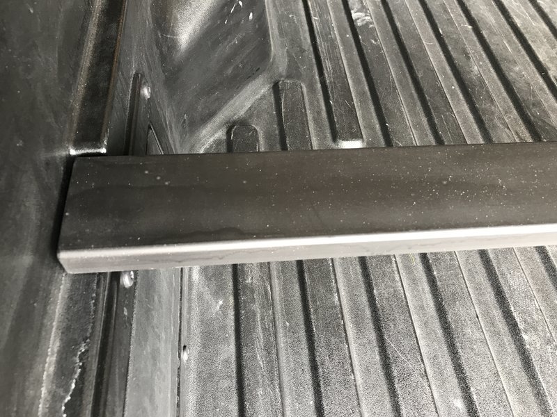

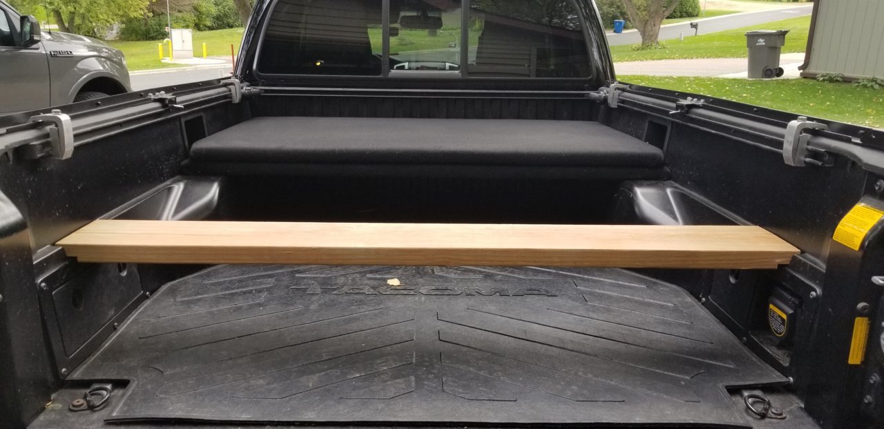

    Well I just built my first addition to my 2016 Tacoma OR. Went to the local metal supply and bought 1" X 3" rectangular steel for the cross support. I went with steel for strength and it fits the 1" cutouts in the bed perfectly. (I think I saw somewhere on the forum someone did the same steel supports but cannot find it.) Then covered plywood. Notched the tailgate corners to fit.

    nicely overbuilt.

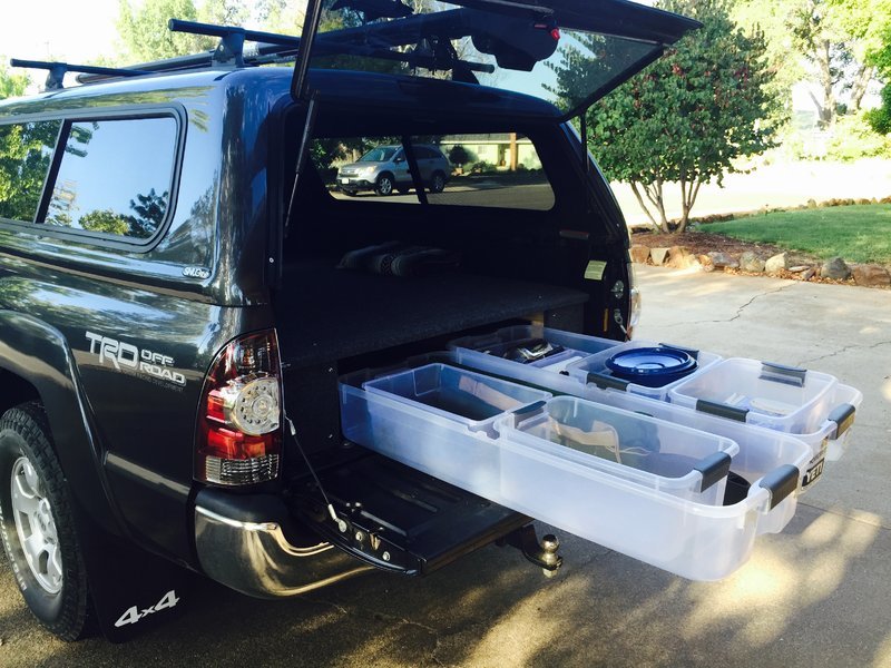

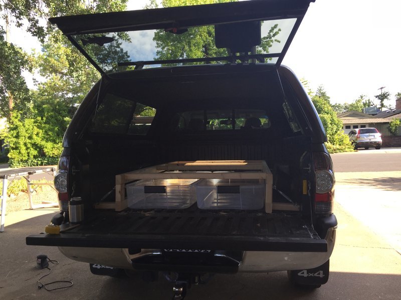

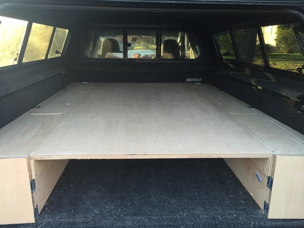

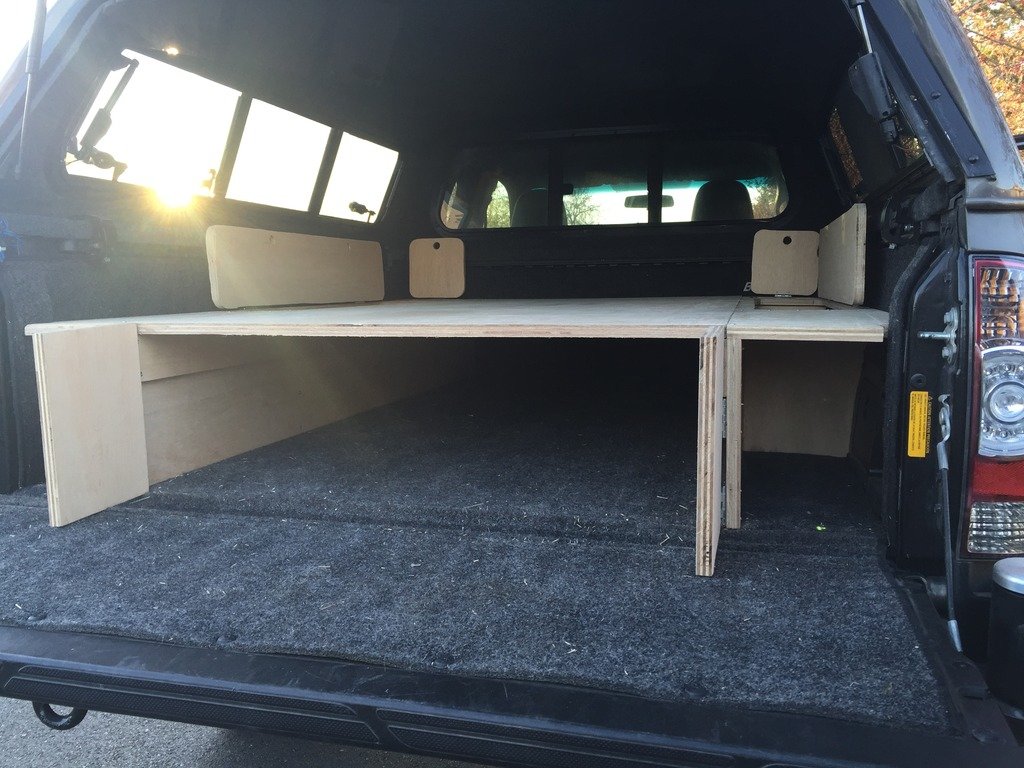

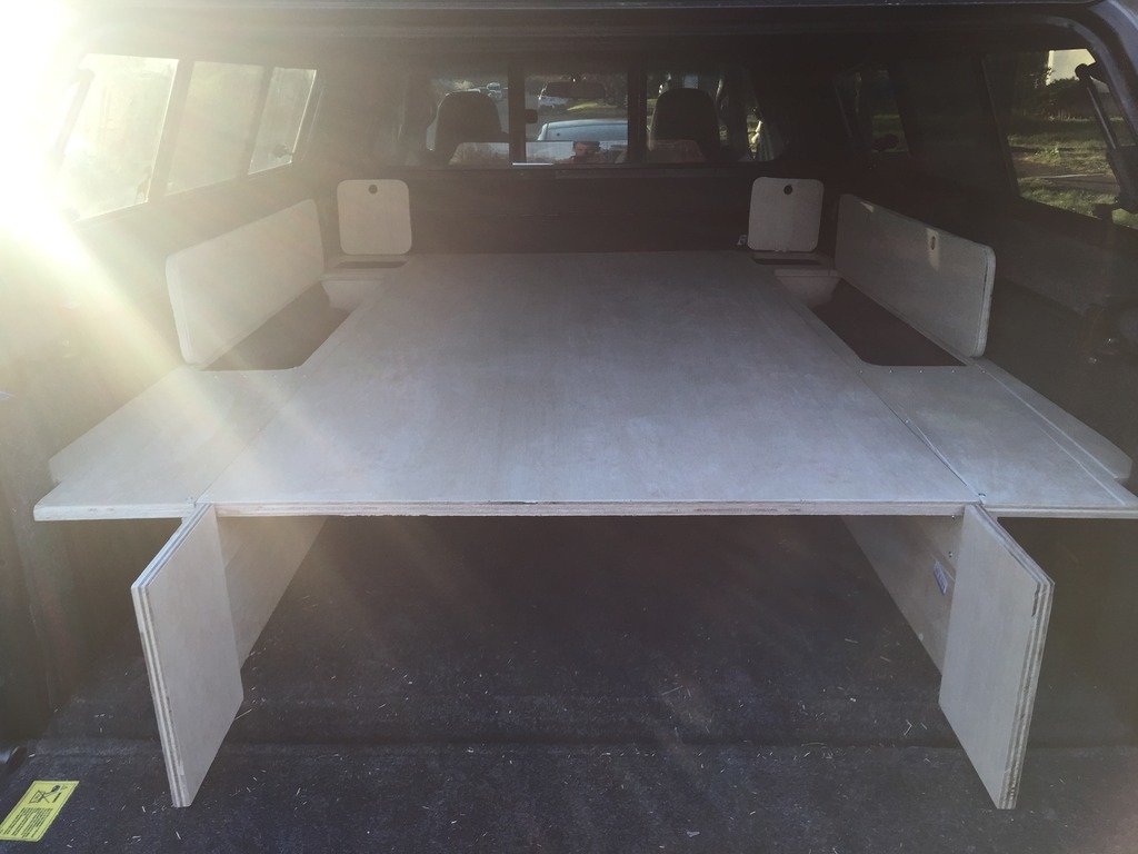

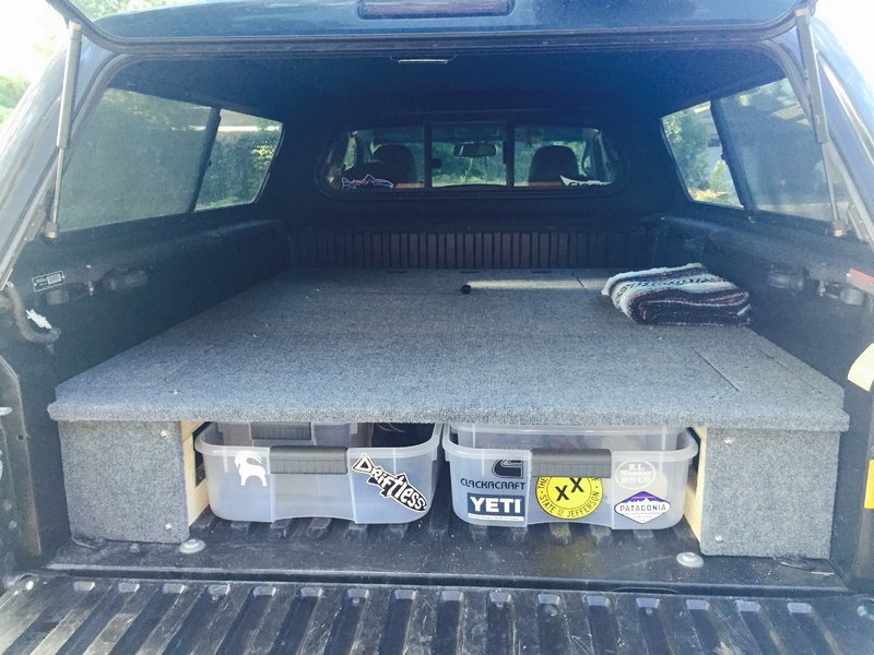

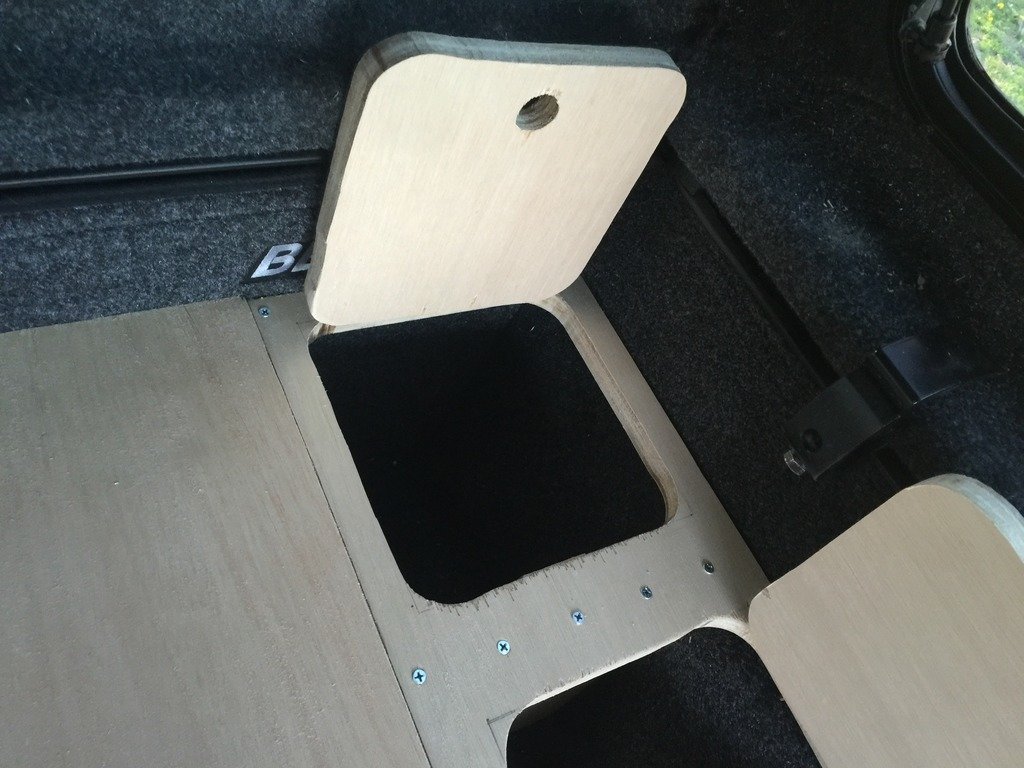

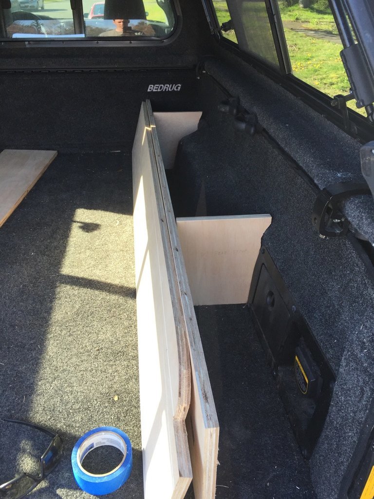

    I built a platform/storage system after lurking around here looking at others' builds, so I thought I would post mine up. I didn't take a lot of mid-built pictures and I don't have measurements, but I can probably answer questions from memory. In case you can't tell from the pictures, it's a fairly simple, three topsheet design and can be removed without taking off the camper shell. The top sheets are plywood, the frame is 2X3s, and the frame is held in place with turnbuckles on all four corners. There is storage in each corner on booth sides of the wheel well, in the center the length of those bins, and right behind the cab there a large door/hatch/storage compartment.

    Where can one get those long plastic bins ?
  18. Sep 30, 2019 at 9:16 AM
    #118
    netlseh
    netlseh Active Member
    Apr 21, 2016
    #184898
    34
    Target

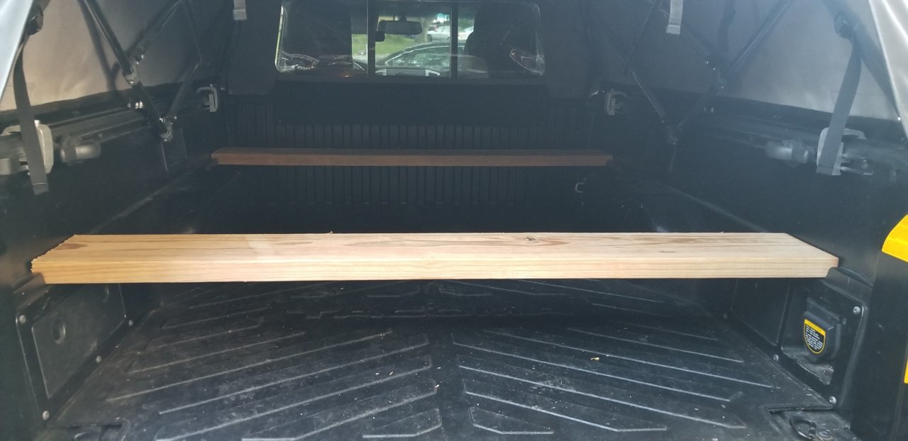

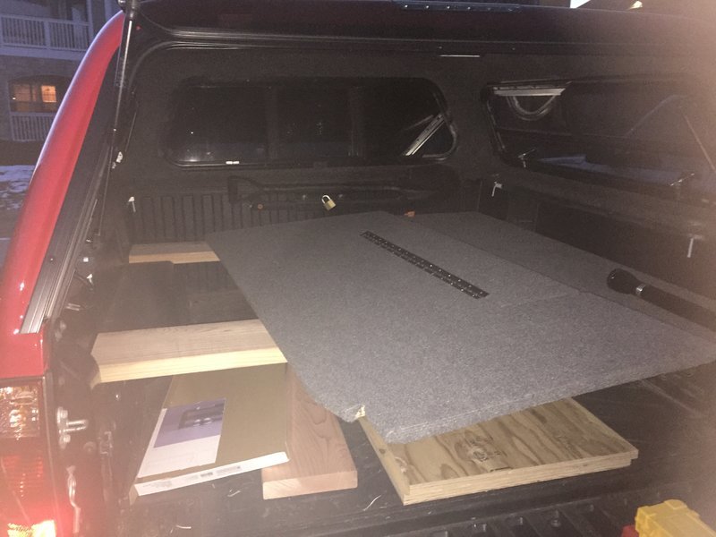

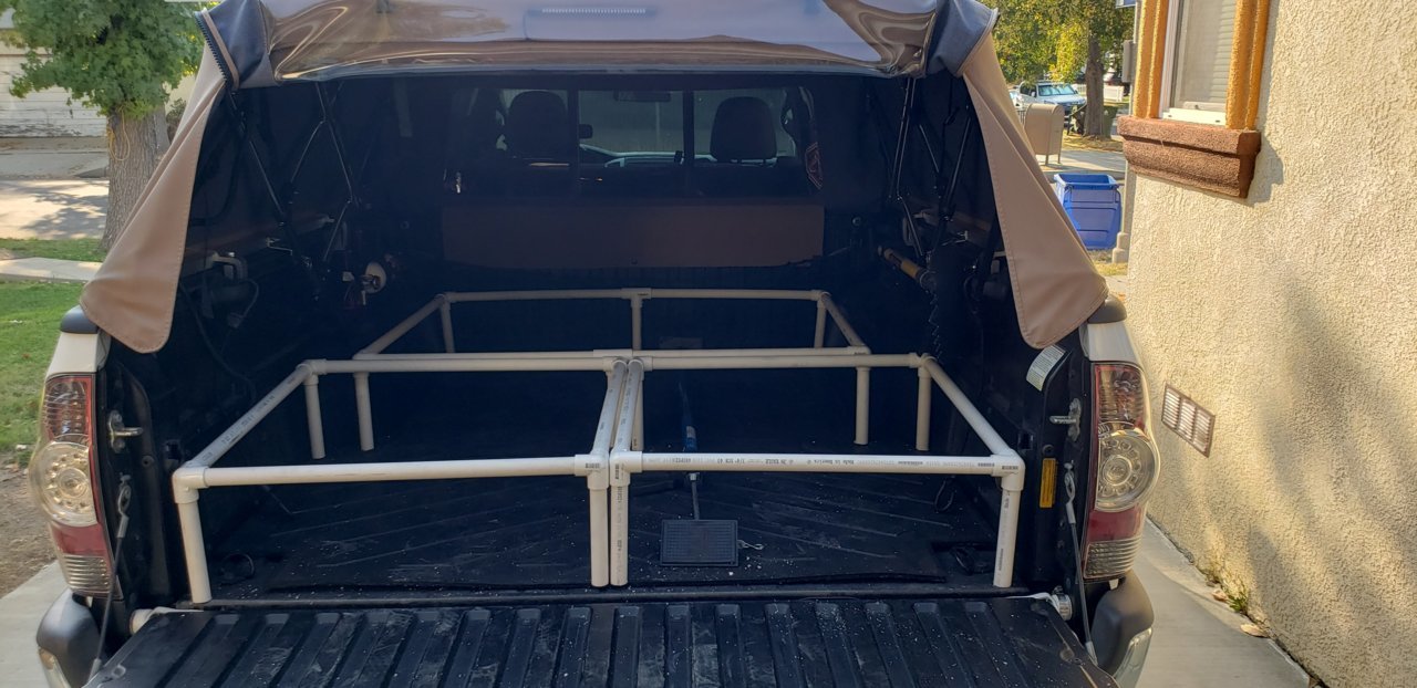

    Well, I built this yesterday with the idea of an ultralight sleeping platform that would be easy to remove. Today I am gonna get some 3/4 birch, but I am kinda regretting it now. I feel I would have been better off with just using the notches like most of you did.:annoyed::facepalm:

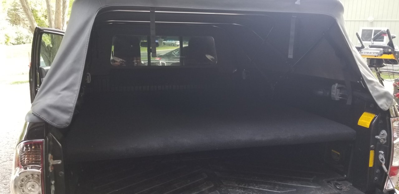

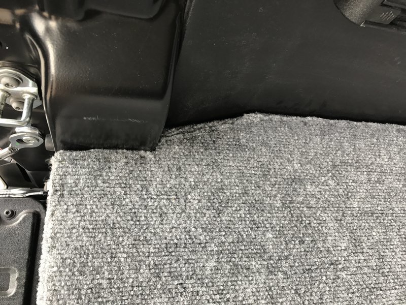

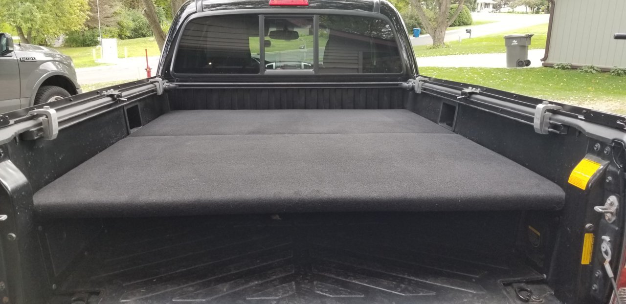

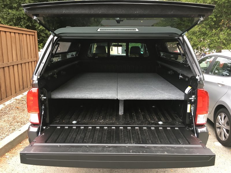

    Finished mine up today. 5/8" treated ply, had to notch 2x8's to sit flush and cut them down to 7". Marine grade carpet with some padding underneath. Turned out pretty good. 20201001_181821.jpg 20201002_122057.jpg 20201002_122128.jpg 20201002_143112.jpg
