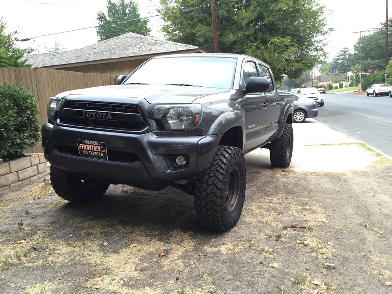

  11. Sep 7, 2015 at 9:16 AM
    #31
    Sleepyheadajay
    Sleepyheadajay [OP] Well-Known Member
    May 17, 2015
    #155450
    177
    2015 Magnetic Grey Tacoma TRD Off-Road
    Few additions to the rig!! Finally got rid of the Chromie Homie parts!!
    1. Rear color matched bumper
    2. Black house headlight Mod
    3. TRD Pro Grill
    4. Piping re-route for better clearance
    Enjoy players!!

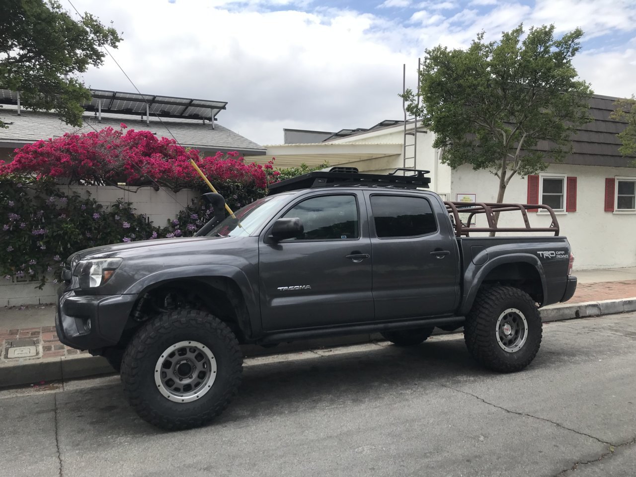

  17. Apr 30, 2019 at 8:12 AM
    #37
    Sleepyheadajay
    May 17, 2015
    #155450
    177
    2C3C7547-302C-4C8B-8C0D-8E617B3BE5D5.jpg B803948F-37EE-46E7-B358-1710BAB326DA.jpg
    and finally a regear to 4.88 and 35” tires! Also trimmed the fenders a bit and took out all the inner lining so nothing rubs or makes random sounds at full cranks!
    HappyGilmore likes this.
  18. Jan 30, 2020 at 2:56 PM
    #38
    crumbtaco
    crumbtaco Clapped out tacoma
    Jan 27, 2020
    #317433
    8
    Birmingham, AL
    2012 DCSB TRD-Offroad 4x4
    3' Icon CO's front, icon 2.5 rear, dakar leaf pack
    What suspension setup was being run in this picture? In detail
  19. Jan 30, 2020 at 5:55 PM
    #39
    Sleepyheadajay
    May 17, 2015
    #155450
    177
    I was on Icon 2.5 coilovers for the front with 700lb springs. Lifted a total of about 3” from stock height.
    Rear is on Dakar leaf springs paired with Icon 2.0 reservoir shocks. It was about a 3” lift as well.
