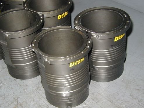

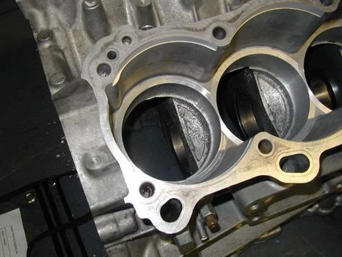

    I and a few others have sleeved their blocks with Darton M.I.D. sleeves. Gadget from URD and I worked to get the first sleeves made. I supplied the sacrificial block, he had Darton do the rest.
    Here is what it looks like.
    As you can see, it does not matter if the original cylinders were over bored. They will be completely machined out and replaced with these. Then you bore these sleeves to the diameter that you need. Stock, a little over, or even a good deal over. I don't recommend more than .060" over. Less contact patch for the head gasket. Which has to be ordered from Cometic. Unless you choose to do a stock bore diameter.
    No point in putting sleeves in a block that has bad main bearing races, if bearings cannot be found to fit after machining. A block that did not have spun main bearings is much better choice.
    The sleeves only improve the rigidity of the block. Making it stronger in turn. As well as repairable. The upgraded rods and pistons, with head studs increase the power handling capability.
