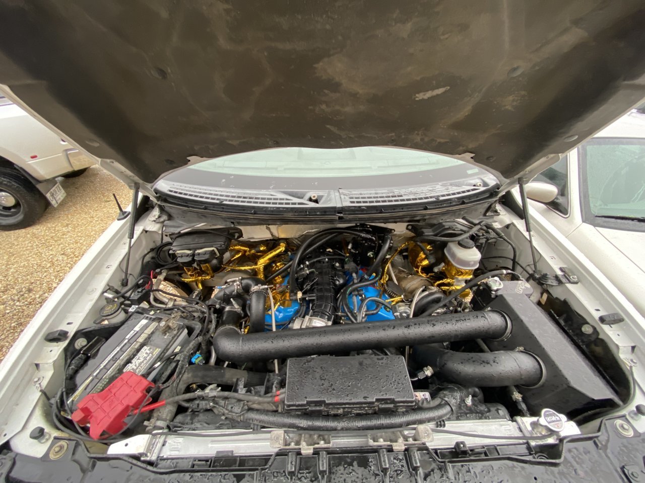

    Going to see the truck tomorrow and hear it run :yay:
    They fixed the oil pressure sensor and doesn't have any leaks! Issue was the new oil system uses a three wire setup and my truck had a one wire so there was no ground to the sensor. They welded a tab to it and grounded it on the block and instant success! Had a bad vband clamp on passenger downpipe so they're fixing that tonight so I can hear it run tomorrow! Next is just tuning and make sure all looks good before we turn on the second fuel pump and really fire it up:bananadance:
