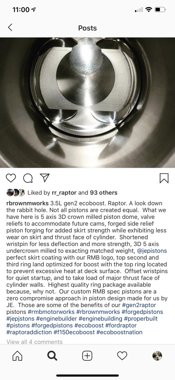

    what's stock compression?
    Sleipnir[QUOTED][OP] likes this.
  15. May 30, 2019 at 8:15 PM
    #195
    Sleipnir
    Sleipnir [OP] Still havent found that stupid snipe
    Apr 28, 2016
    #185554
    10,495
    I'm a horse
    Asgard
    Furd Rangero Ecoboost
    Same, 10.0:1
    Beretta4x4[QUOTED] likes this.
  16. May 30, 2019 at 8:18 PM
    #196
    Beretta4x4
    Beretta4x4 What makes the green grass grow? TTC#0114
    Jan 20, 2016
    #175568
    30,285
    Josh
    Temple, TX
    6-speed death mobile
    Nice. Any adjustments to the combustion chamber with the new pistons?
  17. May 30, 2019 at 9:01 PM
    #197
    Sleipnir
    Apr 28, 2016
    #185554
    10,495
    I'm a horse
    Asgard
    Actually yes :D
    Here's a post straight from the horses mouth
