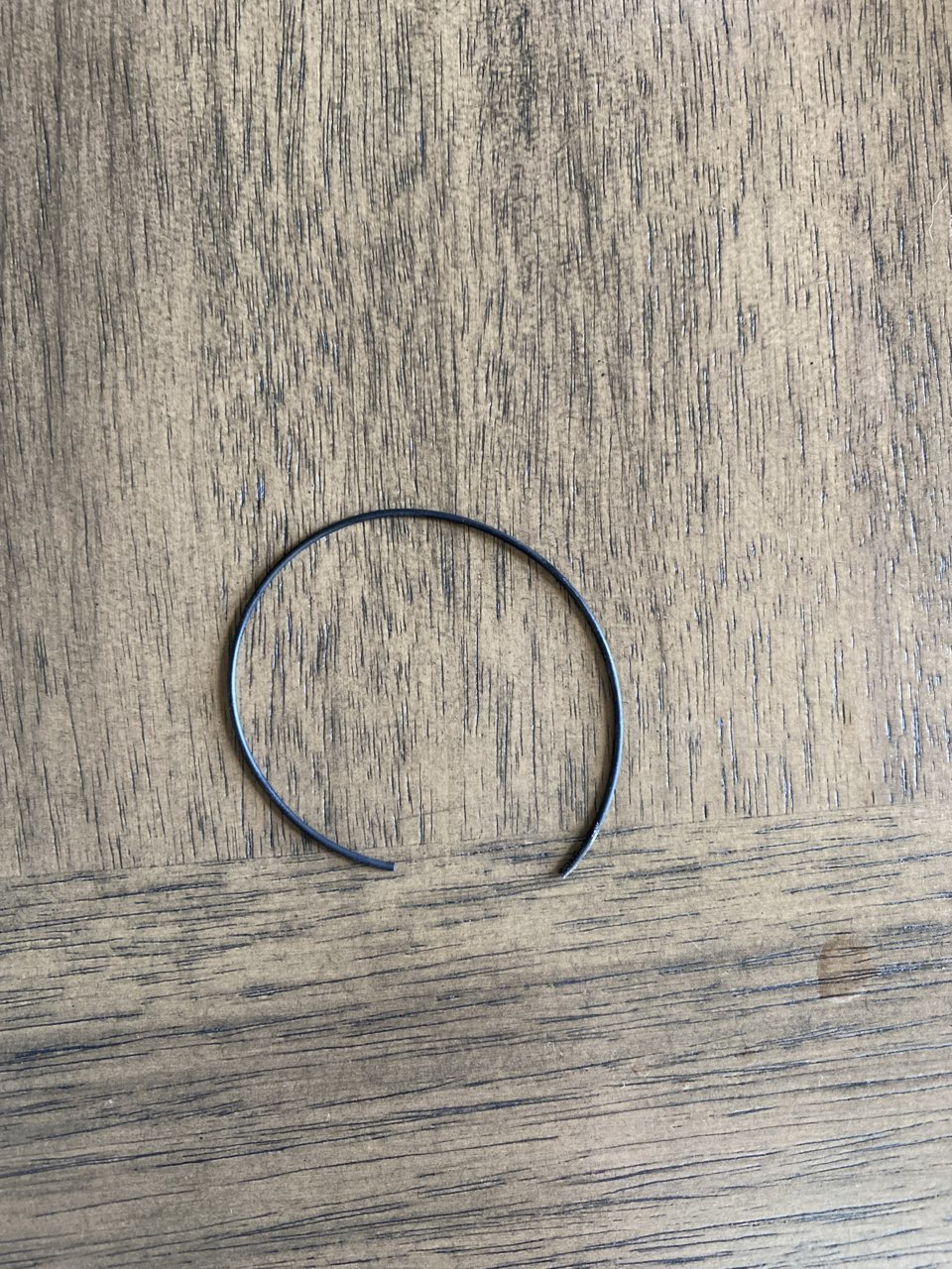

    I think my bov is leaking or the spring is too soft and not allowing the unit to seal. At high boost it’ll woosh and wastewater shows it opening and closing like it’s not sealing. So either I need a stronger spring, bov isn’t on right or I need a new bov. More stuff to figure out :annoyed:

    Well adjusted the bov today and it seems to really like that a lot. Still seems to be leaking but not bad and that could be caused by this

    O-ring seal between the mounting flanges, or internal?

    Internal. It was the oring under the cap.
