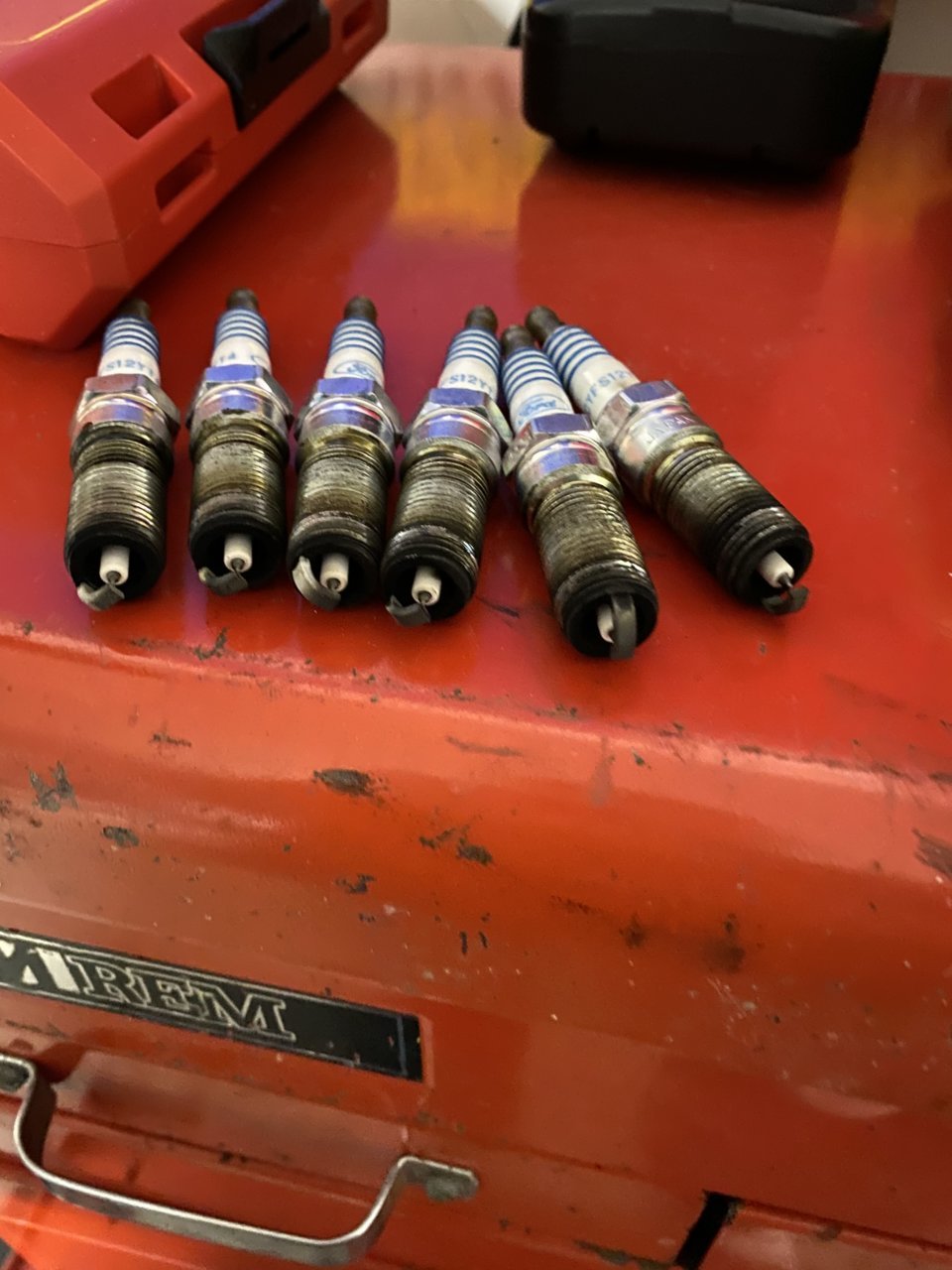

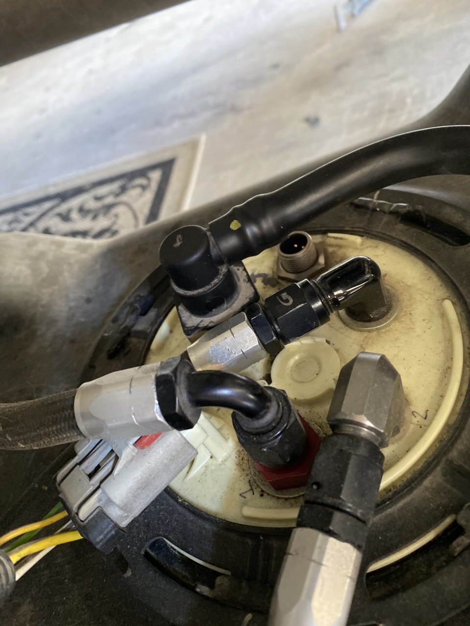

    Well changed the plugs Friday and seems to be better. The old plugs were fouled out but weren't wet just sooty. Dropped the tank and I can see how the fuel pump is wired and what needs to be done to wire the second pump.
    Right now the trigger wire is a add a fuse under the passenger fuse panel in the door. Needs to be ran all the way back to the tank and tapped into the yellow/gray wire.
