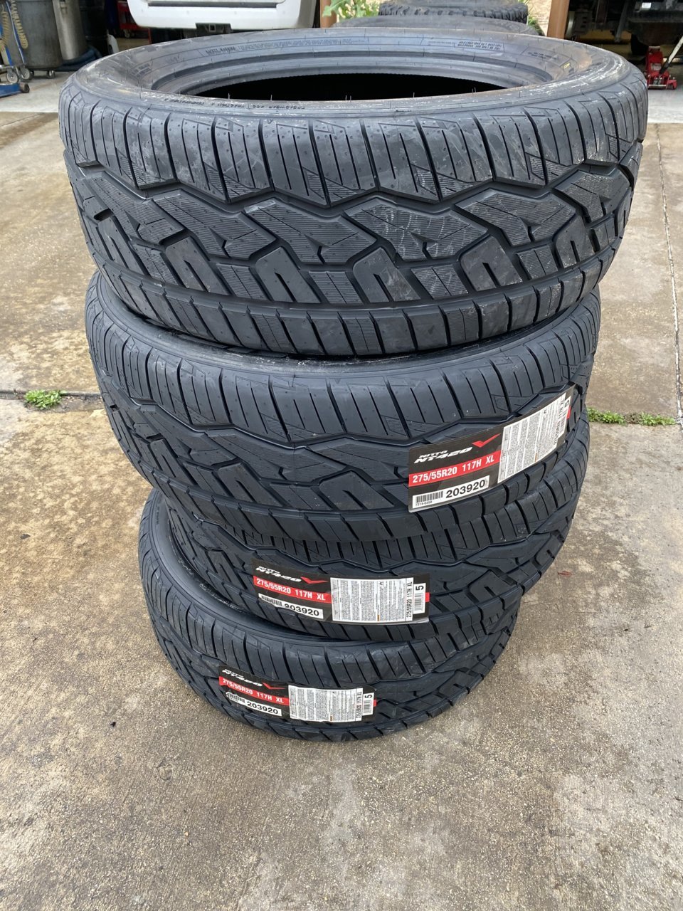

    New tires came in early so I'm getting them put on now.

    Kind of remind me of the 295/45 R20 Hankook tires that I current have. What is the treadwear count on those? I like the pattern.

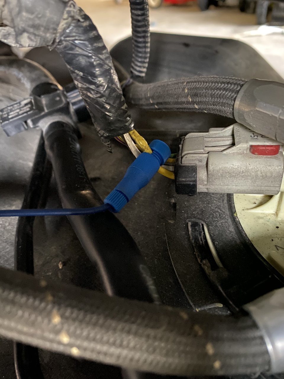

    Well wired the second pump in today. Finally had time after this busy work week to take half a day and do it. My neighbor let me borrow his transmission jack so I could lower the tank down easier. I had to run to the auto parts store for fuel line, hose clamps, 18awg wire, butt connectors and zip ties. Took the blue feed out from the passenger fuse panel where it wasn't getting a signal to all the way back to the tank and in the trigger wire for the fuel pump. This way both pumps will run the same at the same time and at about half their duty cycle. Ive already noticed I went from 500 miles to e on a tank to now 600miles on a tank. My mpg went from a solid 12.6mpg on the highway going 70-75 to now 16mpg+ :bananadance:
    At wot it doesn't sputter as much which might mean I need to increase the fuel pressure regulator from 62 to 90psi. But overall it's doing way better just from my initial testing. I'll need to datalog this and see what the numbers say.

    Interesting splice.

    called a posi tap. My engine builder tipped me onto them and apparently they’re big in the motorcycle world. Cost me $10 on Amazon for an assortment pack of six.
