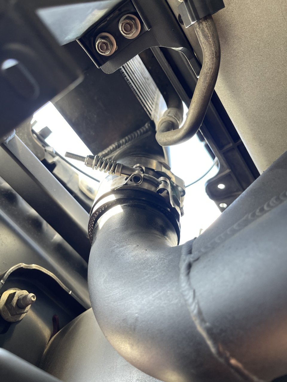

    Found a huge boost leak today after speaking with my tuner that it should be making more than 1psi. Passenger side intercooler pipe was off. Tightened it up and boost came right back! Then the top half came off. Already tightened and ready to go. Going to put a safe tune on it and datalog from there. Maybe this will clean the smoke issue now that the turbos are building boost
