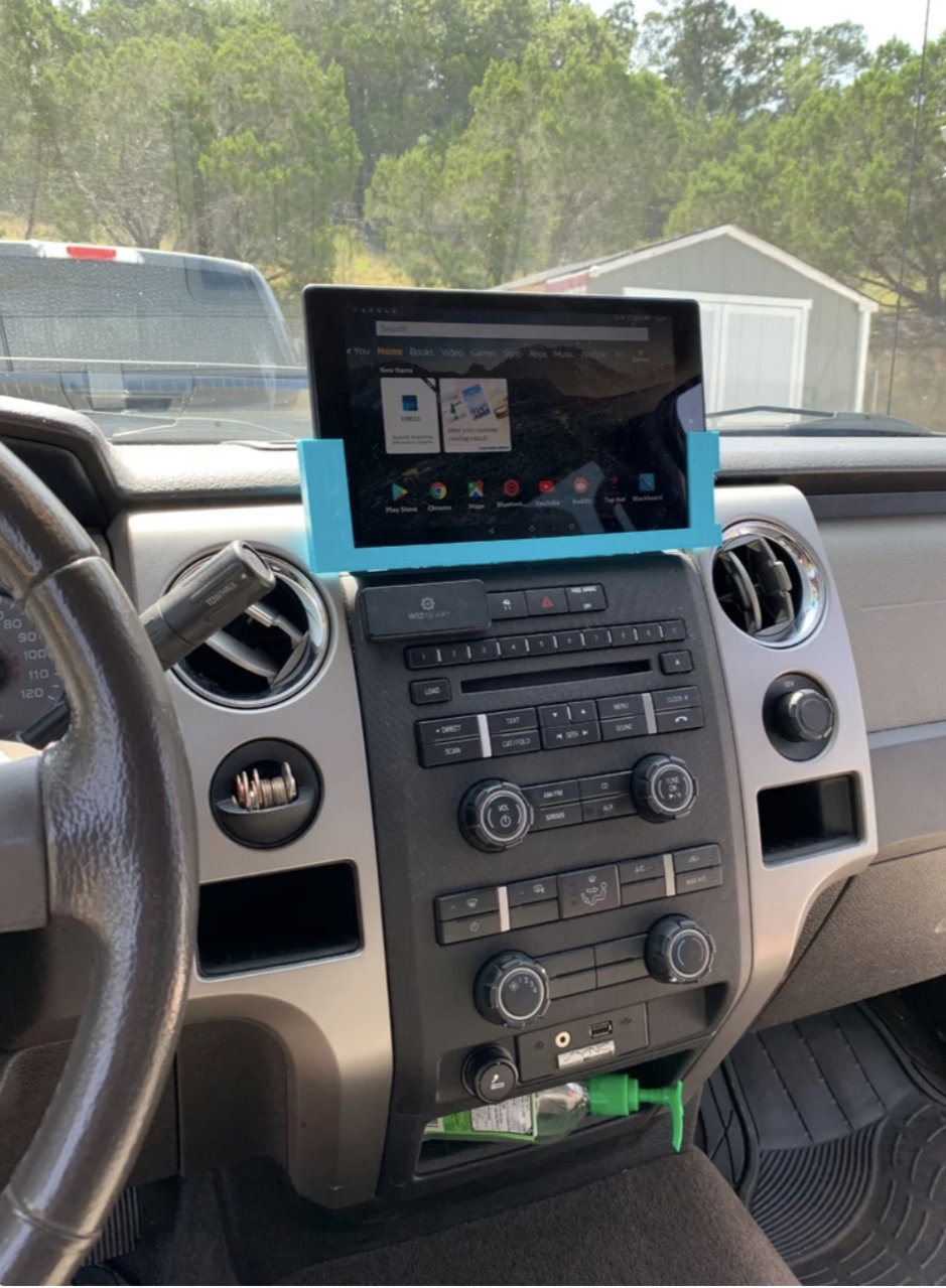

    In case anyone is wondering what I’m smoking with my last post here’s what the setup would sorta look like

    Tablet should be here today and the mount should be here next week near the end hopefully

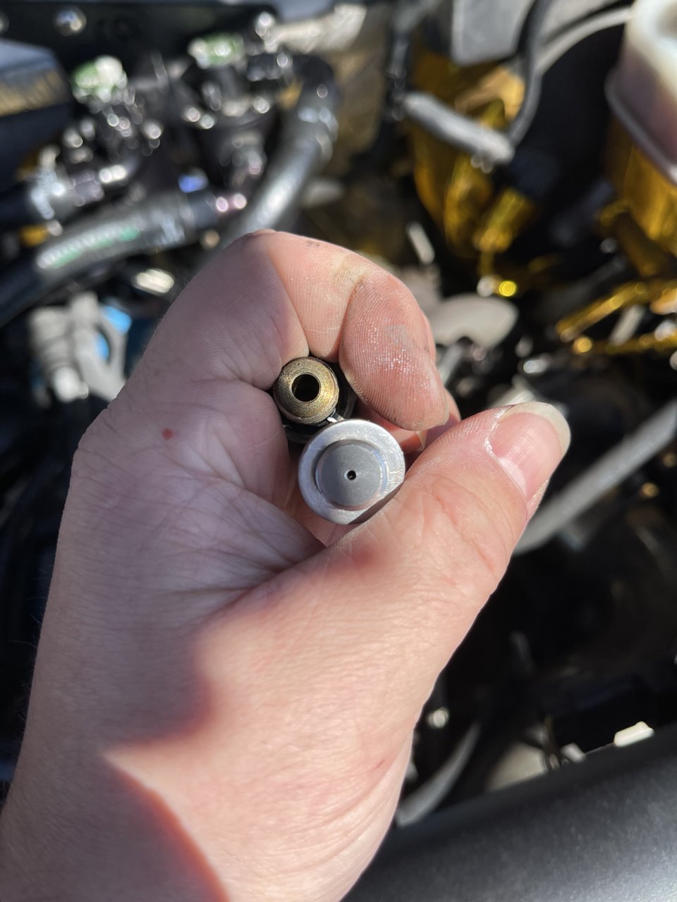

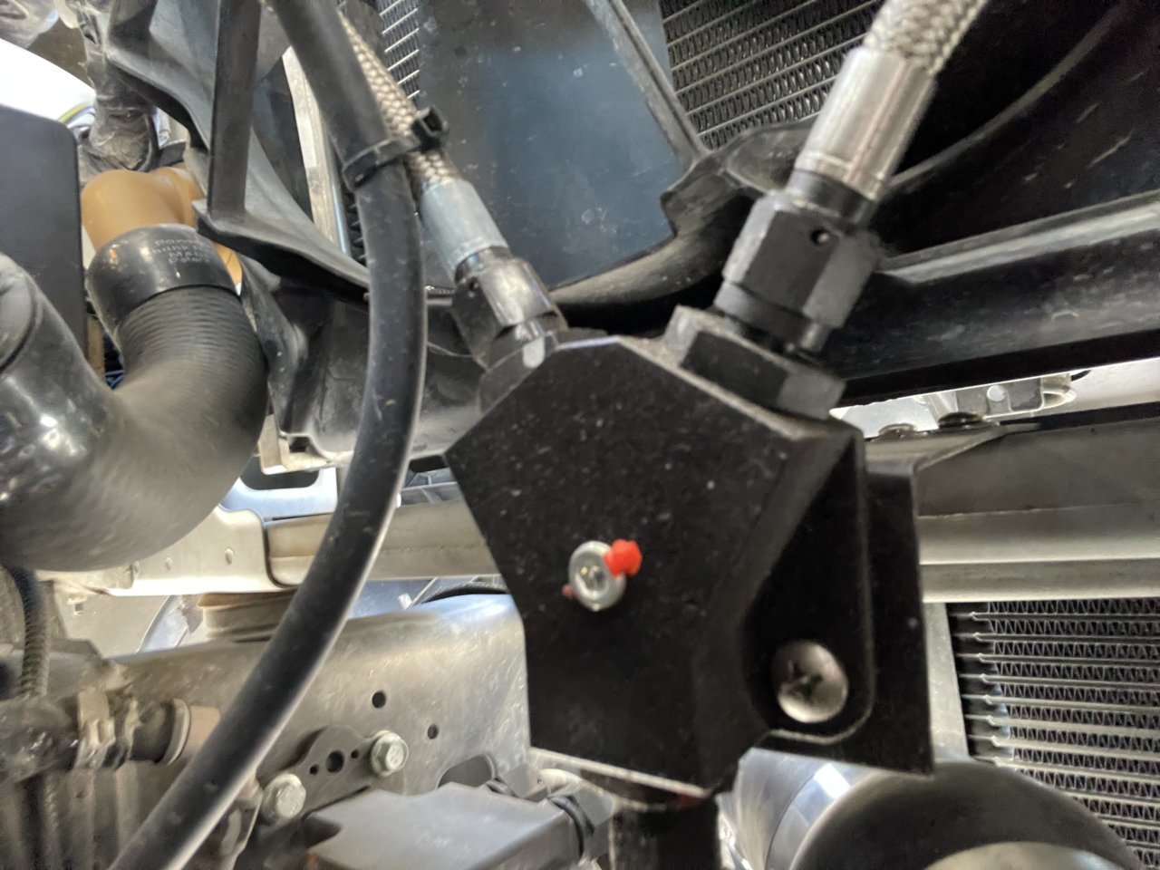

    Did the paper towel truck and seems like it's just condensation and oil. No coolant or anything.
    Installed some oil restrictors and waiting to see how it goes. Saturday I have some fittings and gauges coming in to see how much oil pressure I have. If it's over 40 psi I am going to install a turbosmart opr before the distribution block and tap the drain probably at the pan.
    Waiting on my oil to get here hopefully Saturday too to do it all in one day.
