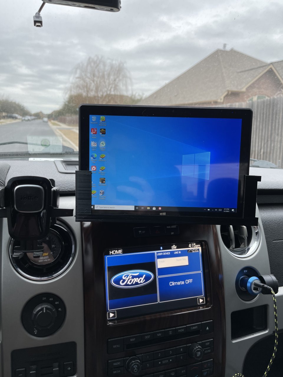

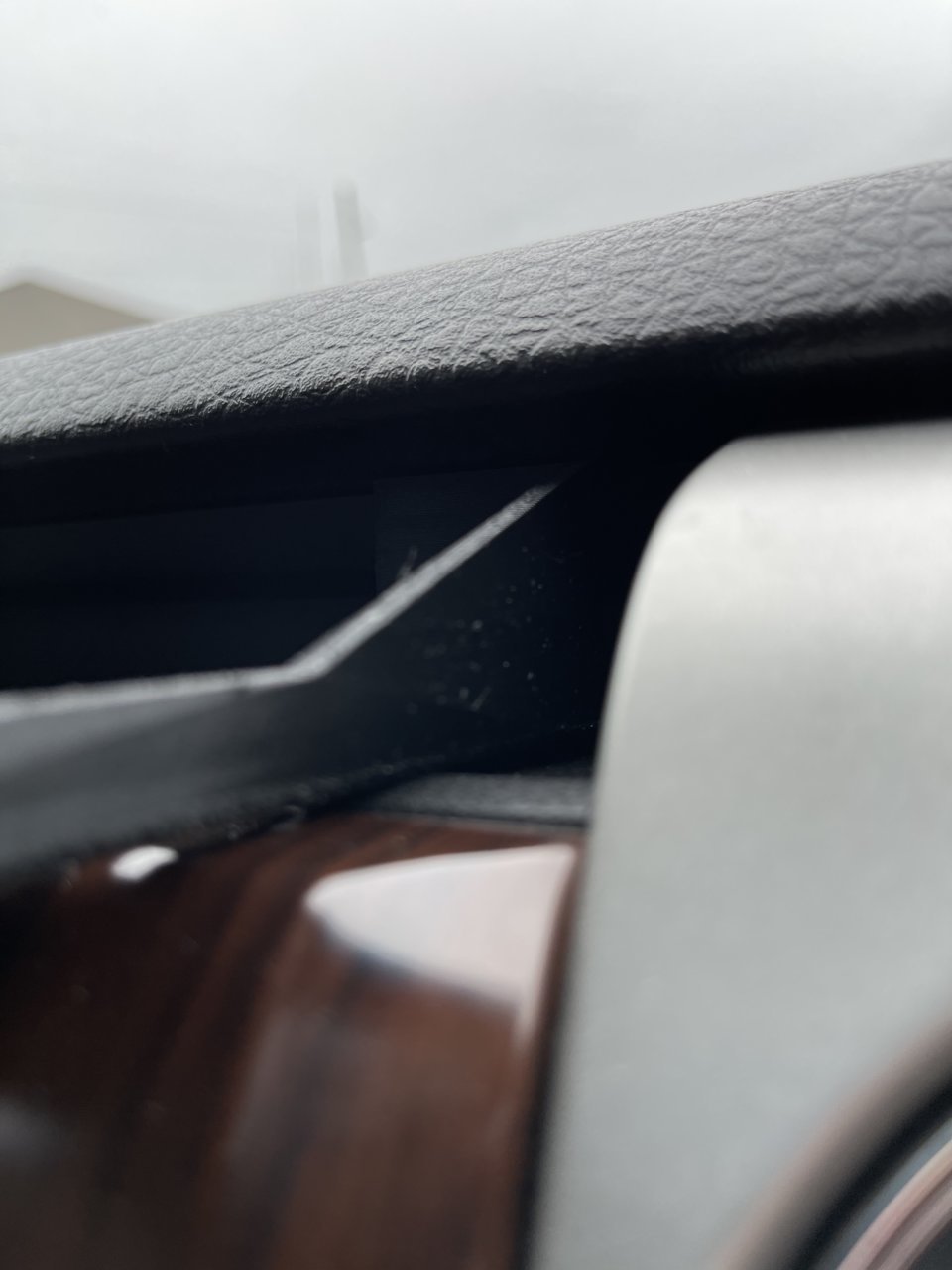

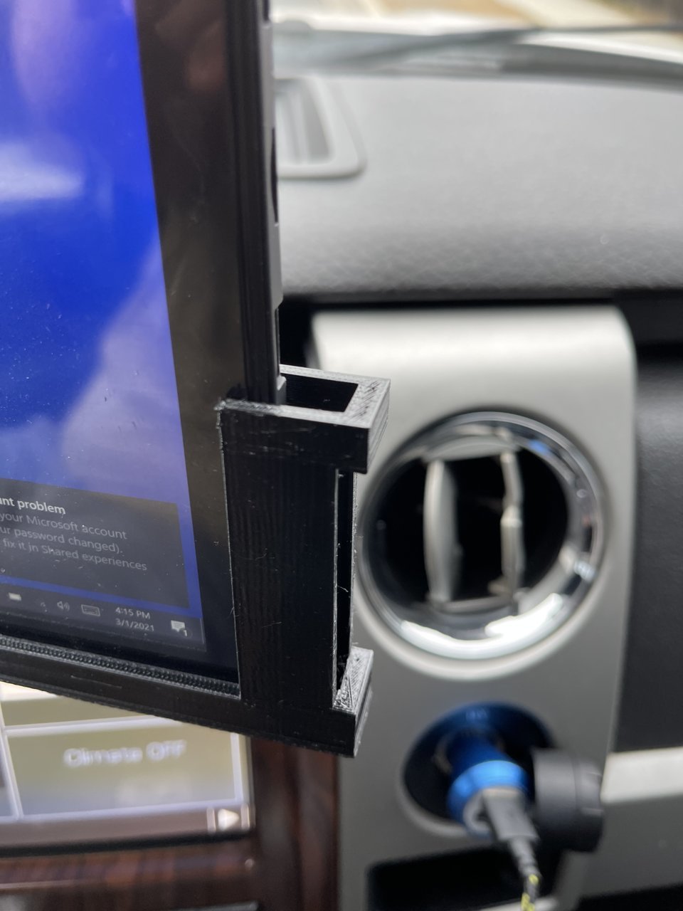

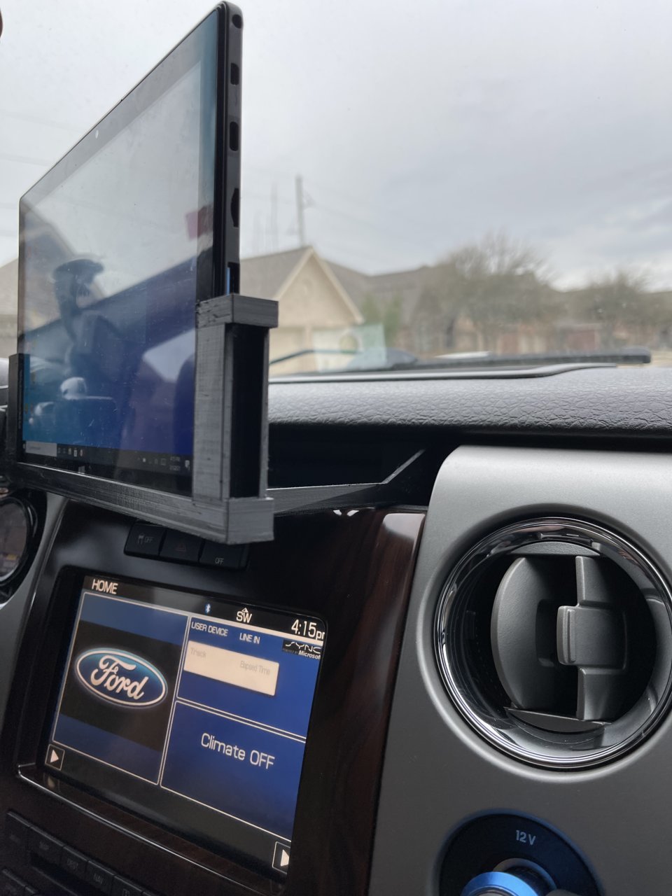

    So something cool finally showed up. My tablet mount I had 3D printed is here. Tablet is a little small but easy to fix. Also want to shave the support a little to fit better in the cubby. I have a design idea I want to use.
