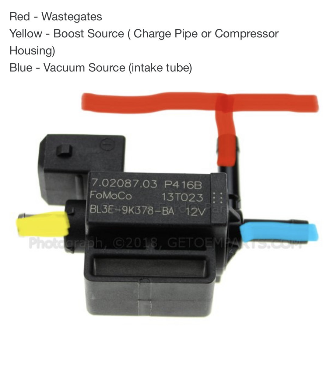

    Well I changed my vacuum routing last night. Someone had hooked the wastegates to the boost solenoids that are typically mounted on the turbos for the CRV. Then they had the compressor housings t'd into the front boost solenoid. This is not how the routing or the solenoids work and there was a feed side (compressor housings) feeding into the outlet on the boost solenoid and the exact opposite for the wastegates. They go on the outlet side of the solenoids because it's supposed to pull boost from the hot pipe. Which by the way isn't where the solenoid is pulling from. It's pulling from the intake so I'll need to see if I need to tap the hot pipe so the wastegates have a reliable boost reference.
    Truck feels better and I can feel the boost and wastegates better. It's a weird feeling but it's moving the right way now. Next thing to tackle is the BOV and throttle plate. I'll do that all at once when I get my flanges and fittings for the drains.

    So after speaking with the guys over at full race my vacuum lines area still incorrect. I'm supposed to be using only the passenger bcsv to control the wastegates and that's it.
    I'm a little confused on one part of the routing so they said if I was stuck they would get an engineer on the phone to talk with me about it. I want to confirm whether or not I can use the factory bcsv on each turbo to control each wastegate separately. That would give @Boostking more control over the wastegates.
    I am also going to need to reset my wastegates and set them properly for the proper psi we want. My only issue is the bcsv on the intake manifold. Do I just let it pull from the intake and vent atmosphericaly and cap the outlet?
    I think this is going to make @Boostking life so much easier. We've been fighting that issue for a while now too.

    So if the front bcsv controls the wastegates then I figured it out and it's all within a few inches of each other. I will take the line from the passenger compressor housing and plug it into as a reference for the bcsv that controls the wastegates now. Then I'll flip that line that goes to the intake as a vent and it'll all be setup properly. The driver's side compressor housing will just be left as is because its not need and can stay on the bcsv that the PCM doesn't see. Cap where you had the passenger compressor housing going to on the other bcsv and tune away
