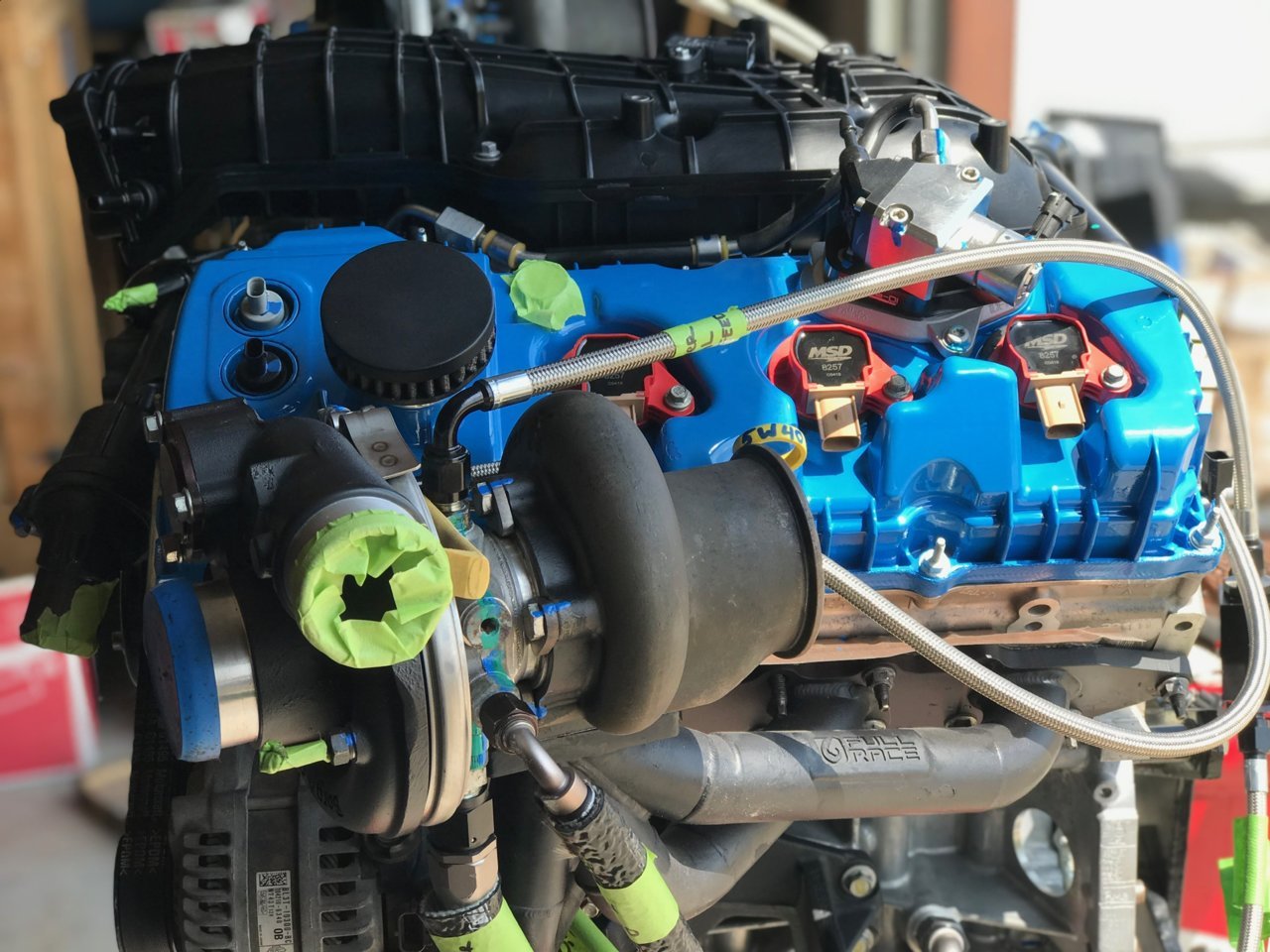

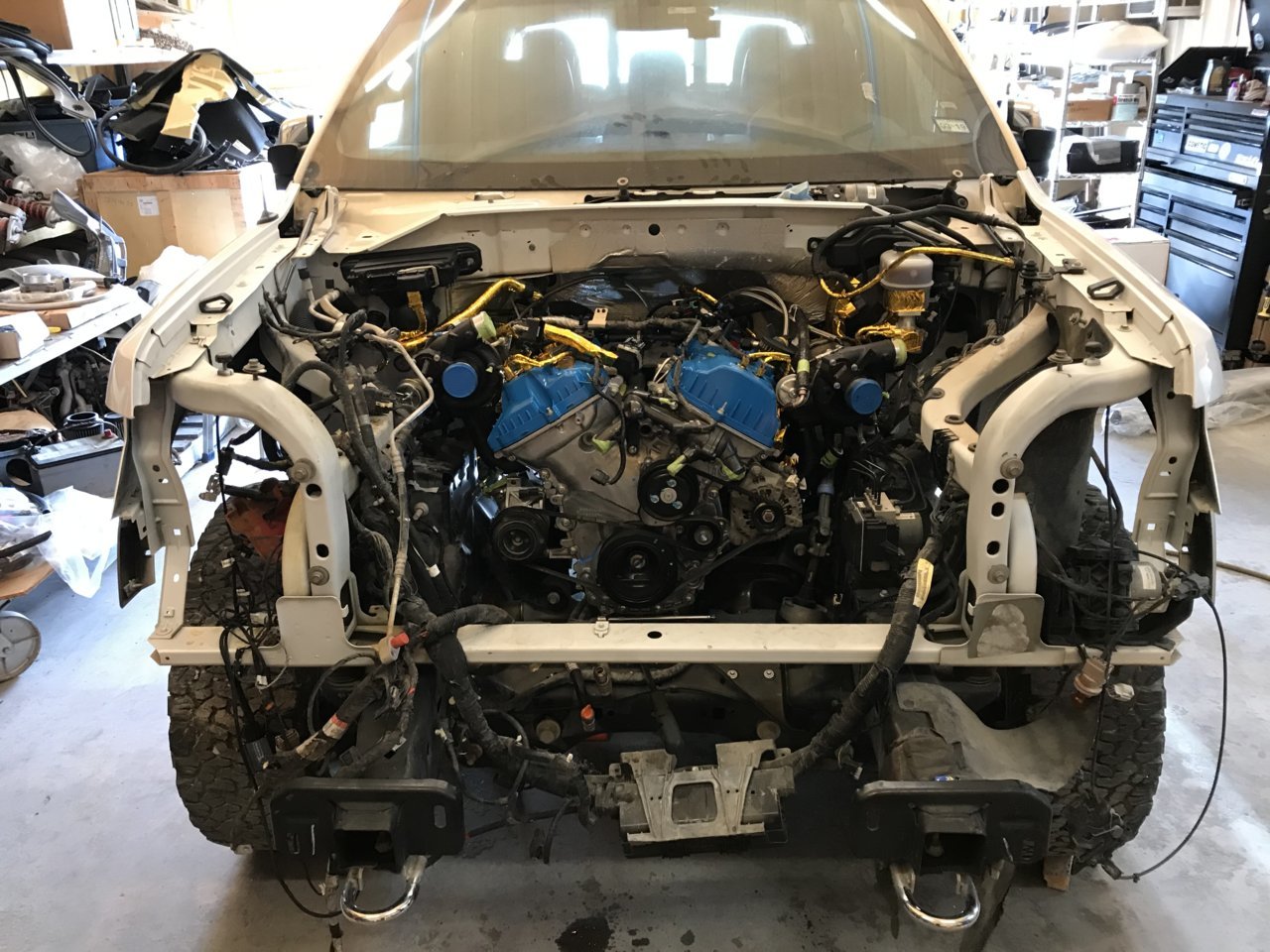

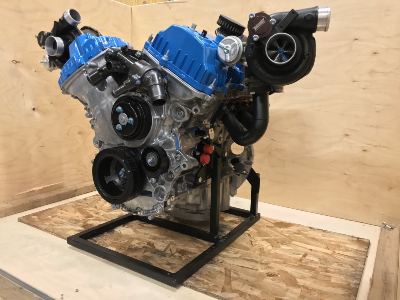

    Since selling the Tacoma I am starting a new build thread for the Furd. It's a 2012 Furd F150 3.5L Ecoboost. I bought it with about 94,000 miles on it and it had a leveling kit and 305/55/20 K02's.
    It originally went up to Tifosi Performance around October to get GT turbos, CRP ported manifolds, CPE Intercooler, Tubrosmart BOV, Full Race Catted DPs and an Intake. I added all this stuff because it was either needing replacement or going out and needed to be replaced soon anyway. Truck was running amazing until the rings let go around 120k miles in February because of carbon build up. Thanks GDI....

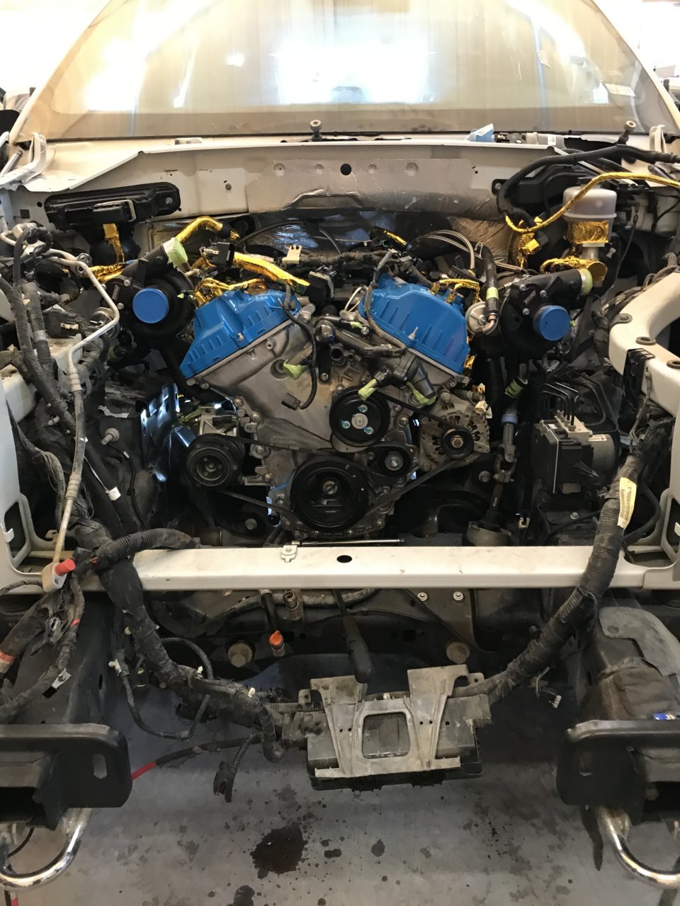

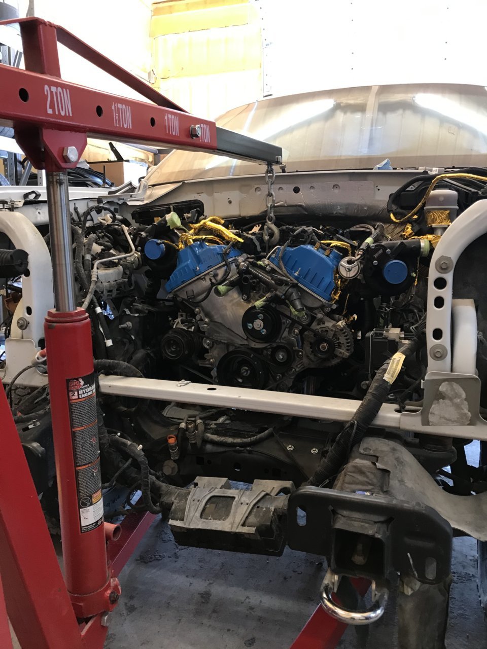

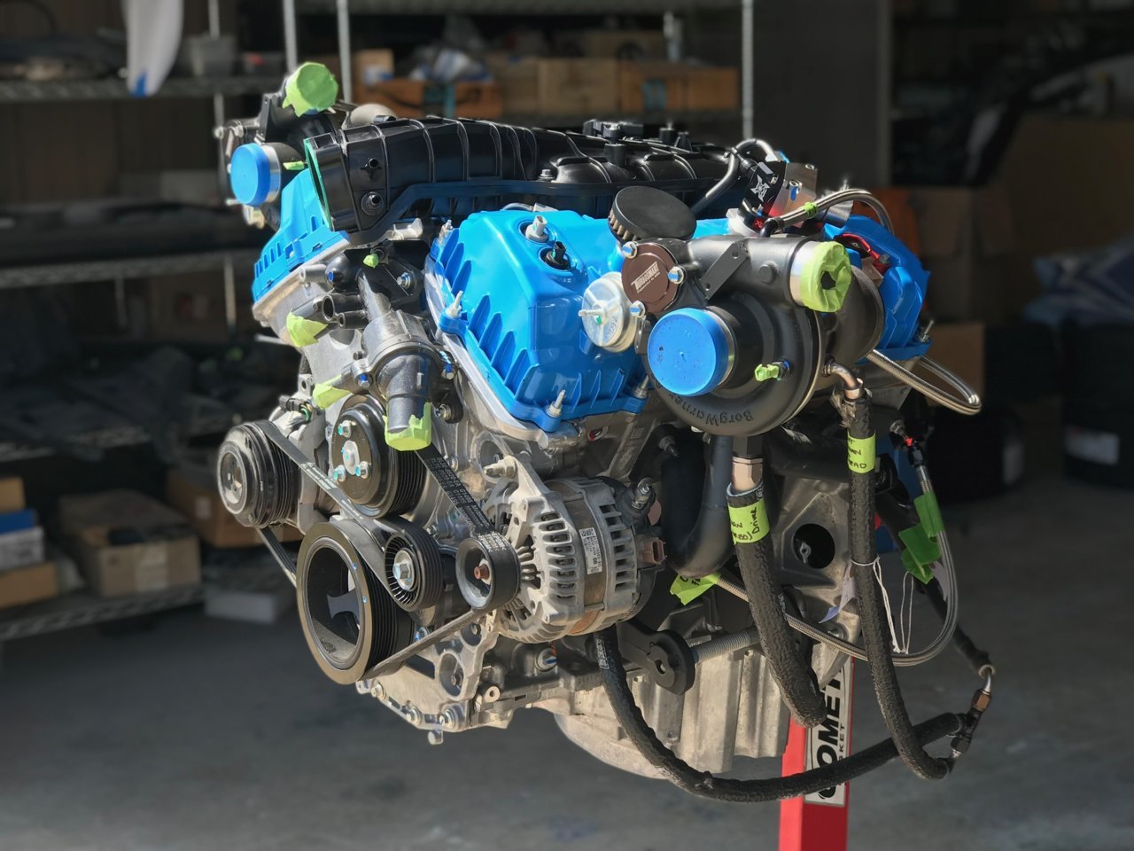

    So now it's in the process of having a brand new built block with ported heads and EFR Turbos put on from RMB Motorworks.
    Current mods are as followed:

    Motor:

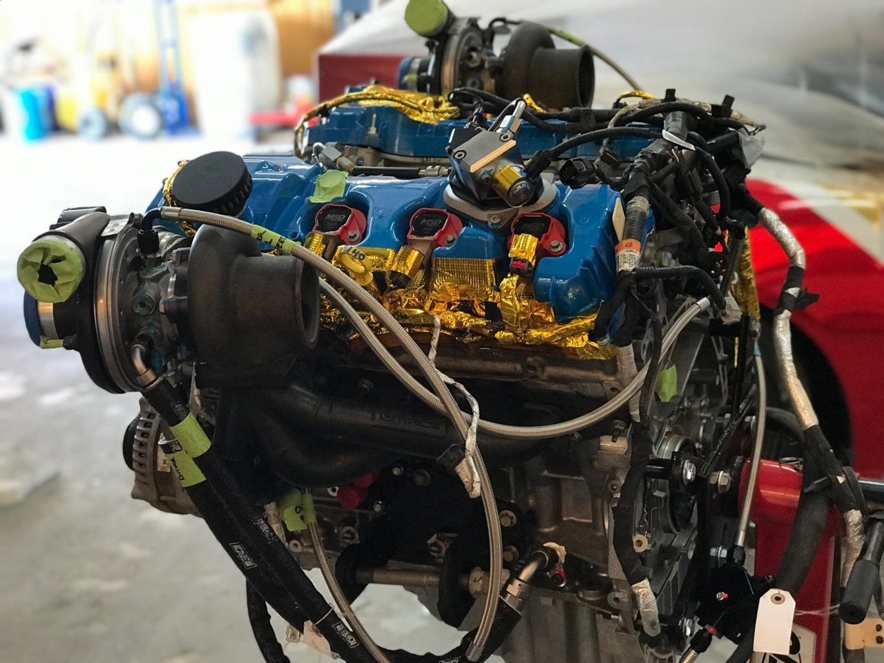

    RMB Motorworks Stage 2 Short Block
    • Cylinder Block - Brand new Ford OEM bare block with a 92.50mm Stock Bore (Closed Deck)
    • Pistons - RMB-JE 92.75mm FSR Forged Pistons, Custom Ringset, .210" Steel Pins, Clips, (Coated Skirts and Offset Wrist Pins)
    • RMB Spec Gold Ceramic Piston Coating
    • Connecting Rods - Callies Compstar H-Beams with ARP 2000 Rod Bolts
    • ARP 2000 Headstuds
    • Rod / Main Bearings - King XP Bearings
    • Crankshaft - New Ford Gen2 Raptor Forged 2017+ Crankshaft
    • Main Bolts - Standard OEM 6 Bolt Mains
    • Compression Ratio: 10.0:1 STD Compression Ratio with STD .040" thickness head gasket
    Pocket Port-R Heads with conical spring kit, with Ti Retainers and locks and custom valves.
    XDI-35 HPFP
    Spec C Cam Lobe to increase HPFP by 25%
    Full Race- RMB EFR Twin Turbo Kit:
    • BRMS Crimped Racing hose upgraded
    • PTP Turbine Blankets
    • Charge pipes
    • Hot Pipes
    • EFR Manifolds
    • Turbine Blankets • EFR 71/63 T25 single scroll turbins with T25 in and 3" outlet to a true 3+ pipe
    • Black ceramic coated compressor housings
    • Black ceramic coat turbine housing upgrade for the forged case center section made form aluminum
    • Upgraded forged aluminum light weight turbo center-section
    Turbo Smart IWG-75 Waste Gates with 14LB Springs (B1 Single Scroll Housing (Double 7lb spring))
    Full Race V2 Intercooler
    Full Race V2 Radiator
    Radium Dual Catch Can
    Custom Blue Painted Valve Covers
    Setrab Oil Cooler
    RMB Remote Oil filter setup

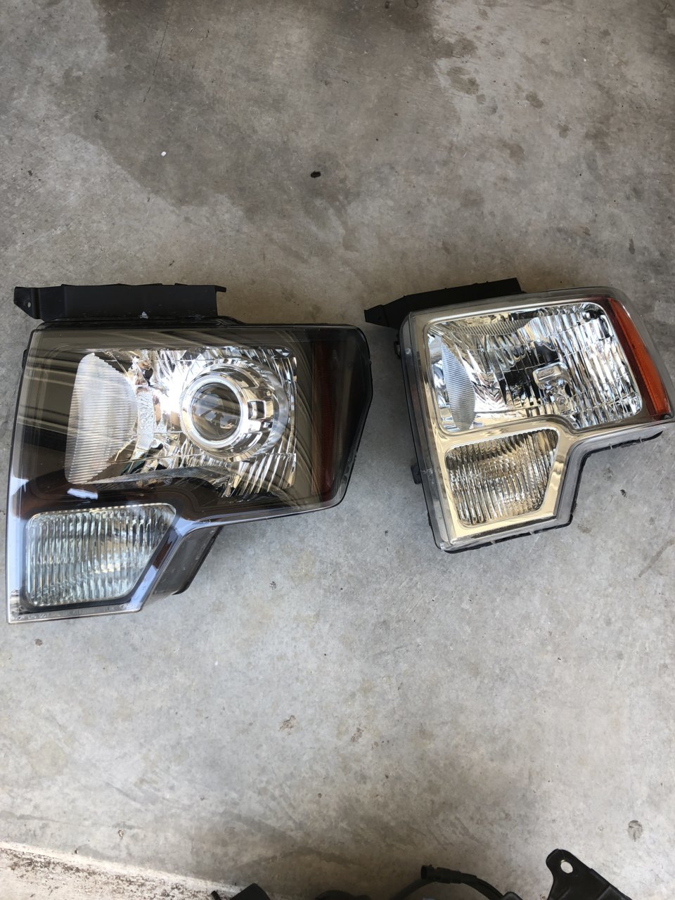

    Parts on the Shelf waiting for install
    Complete Raptor Suspension
    New Headlights and Fogs
    Old ones:
    New ones:
    Side by Side:

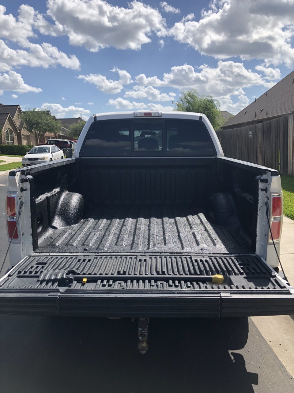

    Bed liner:

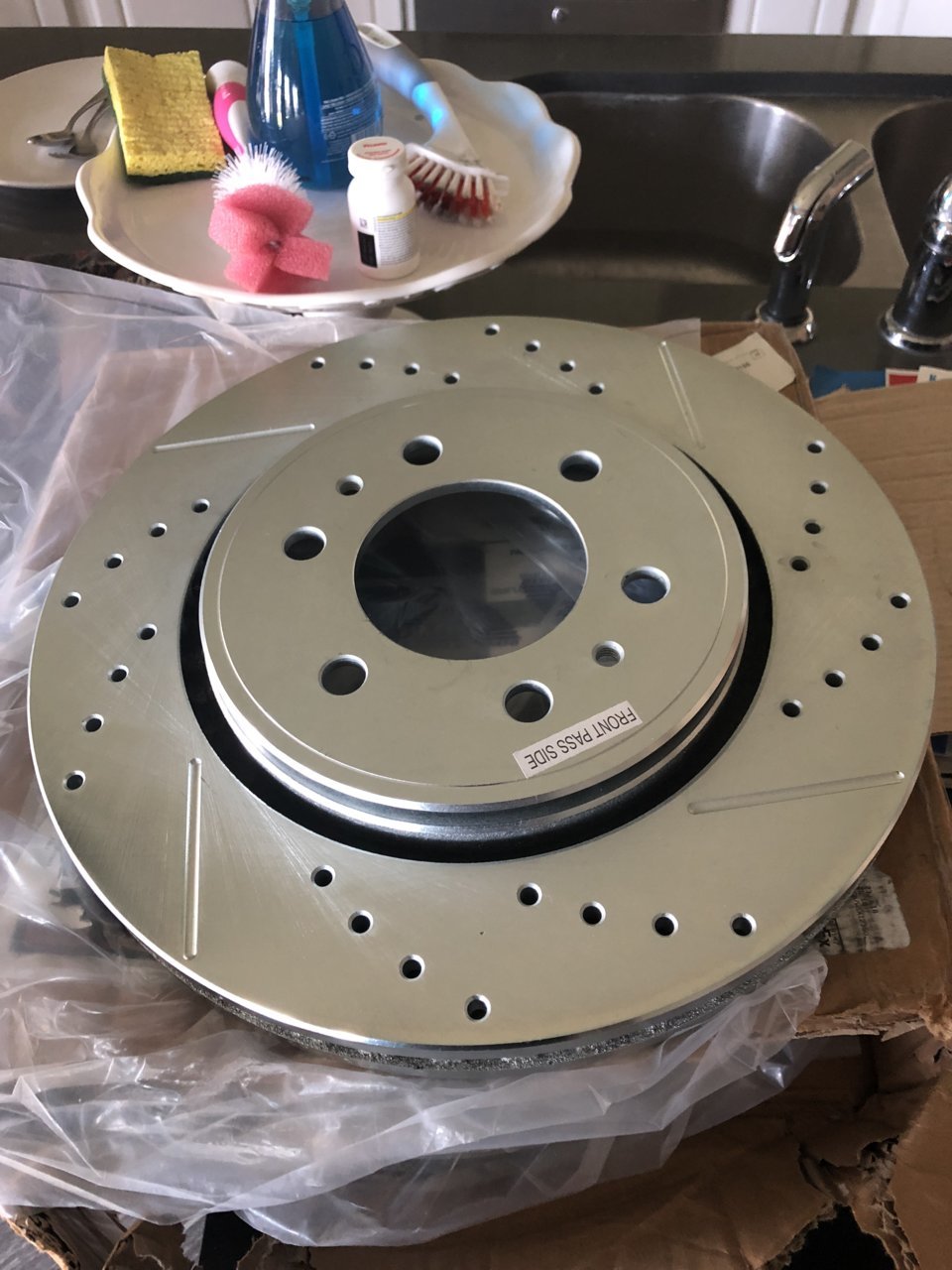

    Gonna be doing the brakes next weekend I think.
    I have Stop Tech pads and Power Stop rotors from Rock Auto. Only doing the fronts for now but will move to the back eventually.

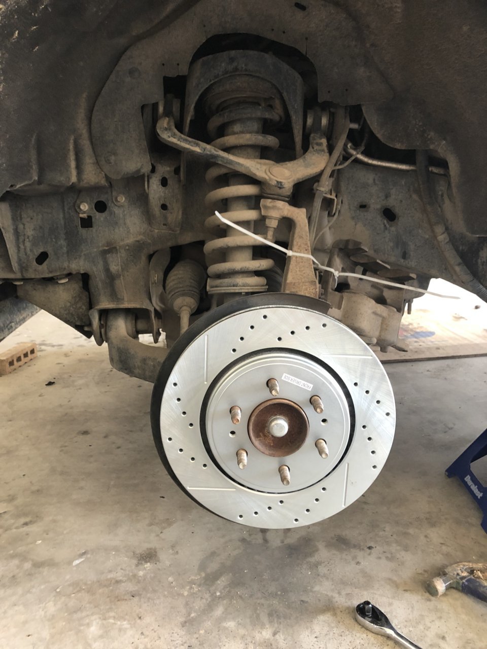

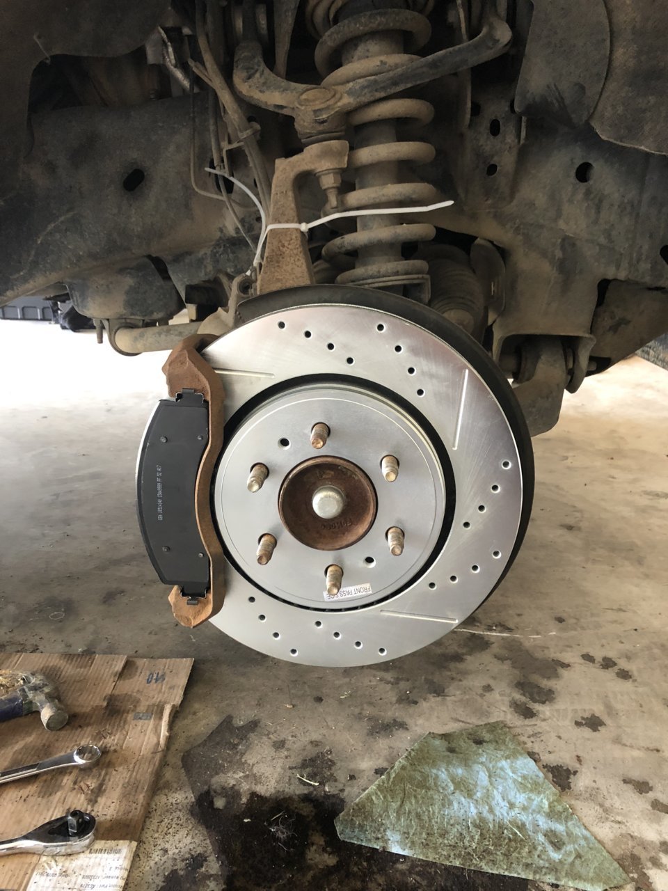

    Brakes done!
