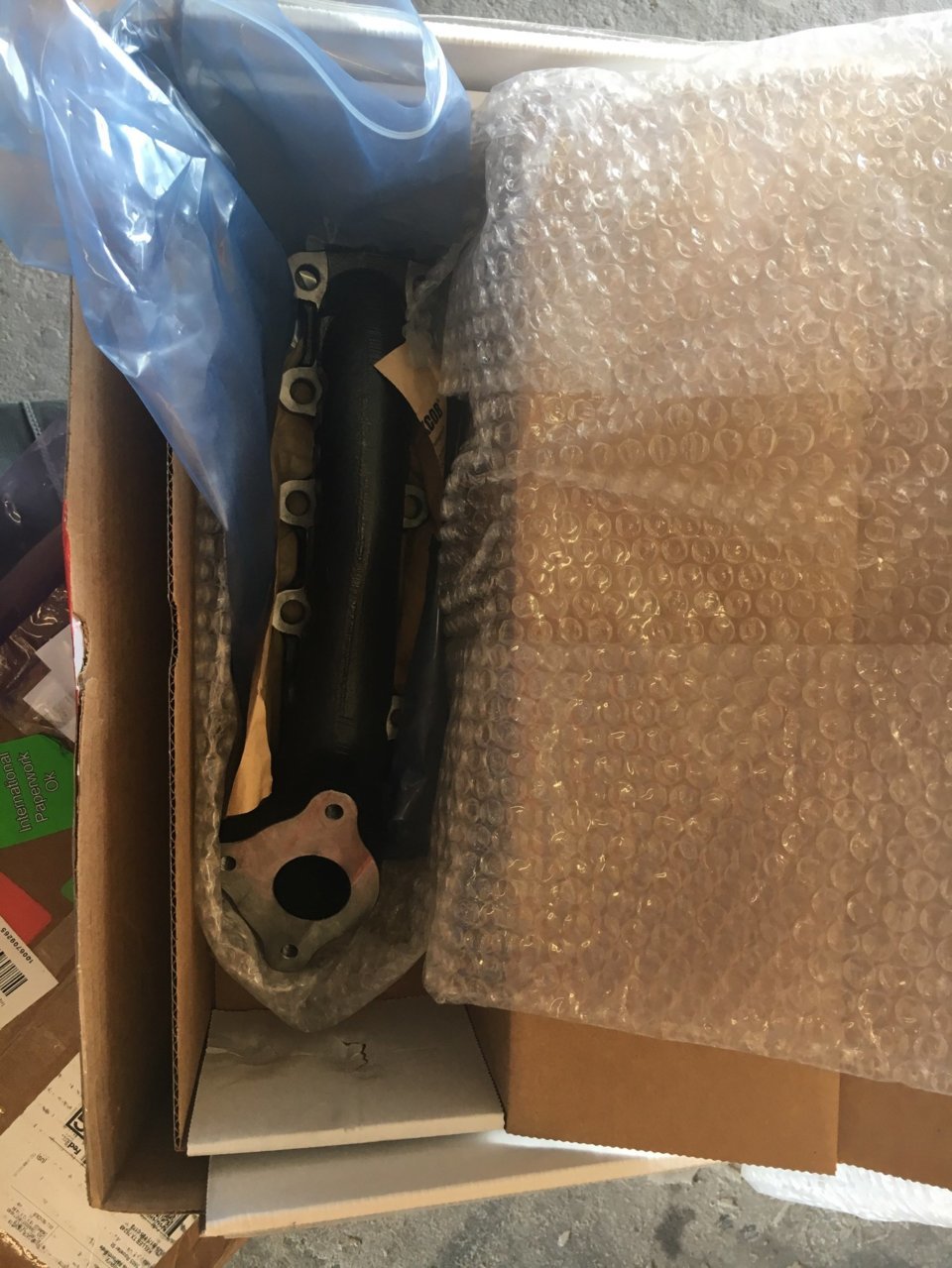

    My turbos are leaking coolant because of the rubber o-ring in the lines. It's normal and ford doesnt warranty them because they consider them wearable items. The turbos are pretty worn but healthy enough where I dont have smoke but bad enough to where my MPG has tanked. I'm happy to get 16 MPG's when I was getting 20+ a few months ago. Since I am changing the coolant lines, hardware and turbos might as well change the manifolds which are likely warped (Known issue with ecoboosts) and since all that is going down I am changing the intercooler and bov because the Full Race Turbos for 11-12 are nationally backordered with no time on when theyll be in stock so I need to reroute the plumping for a 13-14 which isnt hard to do. Oh and the downpipes because that thing needs to be able to fart with no restrictions :laugh:

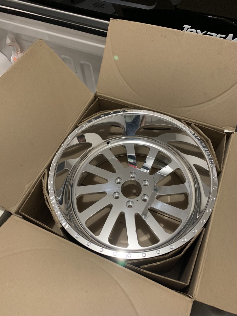

  18. Oct 5, 2018 at 2:16 PM
    #58
    Sleipnir
    Sleipnir [OP] Still havent found that stupid snipe
    Apr 28, 2016
    #185554
    10,511
    I'm a horse
    Asgard
    Furd Rangero Ecoboost

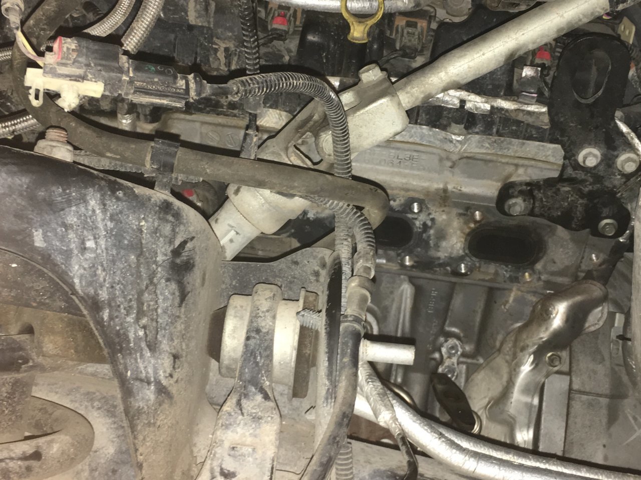

    Got these bad boys in today. Goes into the shop on Monday :sawzall:

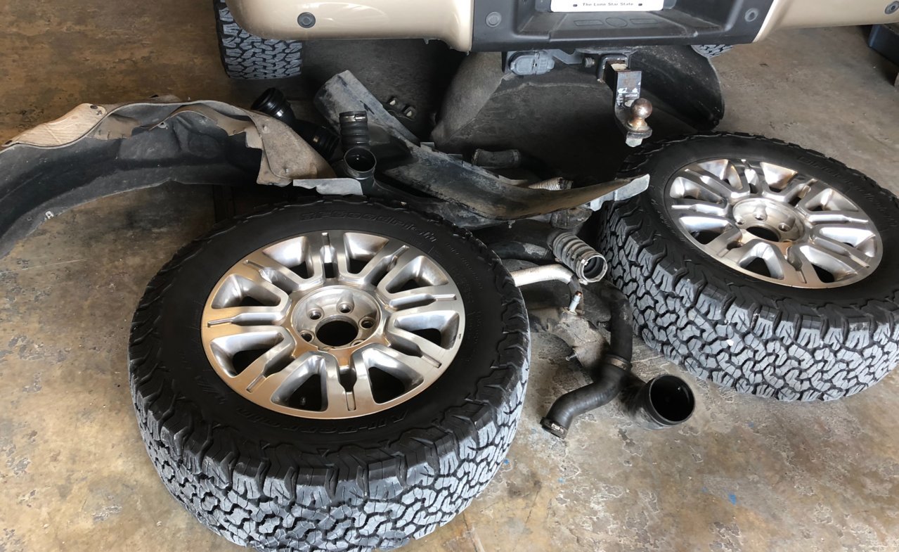

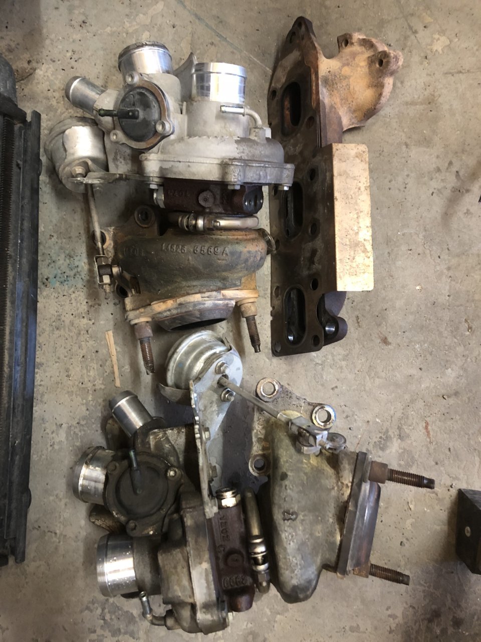

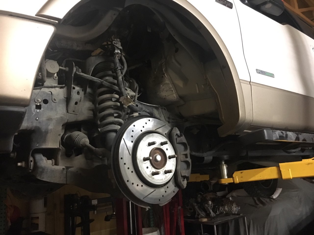

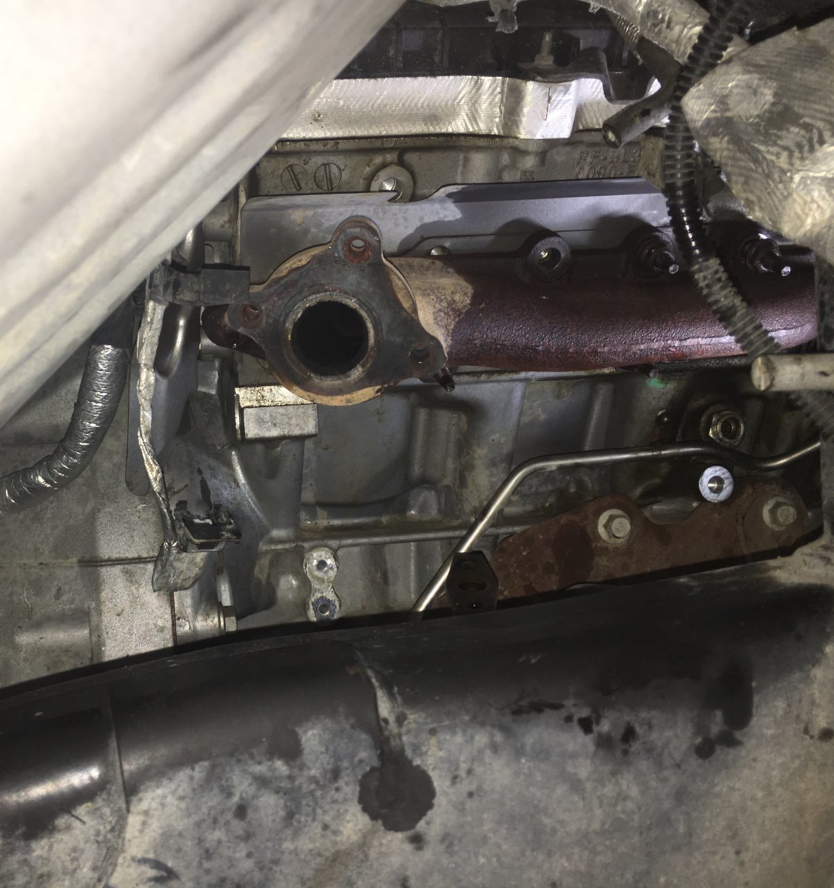

    The shop sent me these photos last night :bananadance: Tear down is complete and they are working on putting the new parts on today :D Ive been held up in a hotel in Ft Worth for the past couple days and should have the truck back and heading home tomorrow :headbang:

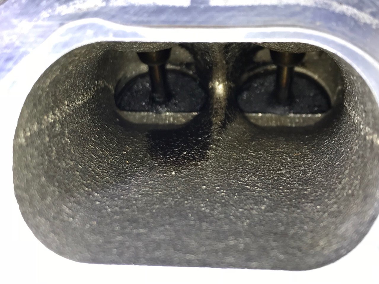

    Just got this image from the shop! They were going to walnut blast the intake valves but they said thats the cleanest valves theyve seen ever for a truck with 110,000! They think the motor or the heads were replaced under warranty by ford which is a plus for me :D :yes:
