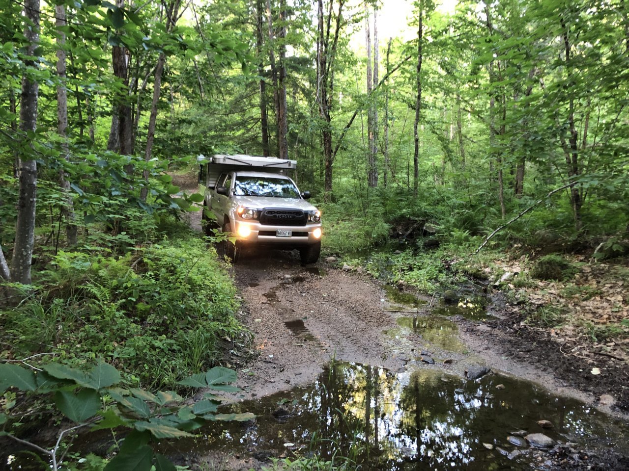

    Damn. That is one nice build you have there! Very impressed.

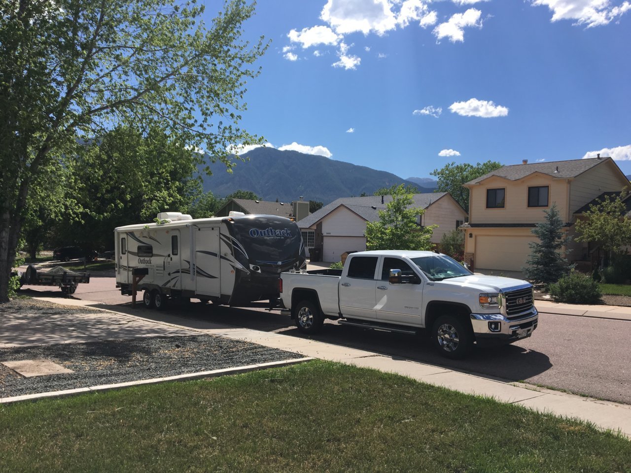

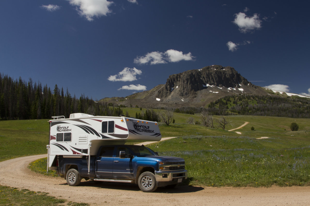

    Here is the problem with slide in campers:
    1) They either are way too heavy for a Tacoma and over time cause bed damage. Hell, even on HD trucks they can raise hell on them. I have owned one and will never again.
    2) If they are within a reasonable weight, there's not many amenities over a Wall Tent and cot and you still have to hang your ass off a log or use the strap method.

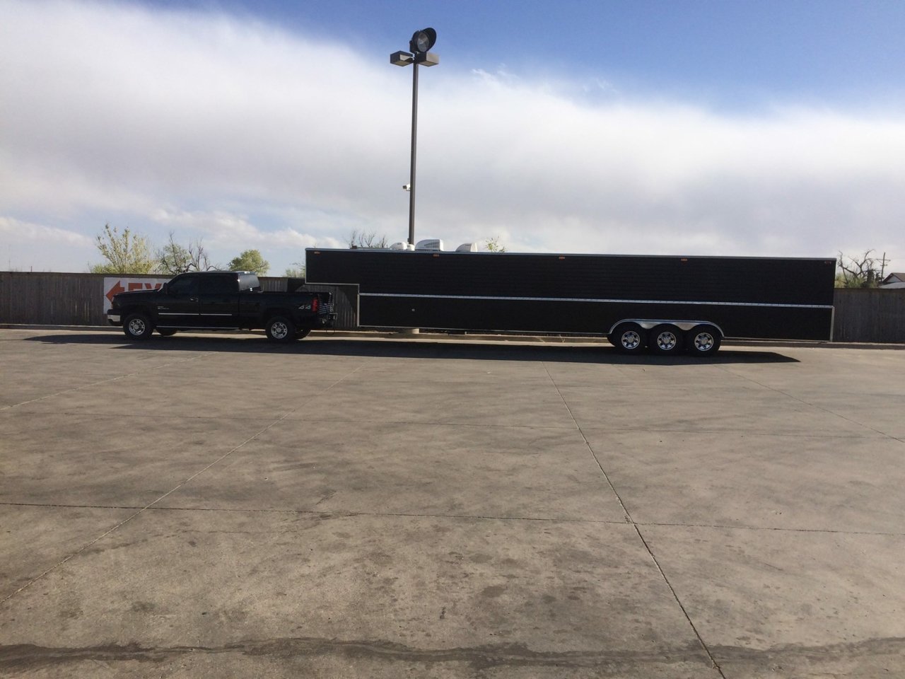

    Sucks getting older, but the guys I go wheeling with all moved up to HD trucks, GN trailers, and campers. What we would do is take turns on who would pull the 14-15K lbs on the gooseneck and someone else would pull the camper. The others would bring 55 gallon drums of water on their trailers for showers and cooking/cleaning. Worked out pretty good for many years.
    Some of them got a little carried away and towed crap like this with 3/4 tons....and had issues with tires blowing out.

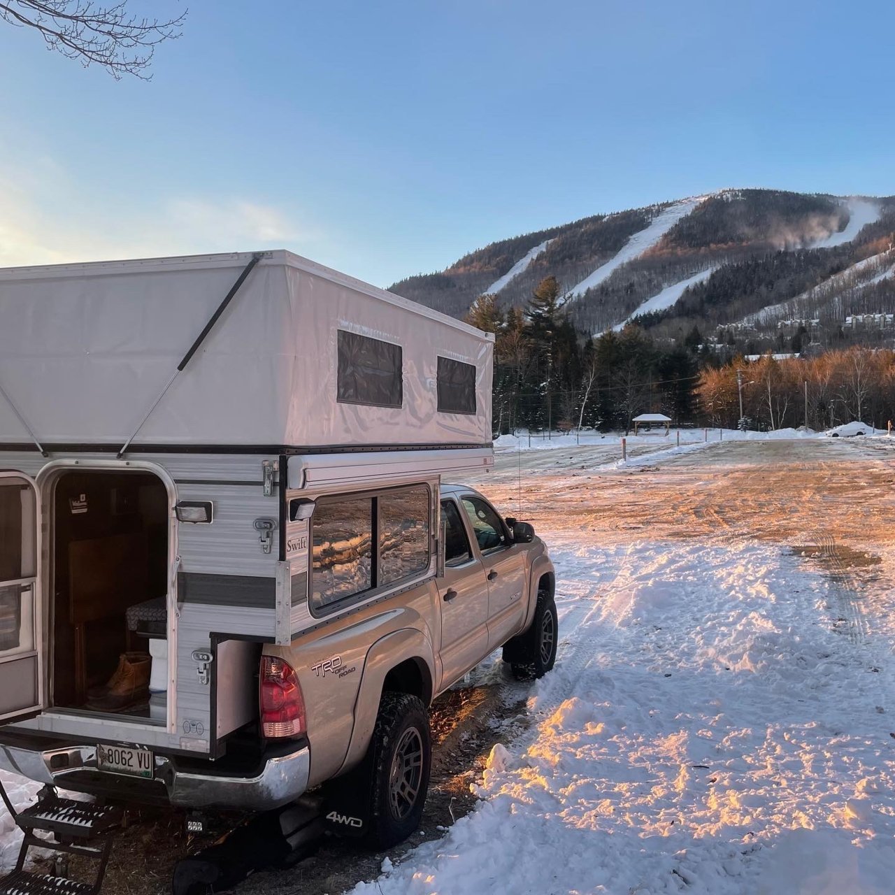

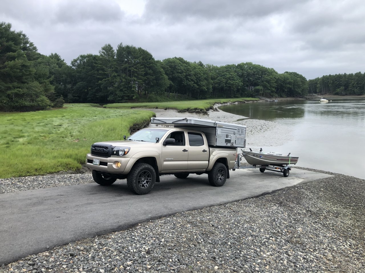

    I know I am in the minority but I personally don't take payload numbers too seriously especially if you are "within reason" and make appropriate supporting modifications. With our trucks we don't have many "good" options. You go utilitarian and get a Go fast camper that weights less than like 600 lbs. Or get a cream of the crop Four Wheel Camper which can weigh anywhere from 900 to 1300 realistically. Without getting into the weeds too much, I've been running a loaded Four wheel camper (has a cassette toilet) for a couple years now. Definitely not one of the affordable options, its expensive for the square footage! But that isn't why I have one. Its small and overlandy, and i love it. I did a HD leaf pack from Dobinsons to support the weight. Tried bags first but wanted to know i'd be alright if i popped a bag, so i did the whole leaf pack too. Many Tacoma/FWC people run just bags and get by just fine. Yes I could have bought a half ton and thrown the camper in without worry, but most of my half ton friends STILL had to do bags, hauling the same camper. So they're hardly better off than me. They just have more power to get around but the 4.0 does a decent job. I am at 4640 empty and 6220 loaded up with 35 gallons water, cooler, gear.

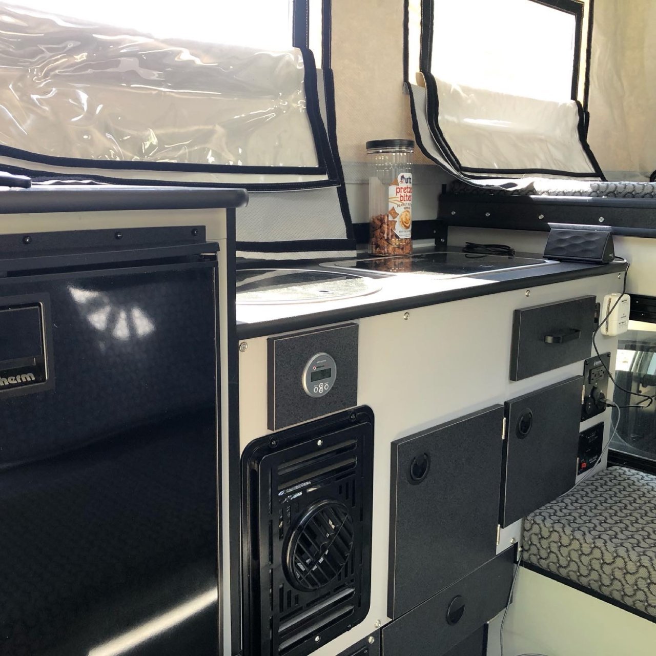

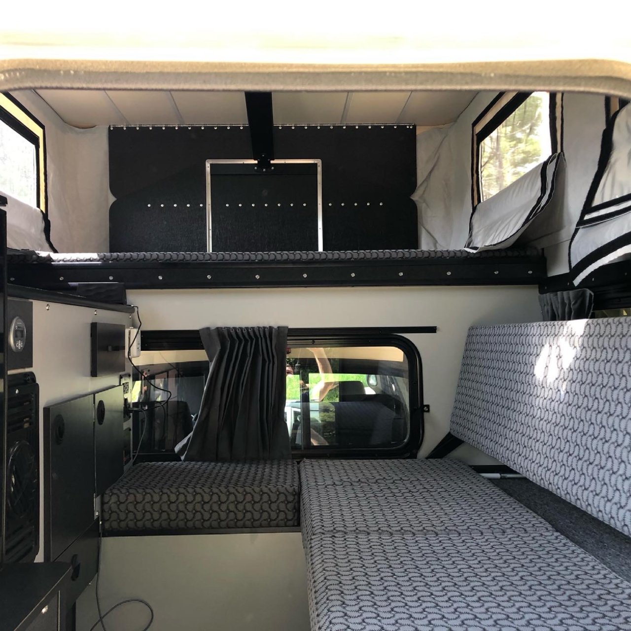

    Woh, this thing is awesome. Got pics of the inside? How much did it run you?
  7. Oct 19, 2022 at 5:09 AM
    Weissenheimer
    Weissenheimer Well-Known Member
    Feb 10, 2018
    #244004
    104
    Bryan
    Southern Maine
    05 TRD O/R (desert sand mica)
    FN FX wheels, Dobinsons suspension, air bags, other bells and whistles
    Like I said not cheap, 26k slightly used and that was before Covid destroyed the market and prices went up. They're hard to find used and buying new is a long wait. Its a commitment but I was convinced I had to at least try one so I went for it. These are the pics I have at the moment, my new phone with the fisheye would do a better job capturing the tiny space haha.

    GFC is less than 300 lbs, SP is like ~350. Wedge campers are in their own league compared to slide-in's when it comes to allowing the user to operate with the limited GVWR of mid-sized trucks. Half ton trucks as well, since most people configure their half-tons with crew cab short boxes and not single cabs nowadays.
    that 700-800 lb weight difference is massive. But you have to make sure to manage the weight on other mods, particularly armor by making an honest assessment of what you'll be doing with the truck. Eventually building out a rock crawler isnt compatible with building out a camper. Same dilemma as building out a track car that you drive on the street.

    Are those peanut butter pretzels?
    JackSparrah likes this.

    You might want to look at the FWC Project M, it’s the top half of what @Weissenheimer has without the bottom half so it attaches to bed like a normal camper shell so similar to a GFC but more room inside. Unfortunately you don’t get the stove, water heater or furnace because they normally mount in the bottom half - but that may be a plus for a do-it-yourself type person who wants to build what they want. Weights less and cost less than a full FWC and keeps your tailgate so you can still use your truck to haul what you could with a regular camper shell.
