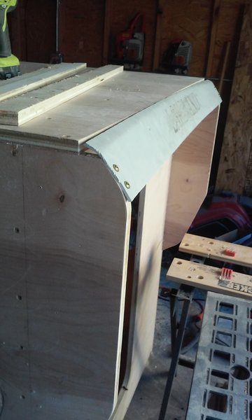

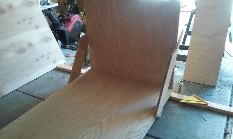

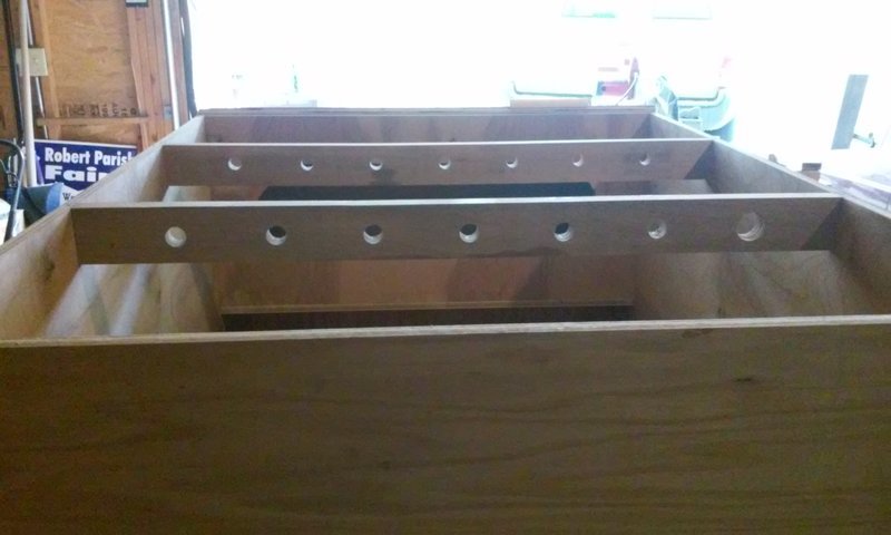

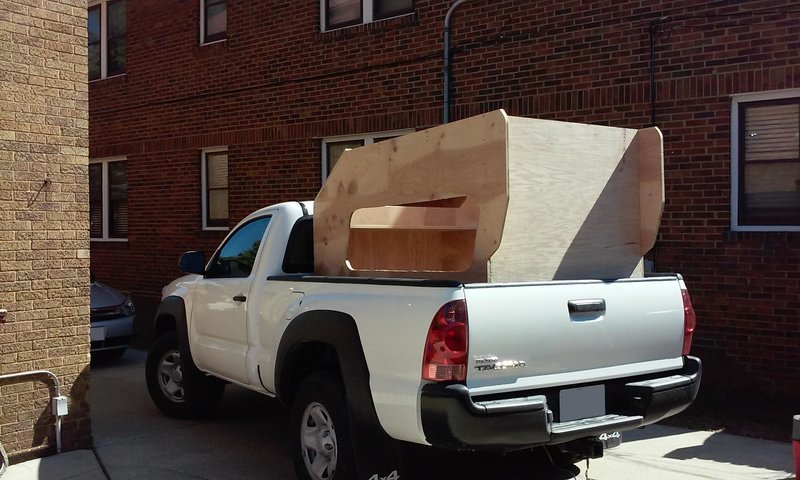

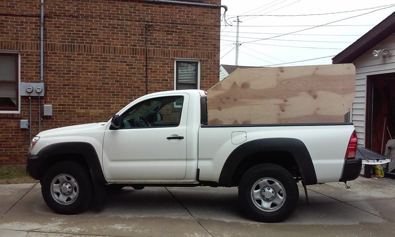

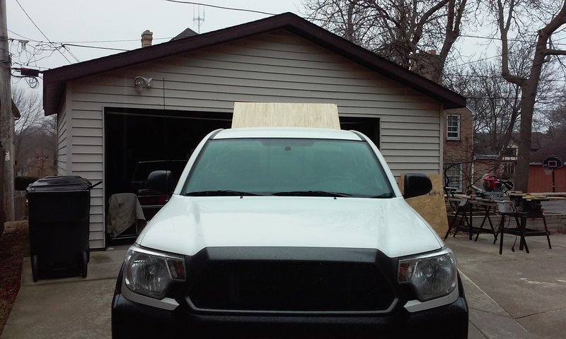

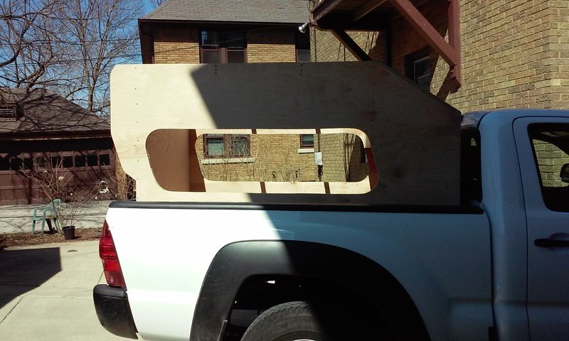

    I have been working at figuring out how I would like to build a weekend camping slide in truck camper. I have come to a settling point with this little project. Enjoy.
    0322161808.jpg 0326161128.jpg 0326161153.jpg 0326161231.jpg 0326161256.jpg 0326161256a.jpg 0326161429a.jpg 0326161447.jpg 0326161628a.jpg 0326161642.jpg 0326161702.jpg 0326161713.jpg 0326161805.jpg 0326161900.jpg 0327161255.jpg 0327161255a.jpg 0327161302a.jpg 0327161302c.jpg 0327161302d.jpg 0327161530.jpg

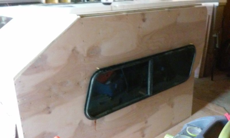

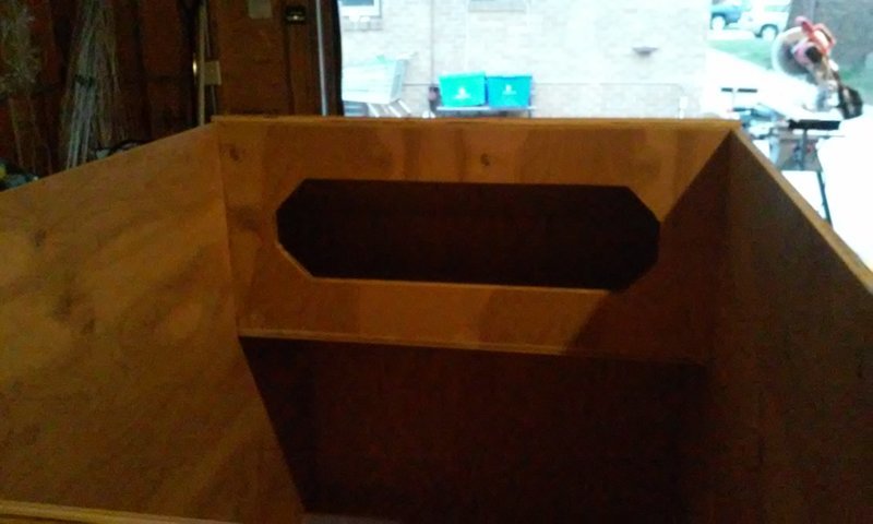

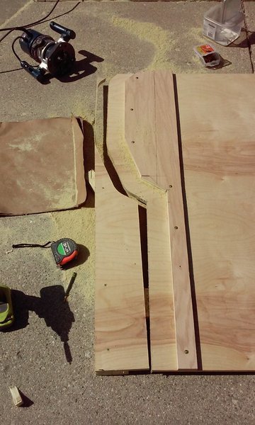

    0329161736.jpg 0329161737.jpg 0329161907.jpg 0329161907a.jpg 0329161907b.jpg 0329161907c.jpg

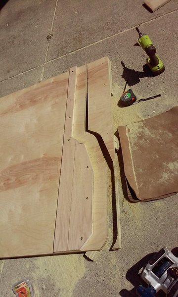

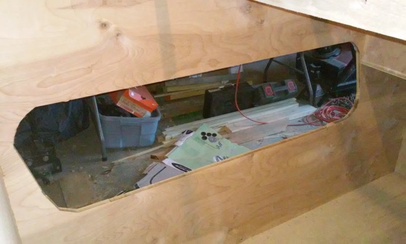

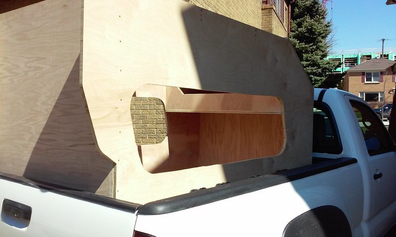

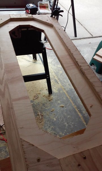

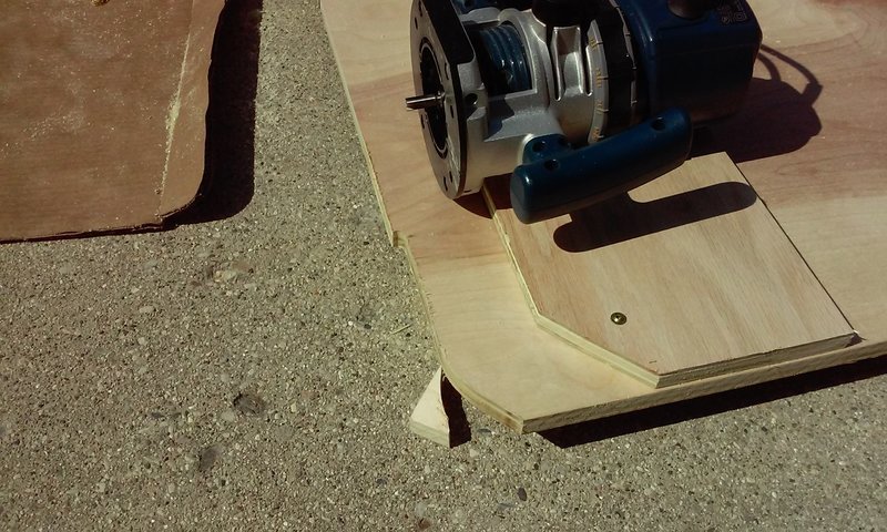

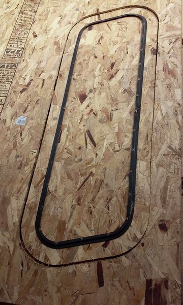

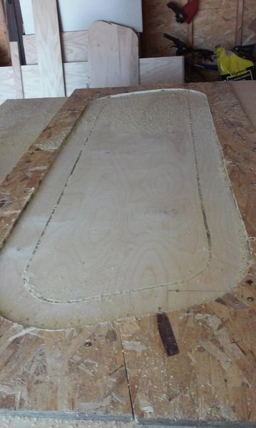

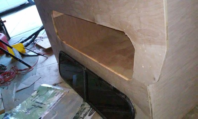

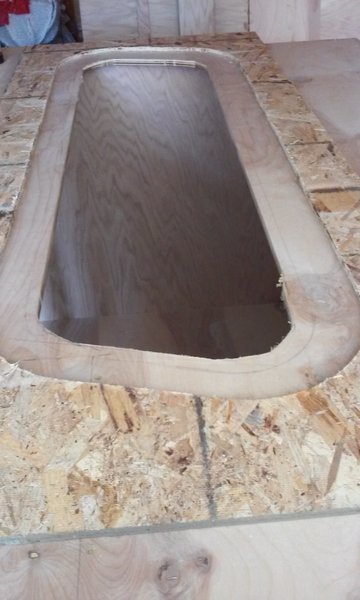

    Spent some time yesterday afternoon working with my router for the first window installation.

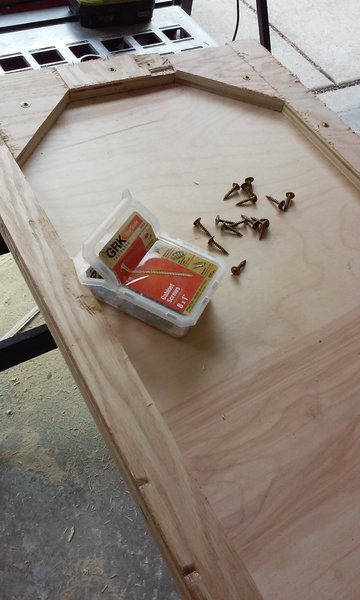

    5,242

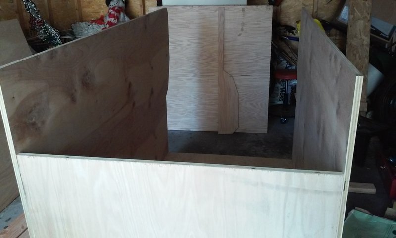

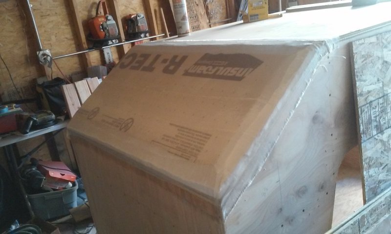

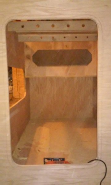

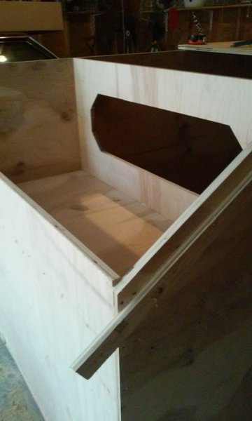

    0329161737a.jpgI was a little skeptical at first if this layout was going to work. I am very pleased on how it is turning out.

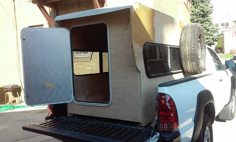

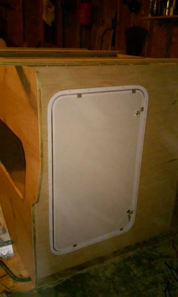

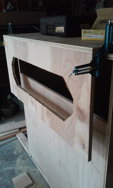

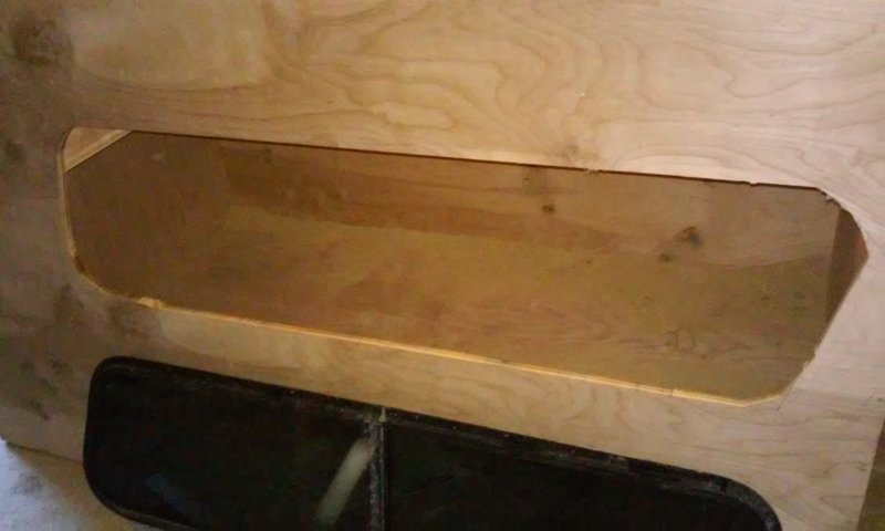

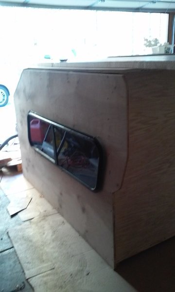

    0403161233.jpg 0403161258.jpg 0403161352.jpg 0403161406.jpg 0403161406a.jpg 0403161406b.jpg 0403161406c.jpg 0403161406d.jpg 0403161407.jpg 0403161407a.jpg 0405162204.jpg 0405162206a.jpg 0405162219.jpg 0405162226.jpg

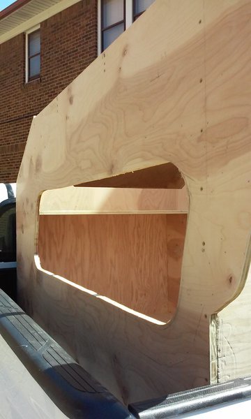

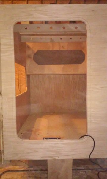

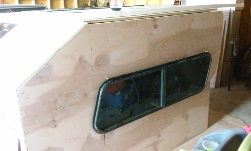

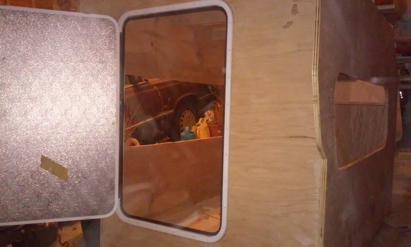

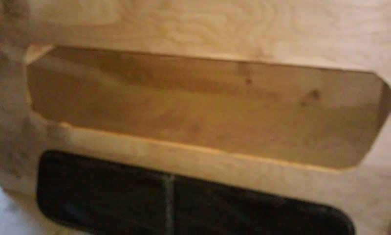

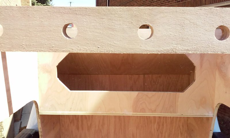

    Did a little more work on it this weekend and got in the other window and door. I broke my router in the process and it will need to be replace at some point, until then I finished the cuts with a jigsaw.

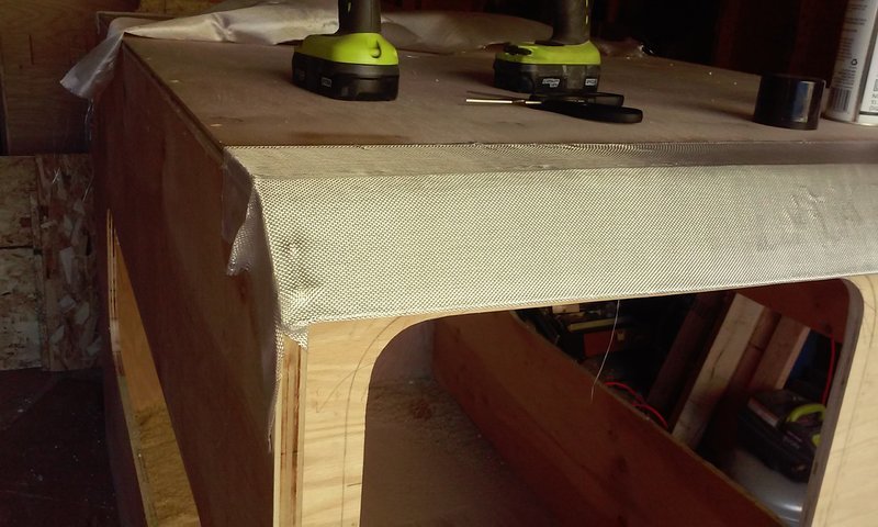

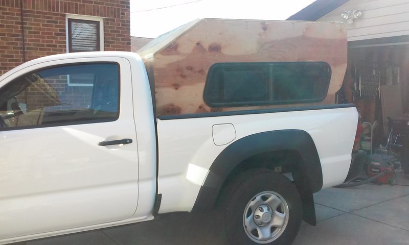

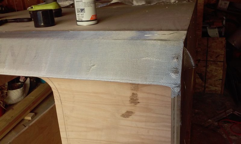

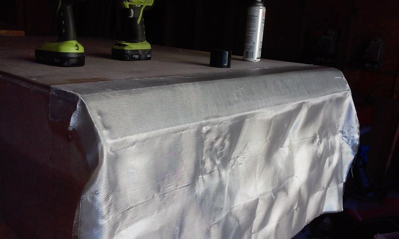

    Did some fiberglass work and started sealing the exterior with resin. Coming along very nicely.

    I have to ask though because I've been wanting to do something like this for a while. Why did you choose plywood rather than insulation to make your form since you are adding fiberglass anyway?

    If I were to make another I would probably go the insulation board route. I was not sure of my fiberglass skills and resin skills so I tried to keep it as minimal as possible.
    Yeah, I have a cost list going.
    Time is free, it has been a hobby this spring for a trip this summer.
    Weight is something I am fighting right now. Design and construction of a low cost leg or lifting system to lift ~275# right now.

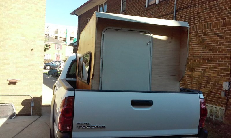

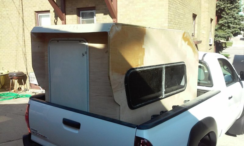

    #138654
    5,242

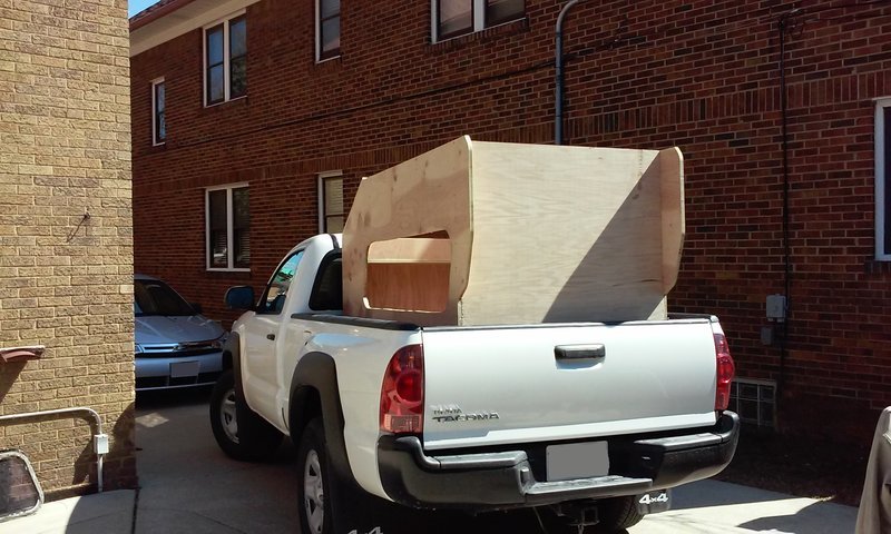

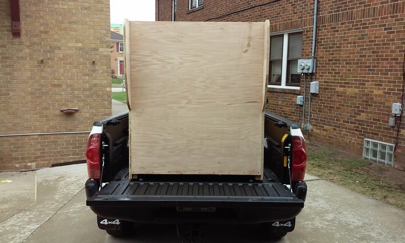

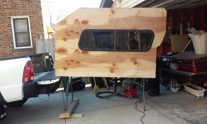

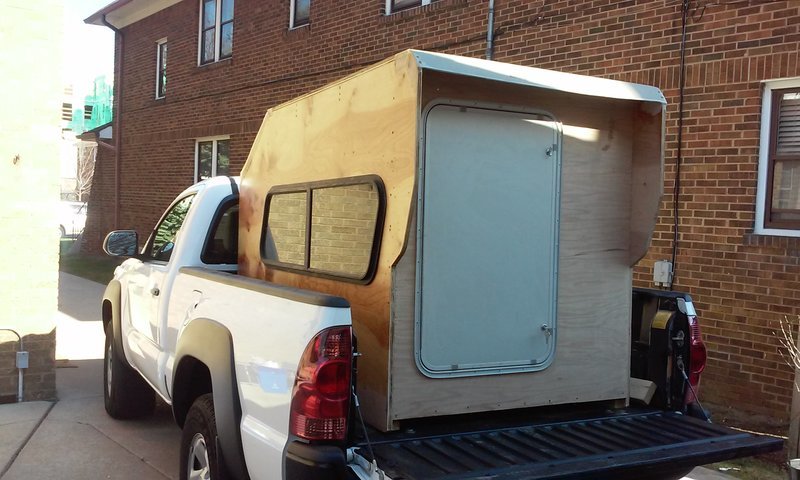

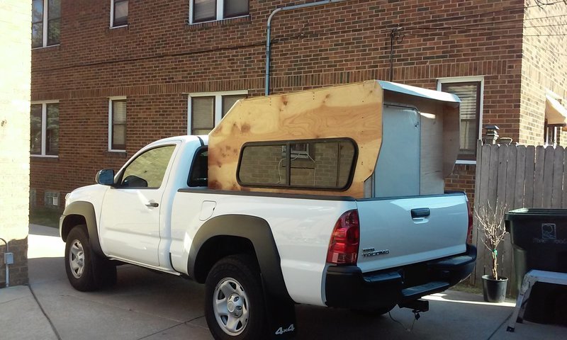

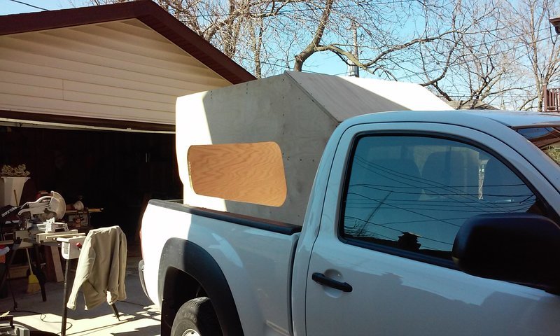

    It was a busy weekend, after work yesterday I test fit windows, door, and how it looked on the truck. I am not sure on if I mount spare tires up on the bed rail for a Safari look. Opinions?

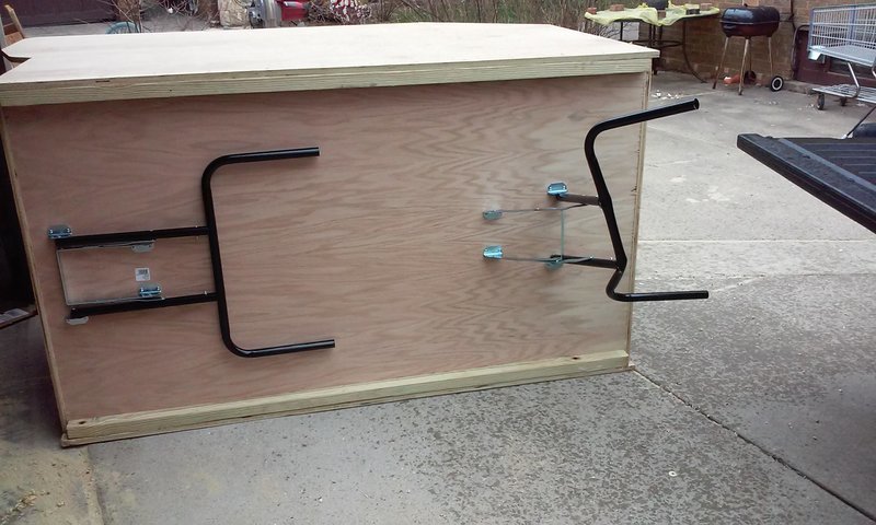

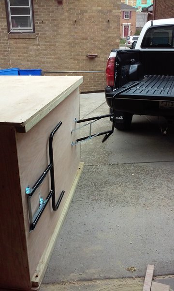

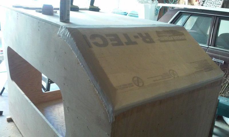

    I inverted the box and started coating the base with Resin. I also started staining the interior. I have consumed a lot more resin than originally anticipated and I am now looking for marine resin primer. I think I will forego gelcoat as originally planned for brush on enamel paint, as you all know the primer is just as important as the paint.
    I am also getting tired of lifting it in and out of the bed of the truck. It is not fun and very cumbersome, I already had (1) catastrophe where it tipped over and broke the legs. I may consider a small trailer idea as an alternative.

    I'm curious why you decided to not have the camper span over the bed rails to make it a bit wider at the top
  19. May 10, 2016 at 9:19 PM
    #19
    Toyko Joe
    Toyko Joe [OP] Here for the pictures
    Sep 19, 2014
    #138654
    5,242
    Honestly, @OZ-T I have asked myself this many of times. It came down to space available to construct it. I have really considered trashing the whole thing and starting again. I was actually just looking at different layouts in CADD drawings I have as a scratch pad. I am about 15% away from trashing the idea and going for a teardrop.
    My first idea was with aluminum tube frame and SIP style insulation board between veneer (interior) and aluminum or painted wood (exterior). I may go back to this idea. I would be lighter and allow for more space.
    My trip was postponed until September so I have a little more time for construction.
