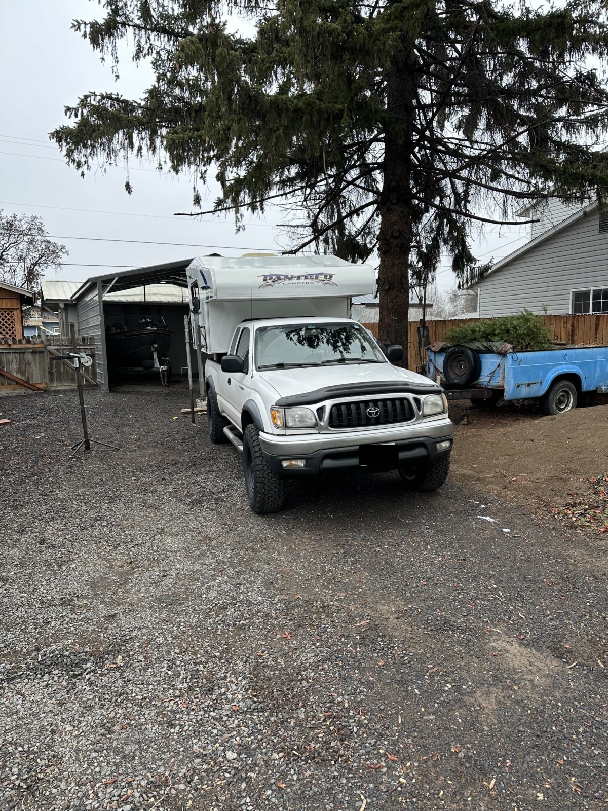

    Hey Everyone - long time reader, but my first time posting here.
    There's lots of opinions out there on slide in campers in 1st Gens, especially relating to weight and payload/GVWR capacity. Definitely understand the concern there, however I have finally found a long-sought after and (relatively) rare 2007 Panther Cheetah camper from Best Built Inc, out of Kalama. Definitely a bare-bones style of camper (love this), and it's reflected in the base weight of 620lb. (I have not gone to a truck scale to confirm this - planning to do this soon)
    I have a 2004 Extra cab, 3.4L, with the 5 speed manual transmission. Considering an max weight of 340 lbs of people, 400 lbs of gear/100 lbs fuel (max), I would still come in under max payload capacity of 1,560 lbs. I have ride-rite airbags installed, E-load rated tires, add-a leafs, bilstein 5100's, and I'm planning to install torklift tie downs.
    The camper fits perfectly in the truck bed, as far as footprint is concerned, but it sits a ~7" high off the bed rails and above the cab. (see photos)
    Additionally, I'm going to try to build a wind deflector/acrylic plastic box that fills some of the gap over the cab. (if anyone has experience with something similar, I'd love to hear what you did)
    - Does anyone have experience with slide in campers that sit a higher off the bed rail?
    - If you have had a slide in camper, how has your 1st gen travel experience been?
    - Do the torklift tie downs really help that much?
    Thanks in advance!

    Sweet setup! How much air do you have in the bags when the pictures were taken? The room above the cab may be a good place to put some pelican cases.

    Those photos were taken pre-airbags, actually. I've taken it out on pretty mellow roads, and around town (speed bumps, cornering, Portland's low quality pavement) at 50psi, and it seemed to be fine. Granted, there's nothing inside at the moment and there wasn't much side-to-side action.

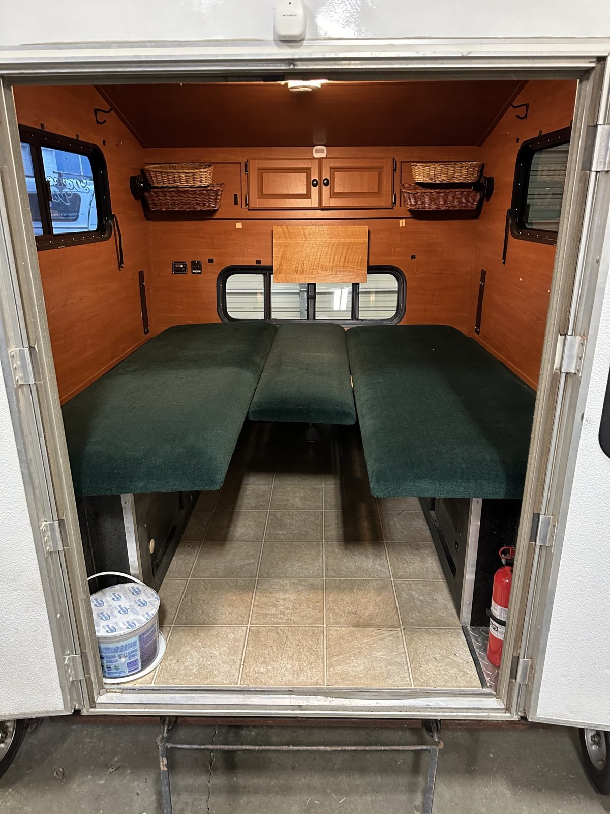

    I'll take some inside pics this week and post. It's very similar to @Shape-Shifter rig - same wood paneling, green carpet, two fold down bench beds that can be converted into an entire cabin bed. I'm going to do some modifications and move them to one side with a slider (kinda like a futon folds down) and then add fridge, sink, heater, etc on one side, and a battery compartment on the other. Not wanting to take up any of the center space yet I like having the option to carry things like dirt bikes, kayaks, skis etc in the space inside.
    Also - I'm gonna go to the truck scales and see if it actually comes in at the 610lb stated dry weight.
    @hucklebarry, good idea on the pelican cases. I was thinking of building a lightweight storage box underneath - but getting a cage for the truck cab roof would probably be much easier and lighter-weight. I've already got a plastic fairing being cut that will connect to a yakima cross bar.

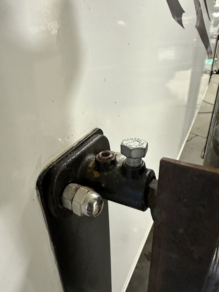

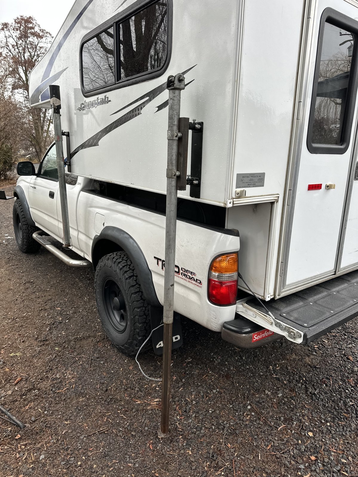

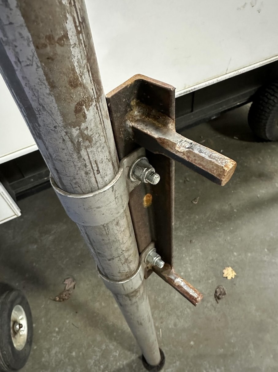

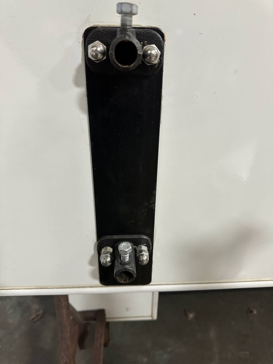

    I am guessing you built those jack mount's, they look stronger than commercial offerings. can you tell us about them?

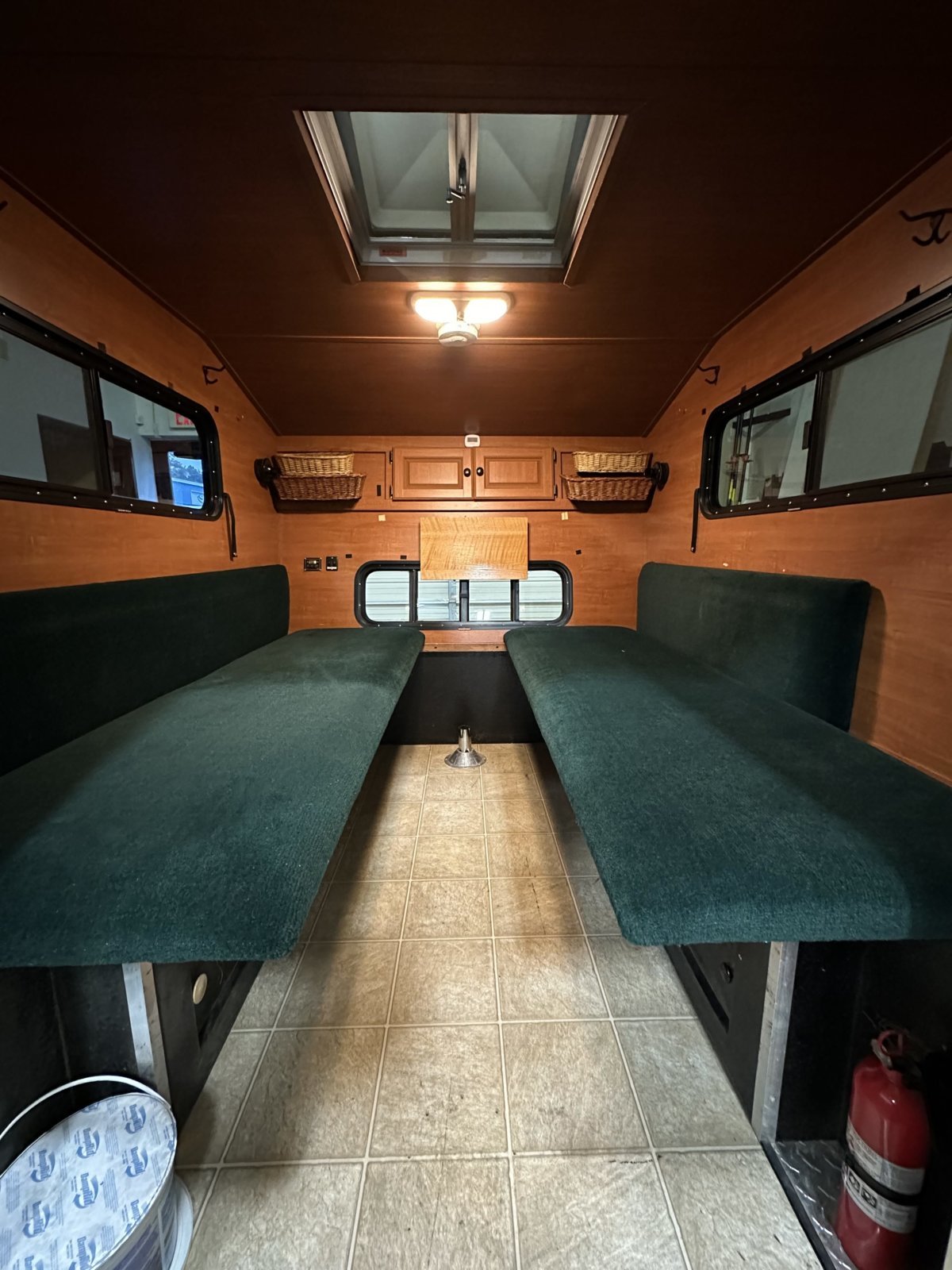

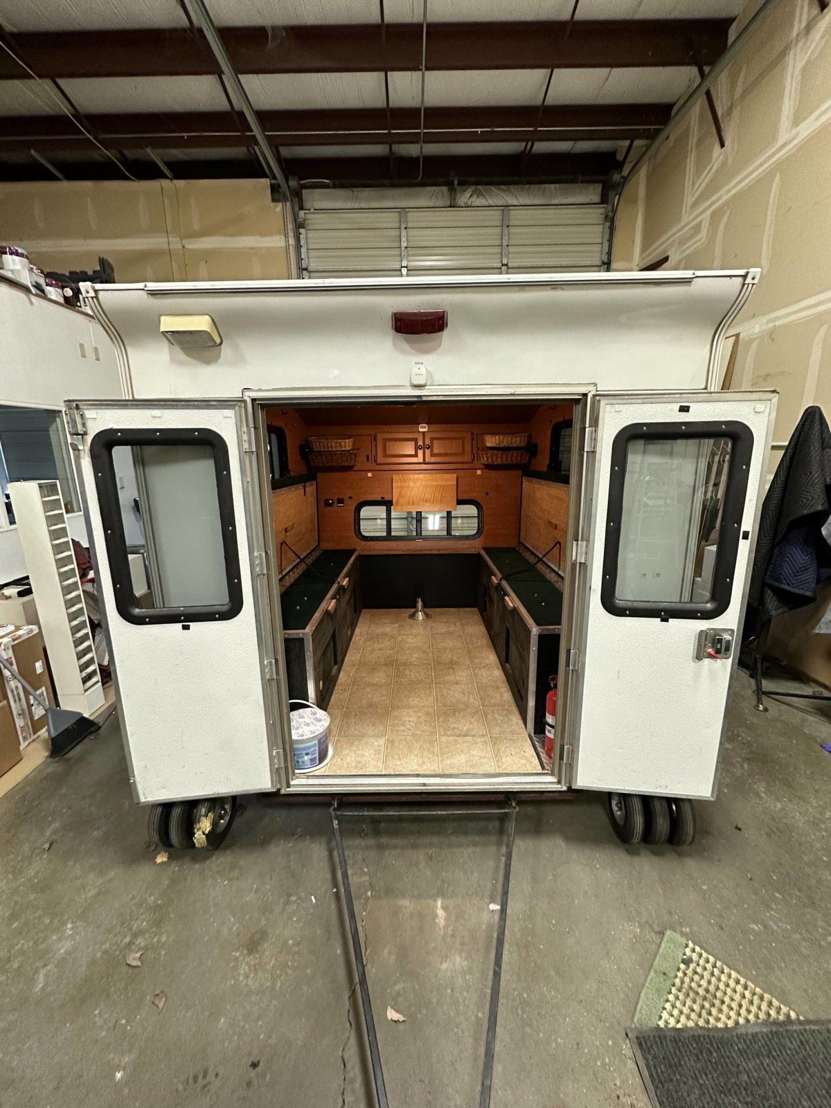

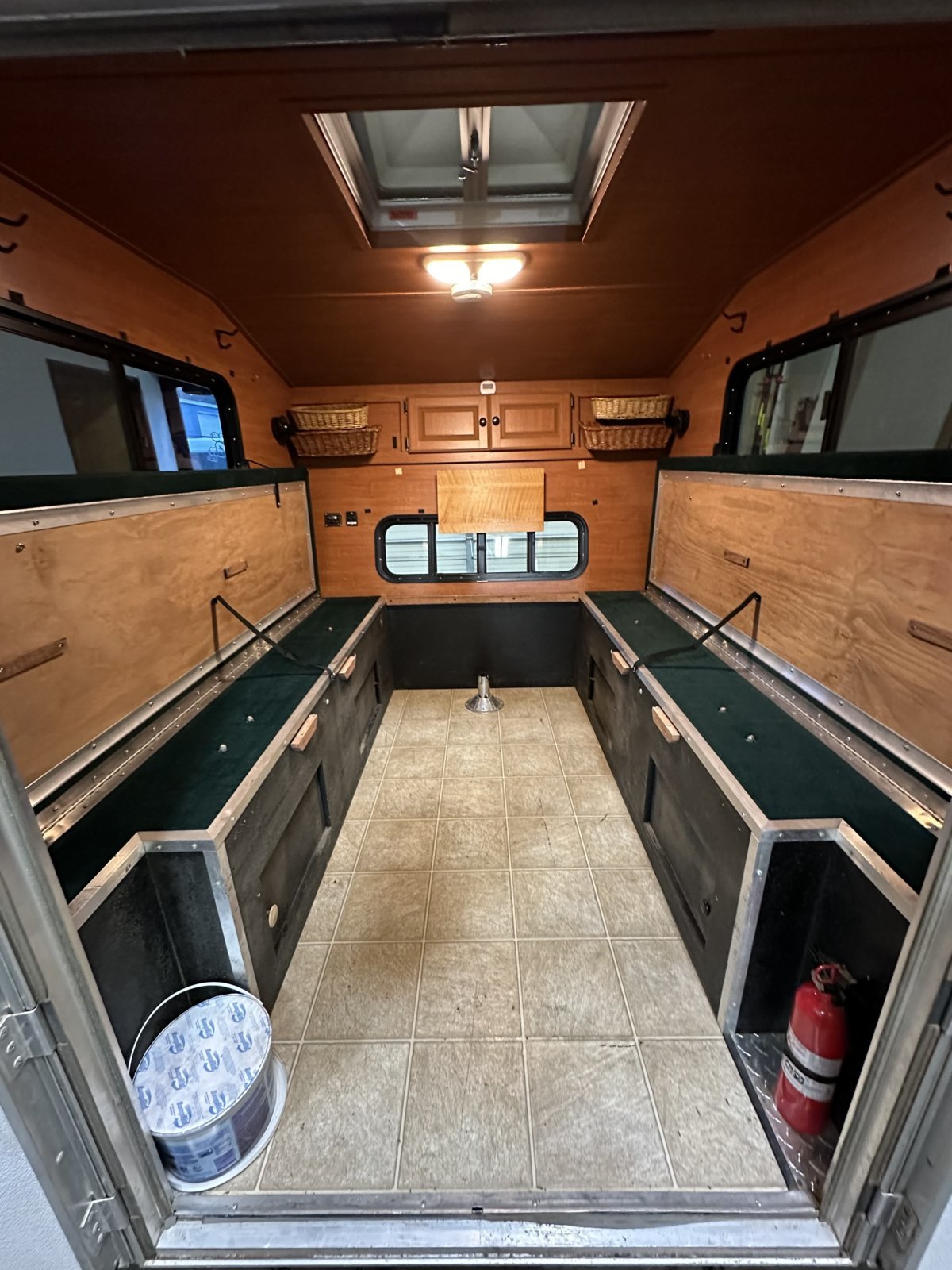

    Some photos of the inside of the camper - I've done nothing to update/change it at this point.

    The jack mounts are just small flanges mounted through the wall of the camper with a metal plate backing on both sides. The attachments to the jack are angle welded with a small post (to insert into the flange). Nothing fancy, but they seem to hold alright. I have hydraulic jacks on the front, mechanical on the rear. Its kind of a pain to raise and lower, but hopefully it's not something I'm doing too often, otherwise I'll want to come up with a better system.
