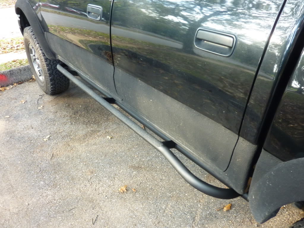

    It seems most sliders use a round tube and angle up about 20 degrees:

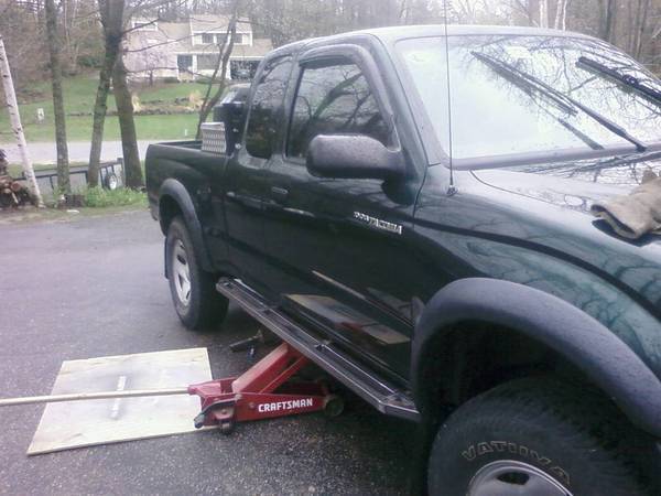

    I saw a custom slider that Green01 built that are square all the way:
    I like that the square ones act as a better (more stable) step and also that they are a little different than the crowd. They would take a hit a little better too becuase the corners bring stability (like a dimple dye). Tubes will crush easier.
    Functionally, the round ones won't get hung up on a rock as easily. The corners of the square "could" bind up a little on a rock edge.
    What are your thoughts? Any other reasons to go round vs. square?

    I don't really think there is an advantage to either. it is whatever you like. I built square tube ones for my truck because i don't have a tube bender. mine angle up roughly 20 degrees to sit just below the door like the round ones you show. with square you can still have kick outs too.

    Hybrid round outers and square runners. Full square sliders look cheap and home made IMO but that's me.
    My sliders are the Hybrid design I think it's the best of both worlds nice clean bent tube on the outer rail and strong square tube on the inner rail.

    Home made is bad!? I would like to step back from my truck with pride and say "I BUILT that," much more than "I Bought that" IMO but that's me.
    The square sliders in the pic above might look cheap but he is probably just measuring it up to the truck. And he has enough saved for...whatever. A great paint job and they would look awesome. And welding that looks that good is not that easy. I give props to the guy.
    As far as functionality. Square would be a bit stronger, but really there is such a small difference that shouldn't sway you one way or another. Cylinders are better for compression along its rotating axis. Think crushing a pop can by stepping on it straight up and down. But denting the side of the can is much easier, think squeezing with your thumb. So, as you drag your truck along the sliders, you will dent the round ones more. But you can make up for the weakness with thicker bars, or just use square bars which have ridged corners due to larger cross sections on the corners. I would agree, I like the look of round better and that might sway my choice. But I would definitely still make it myself just for the satisfaction of my handiwork.

    Okay...i got butt hurt seeing someone call square sliders cheap and homemade cause i have cheap(material wise) home made ones. Not saying my dick is big because I can weld...it is actually quite average...I shoulda gotten a duramax with 10 inch lift, would have bumped the size up. :rolleyes:
    Anyways you have a valid point about a butt welds weakening the metal. But this is on a 3,500# truck, not for any sort of industrial purpose. You are the professional welder so you know much more about it then me. But i would think that using square tube and constructing them properly is building them right. does the fact that the outer rail is square tube and butt welded to the inner rail take that much away from the strength?
    I would really like to have a tube bender but I don't think i actually need it for anything I want to do to my truck yet. so I don't see it as a necessary tool. I like the look of square tube and plate more then tube bumpers and that's just my preference

    Round sliders allow the vehicle to slide off an object more than the square ones do. Square sliders tend to "hold on" to an object.

    Hybrid. Round tube sliders don't have enough rigidity for truly hard use. I've seen too many dented sets. Square legs mounting to the frame also give you greater rigidity and less deflection when the slider is under load.
