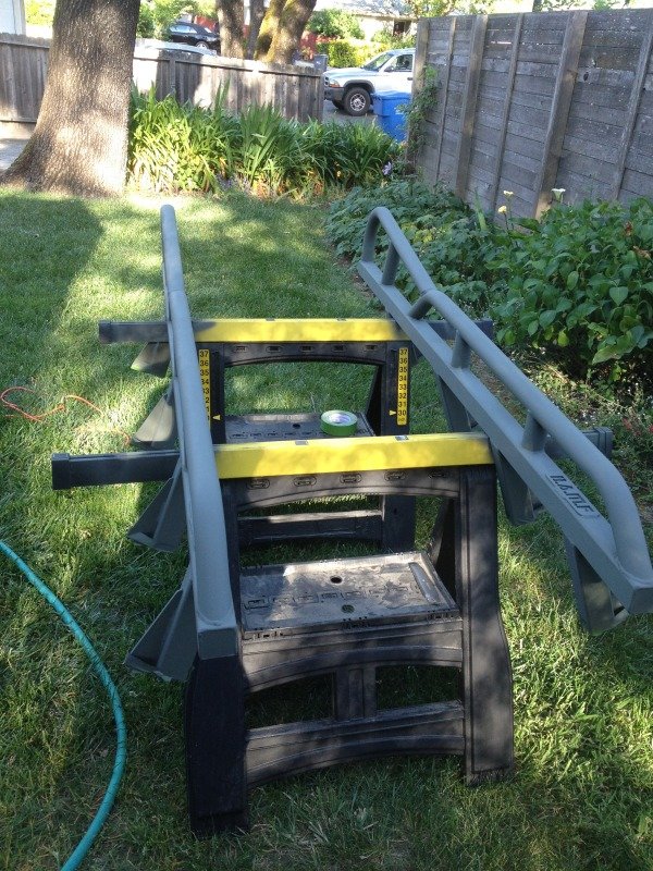

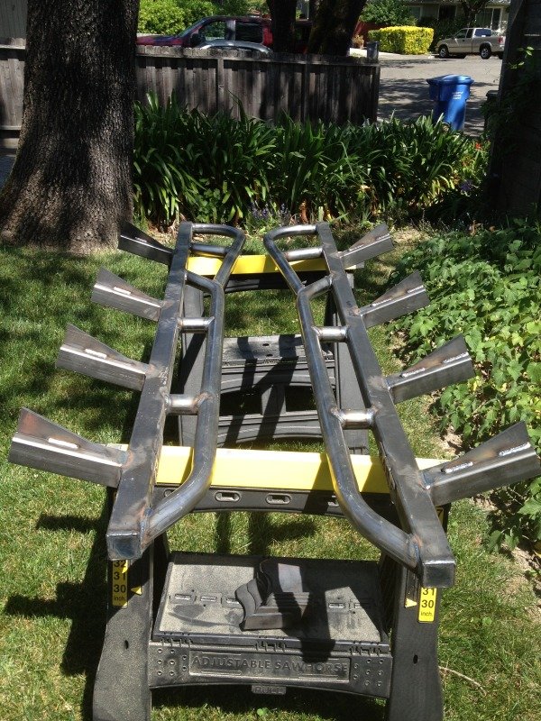

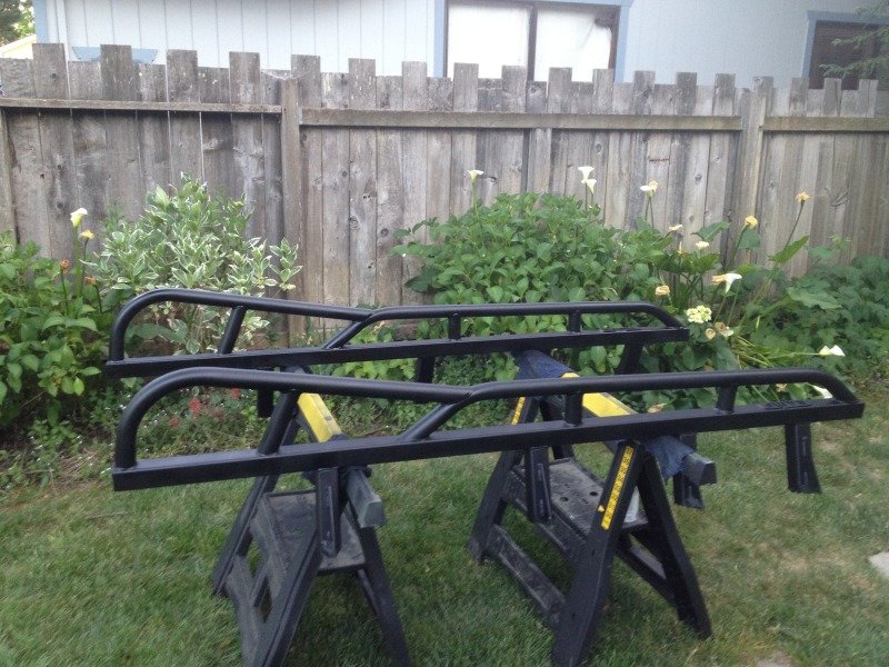

    3 solid coats of self etching primer, followed by 3 solid coats of Bedliner. Tough enough for mall crawling, rust-free and easy to touch up. Problem with PC is that if you ever DO use your sliders for their intended purpose, it'll scratch right off just like any paint/bedliner etc.
    Here's mine before install. No problems yet. (minor trail use... no salty east coast roads...)
    bare
    primed
    'Liner'ed
